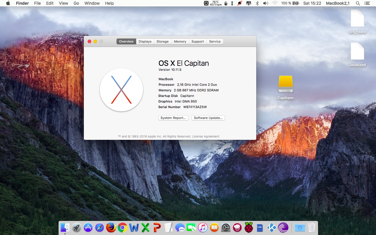

I finally have El Capitan running on my old EFI32 2007 MacBook 2,1.

EL CAPITAN IS FINALLY FULLY WORKING INTO AN UNSUPPORTED MACBOOK 2,1
Solved the sound/bluetooth/GMA950 issues!
Updated Post #502: TUTORIAL - FINAL VERSION.
