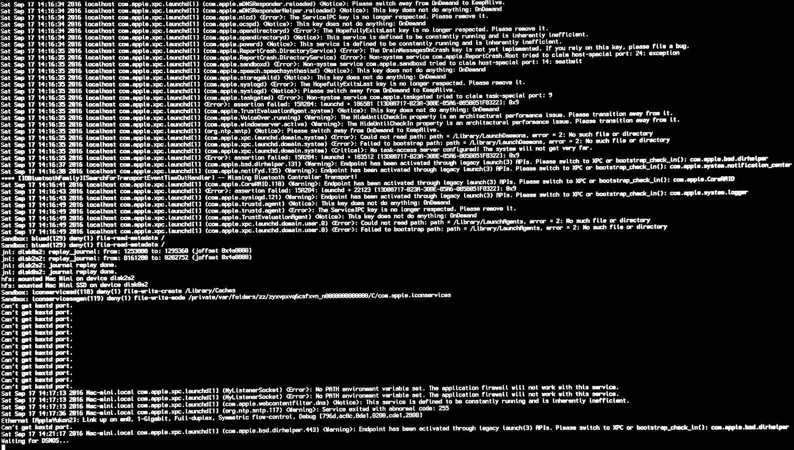

I try to copy the boot.efi into Recovery partition and after reboot, I start Mac Mini into this partition, but when boot arrives into the message "Waiting for DSMOS", boot stopped. Any idea?
