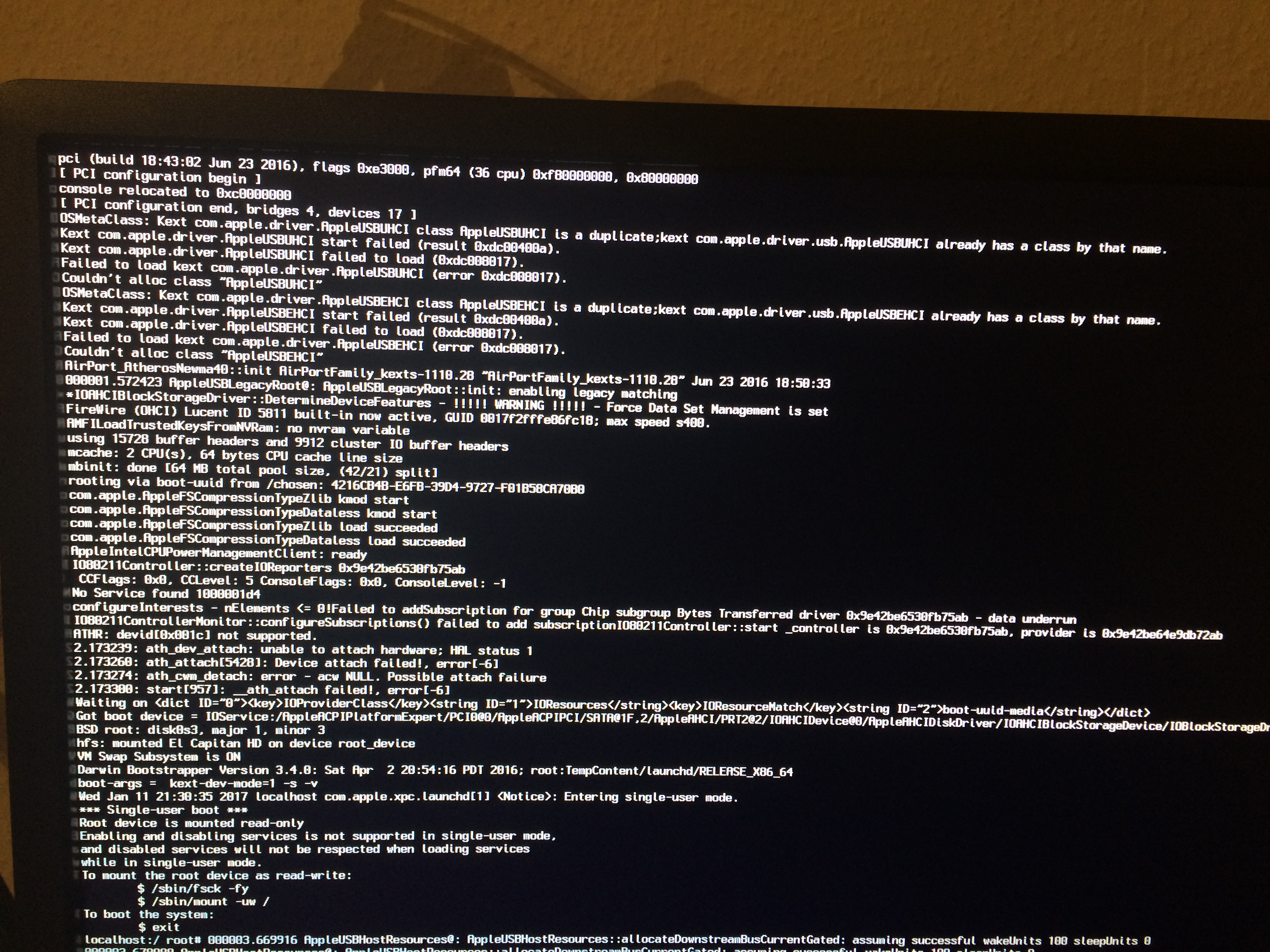

The problem is caused by lack of USB support after the update. My ElCapitan was running on an external USB drive. The update removed the USB support KEXT. When I went to reboot, this caused the 'PROHIBITED SIGN'.
So I moved the drive internally, which allows it to boot. Unfortunately, once it reaches the login, there is no keyboard/mouse, since these require working USB to function on a MacBook 2,1. Booting into single-user mode is same problem, not keyboard/mouse.
On a positive note, I used your BOOT.EFI in the recovery partition, and it actually booted correctly. However, again no keyboard/mouse. Plugging in an external USB is same. I really would like to fix this so only one computer is required.
Have you replaced the USB-Kexts again after the Update to Version 10.11.6 ?
It's very likely that the 10.11.6-Update has overwritten the patched USB-Kexts with the Apple Standard-versions.

I replaced all the Kexts in the internal ElCap HDD manually while booted from Yosemite (now in external USB enclosure).
my issue now is that rebuilding permissions and kextcaches from in Yosemite to the EC doesn't fix it.
A solution might be to force EC to rebuild everything on next reboot, but not certain how to force it to do this. Any ideas? I think we are nearly there...
Maybe I have asked already. Have you tried to boot into text based single user mode? There with touch S/L/E and kextcache -u commands you can rebuild the prelinked kernel. After with exit you can continue to boot into graphical part
Thanks for replying. I did boot into the EC single-user mode, but there wasn't any keyboard support, so I wasn't able to execute any commands. I also tried adding a launch-daemon script to the recovery partition, but that also didn't work.
There are several other methods I will try later today (I think these are based on posts several months ago here by Fred57):

I tried to update to 10.11.6 and has failed.. no mouse at login screen. Neither when booting to recovery partition. When I start to single user, there are visibly error messages saying that USB drivers were not loaded due to some naming issues.i don't remember such messages from previous versions
I will try to move back to to 10.11.5 I am afraid :-(
[doublepost=1484168743][/doublepost]See the photo of the boot screen when booting to single user

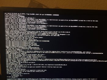

Mine had similar issues. For 10.11.6, using Ver.3 of the USB Fix from here (http://www.insanelymac.com/forum/files/file/521-usb-fix-for-el-capitan/) made it work again on MacBook 2,1. I think these are just revised versions of the same kexts SkyFly555 used.
