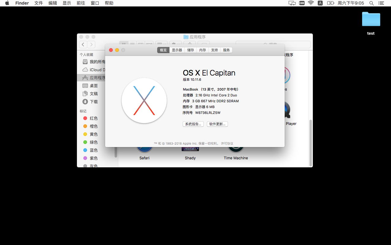

succeed with method#3,but dock missed
cloned from a mid 2013 macbook air
gma driver?
gma driver?
Good work. Odd that you are also missing the background wallpaper image. Was it always like that or did you remove it?
I did not have a supported Mac to clone from, so mine came from a temporarily Hacintoshed ASUS UX305FA. Dock and background image were both present and continue to be there...
gma driver?
Probably. The Graphics-RAM size should normally be 64MB if the Intel GMA 950 Kexts are fully working.
In OSX 10.10 Yosemite it was a clear sign for working Graphics Kexts if the ATI X1600 shows 128MB/256MB or the Intel GMA X3100 144MB. But as far I've seen it in the OSX 10.10 Yosemite-Thread the Intel GMA 950 seems to be a different thing and it shows only 10 MB Graphics-RAM size there.
My MacBook 2,1 with GMA950 running ElCapitan also says only 6MB Graphics-RAM, but in fact it runs very well. It plays 720p YouTube full screen without stuttering. I estimate it achieves 70-80% of the video performance capable when running supported on SnowLeopard 32-bit.
You can install the GMA 950 Kexts using macOS Extractor to get its full 144MB Graphics RAM in use.
Isn't MacBook GMA950 only 64MB ? I tried lots of different video Kexts, the ones that feel most smooth in fact only indicate 6MB on the System Report. Any chance that system report is not accurate?
It is 64MB. I was thinking of the MacBook 4,1. My bad. It would be unlikely that the system report is not accurate but if you are happy with the performance, then hooray!
