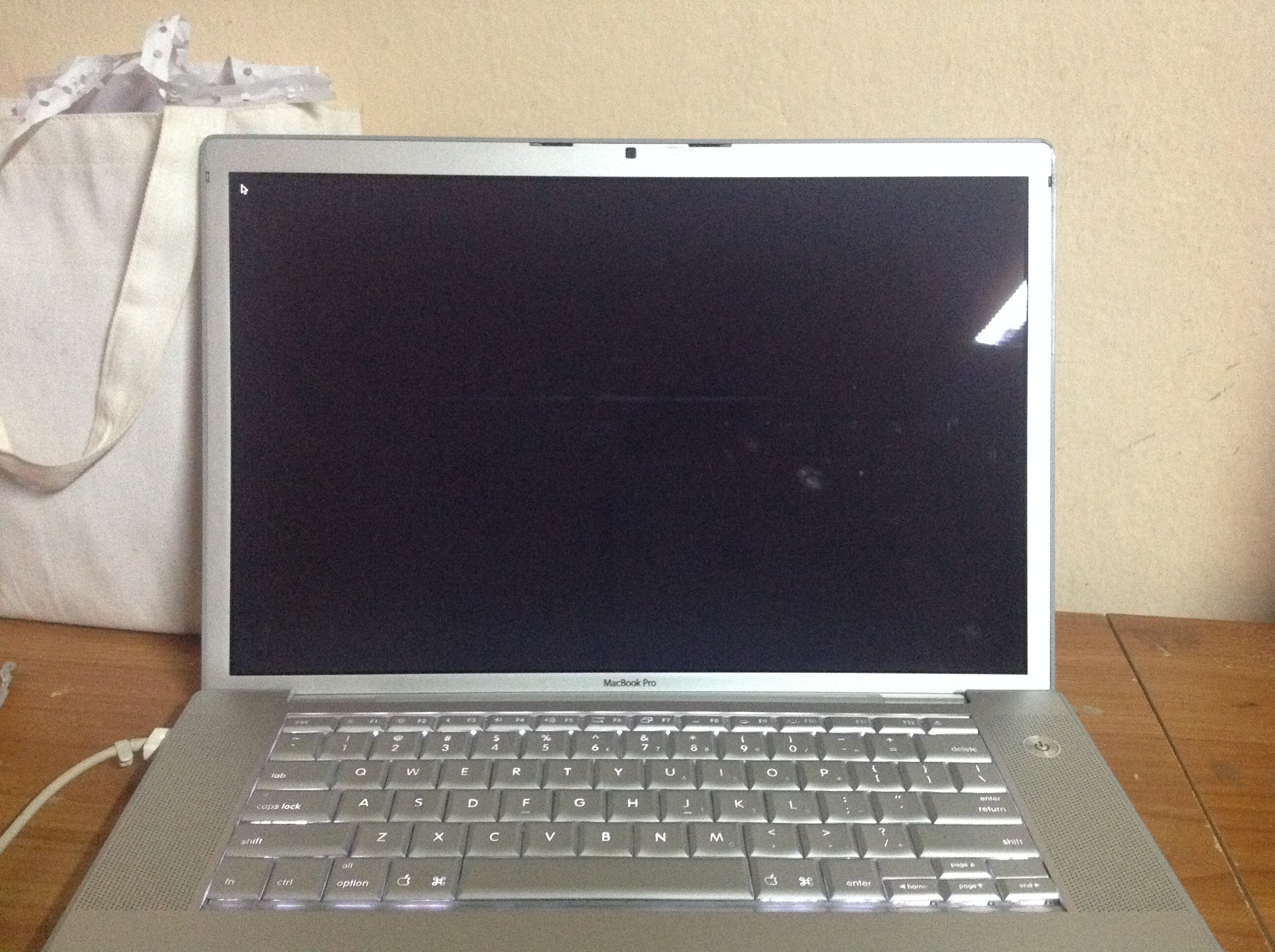

I didn’t have any luck with MacPostFactor and El Cap. It would boot the installer but kernel panic shortly into the process. I tried a number of different USB drives but nothing worked. I stuck with method 3 from this thread and it worked for me, but I did have some issues that the refind flashdrive install helped solve.
I got it to work on my 4,1. I used my 2009 Macbook Pro to install El Cap onto the drive, then hooked it up to my Mac Pro (which is a 2,1 running El Cap unsupported) to do all of the command line fu and file moving. I initially had trouble with getting it to boot from refind, but I downloaded the refind usb image, installed it to usb and booted from it, removed SIP, booted my el cap install, and found firmware.scap in the standalone/i386 directory and the APPLE directory had returned in the EFI partition. I deleted these, reblessed the refind x64 efi, rebuilt the kext cache, and everything works. Now I just need to figure out why my graphics memory only reports 6mb, but that's a kext issue I'm sure I can fix after I get some sleep...
EDIT: Doh! I installed the x1300 kexts by mistake. Installing the x3100 kexts, changing their permissions to root:wheel, and rebuilding the kext cache fixed the video problem.
As far as how it runs... pretty darn good. Some choppiness, but it's reasonable. DVD Player and Maps don't work, but there are other apps (VLC, Google Maps, Movist) that can take their place. 720p videos play fine on YouTube; 720p60 videos are choppy. Grid stack view is really slow, so I changed it to List view instead. Launchpad is decent and not too slow; just a bit choppy. No transparency anywhere. cDock2 can be used to theme the dock to not be blasting white. And of course, brightness controls and wake from sleep don't work. Shady can be used for brightness controlling, and NoSleep can be used to keep the Macbook from sleeping, but you'll have to shut it down if you want to be mobile. Overall, it runs better than Yosemite did on this Macbook.
Now, to get it to work on my 3,1...
EDIT: With a quick disk clone and some editing to boot 32-bit EFI and GMA950 kexts, it's now also running on my 2,1 Blackbook (see photo)...
EDIT #3: ... and now on my 3,1. That's all of them!

Hi,
I've a problem. I have black screen with a cursor after apple loading screen.
I tried to switch to another harddisk but still didn't work.
Please Help me.
I'm using method 3 and I actually have it successfully installed once but after i install duet display and it made the whole system unbootable and i have to do everything in method 3 again and ended up with the problem that i told up there.
