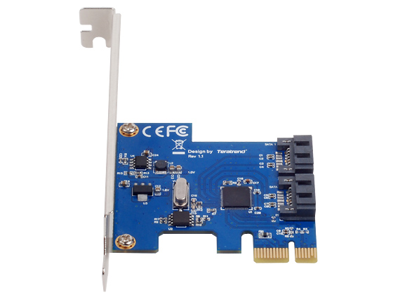

The SATA 3 controller, i use in the Quad is this one:
Works fine with Leopard. But sadly it's only one lane. So in the G5's first gen PCIe itis limited to around 200 MB/s. You get the exact same speed for a single SSD as for a Raid 0 of two. Also tested Tiger again. Nothing crashed or paniced. The card and all that is attached to it are just ignored.

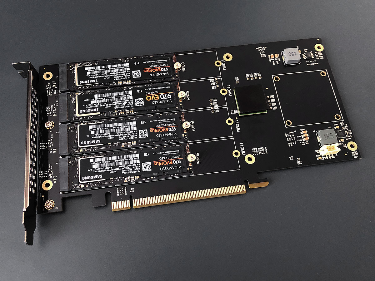

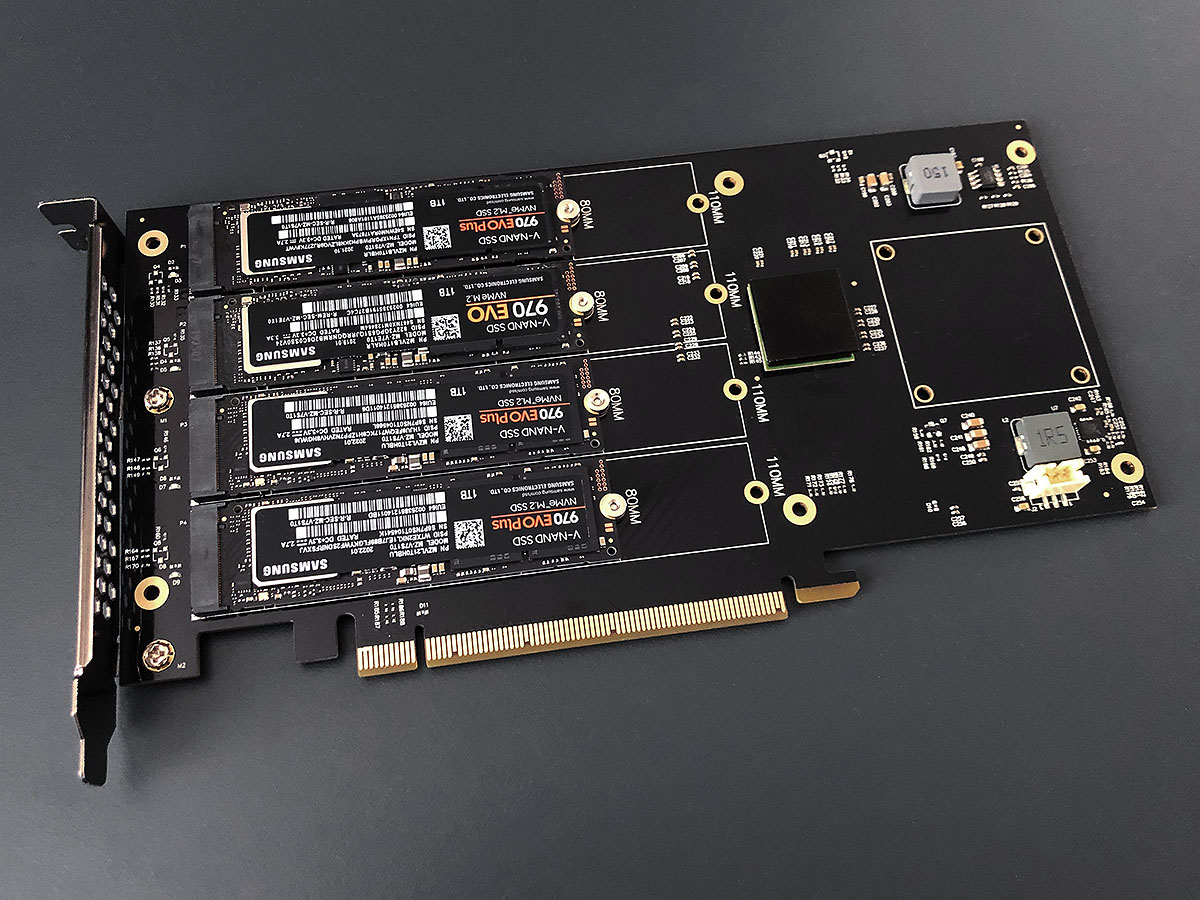

So an hour ago i ordered the Accelsior. If it doesn't work in the G5, i can still use it in one of my Pros, where it should at least be faster than the tray-loads. And if it works (which i tend to thin), even if only recognized as "generic AHCI" with one lane, it should at least also deliver +/- 200MB. So two of them in Raid 0 should be a nice speedbump for an old G5.
This one is for the G5 Quad (which i hope it works in). Might end up in the spare-pro, if it doesn't.

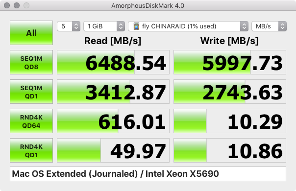

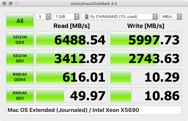

For my daily driver i prefer this...
...which comes up with this...

This thing is from Aliexpress. It is some kind of clone of the 500 € HighPoint-card. For a very short time they have been sub 200 €. So i just couldn't resist.

This thing is from Aliexpress. It is somme kind of clone of the 500 € HighPoint-card. For a very short time they have been sub 200 €. So i just couldn't resist.

Quite easy: It's native NVMe support, beeing available up from HS with bootrom >140.xxx. Any blade works fully bootable with w/r-speeds of about 1.500MB/s with 10$/€ adaptors. This is for the 4,1/5,1.

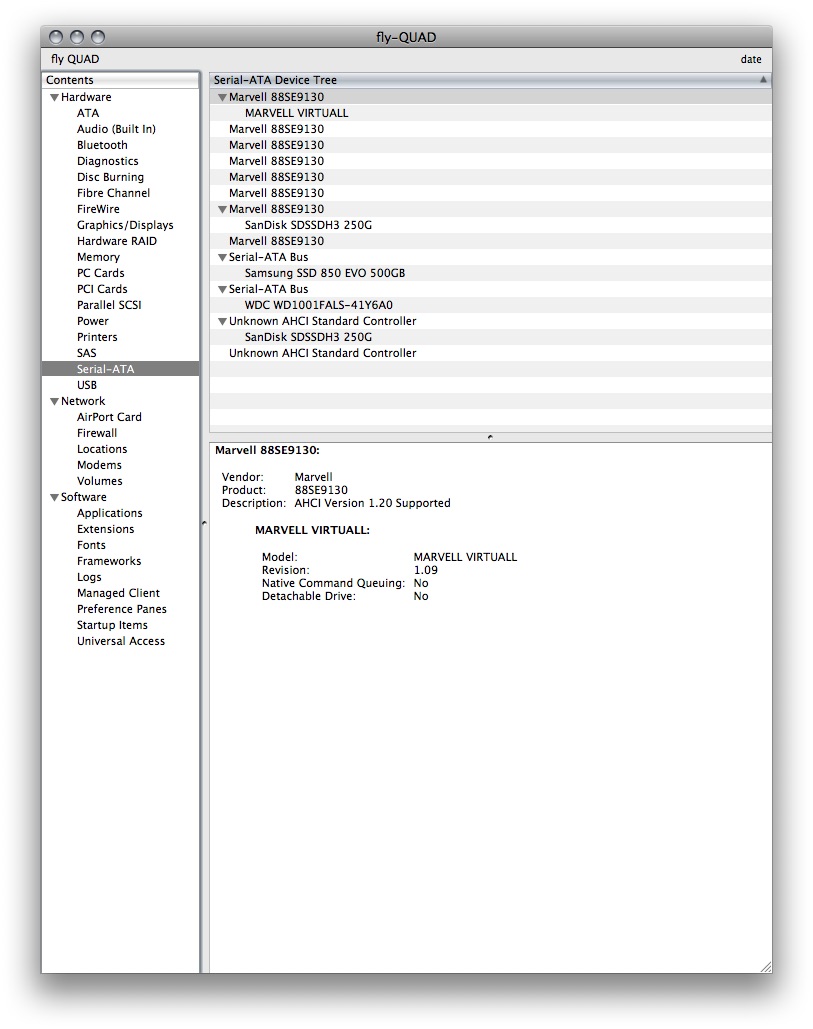

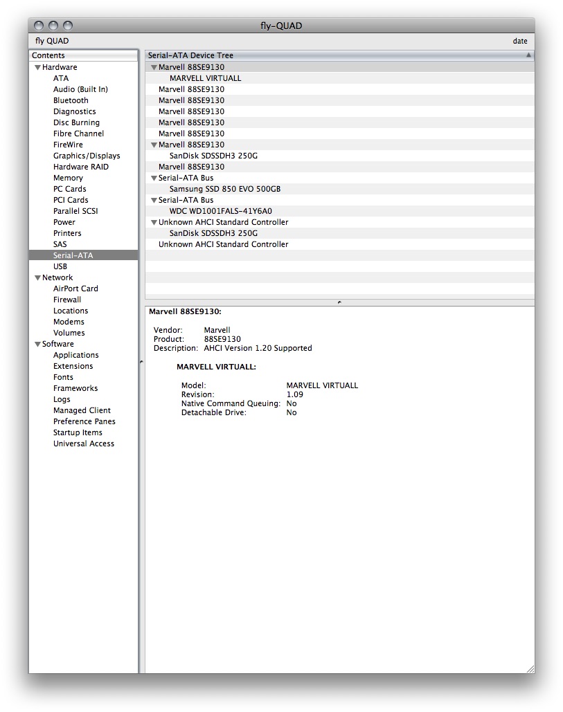

Well, this is how these AHCI-SATA cards appear in Leo PPC:
The difference between the Marvell and the one showing up as "unknown" is, that for the Marvell i added the relevant data like vendor, device etc. to the AHCI kext's info.plist while the other is a Digitus with JMicron chip, which i just plugged in. The difference is just cosmetic, as they just work the same: read and write as one wold expect from a single lane card on a PCIe 1.0.: Read little more than 200, write about 170. But not bootable.

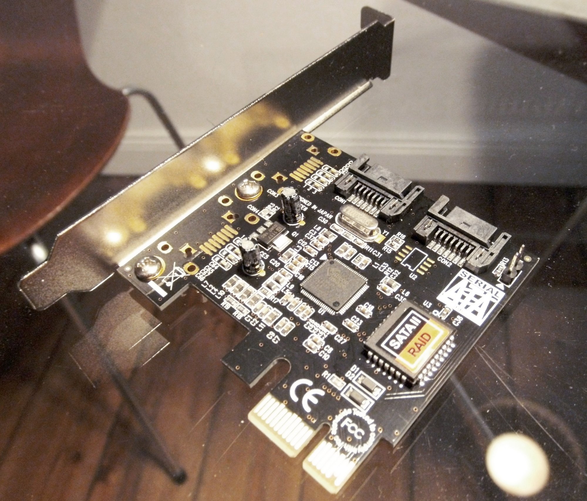

Also i played around with some Delock card which had a SIL 3132 on it. I even soldered a bigger EEPROM to it to get it flashed with the Seritek 2SE2's ROM. In the end i got it to boot. But, even beeing SATA 2, speeds have been barely 20MB/s faster than the Quad's onboard SATA 1. So remarkably slower than the generic AHCI-cards.
Edit: The Marvell card is even SATA 3. But it doesn't make any difference as the G5's PCIe just can not deliver. One can even plug both of the SSDs to it and configure them to run in RAID 0 without the speeds increasing just one single MB/s.
Absolutely. But my point was that if you’re "stuck" with an earlier version than High Sierra — for some reason or another — NVMe SSDs are out. So, the few AHCI blades out there are the fastest option then, even though they come at a premium.

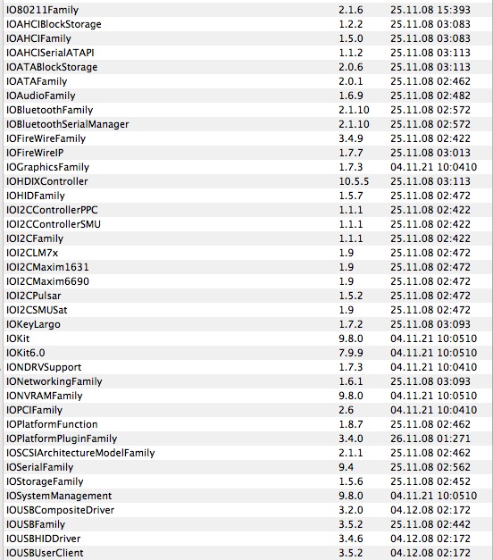

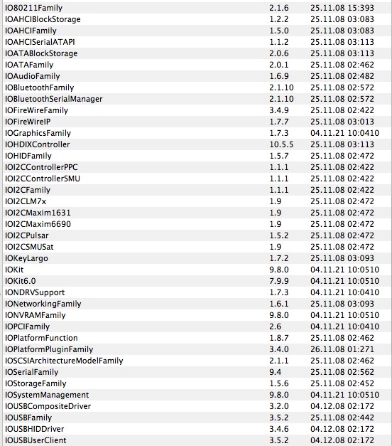

If you don’t mind posting, could you click on the Software > Extensions tab in ASP and scroll to the portion of the list starting with “IO…” and also the portion of the list starting with “AppleA…” and post those screen caps?
