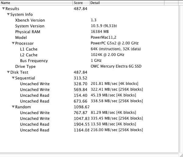

If I understood it correctly this card needs Leopard to work in G5? So, I guess it will not work with the Shuriken as it seems to be built on 10.4.x?
Accelsior S in my G5 with an OWC 6G 1TB SATA3 SSD.
Ps. just out of interest I also tried the Accelsior 1M2 PCIe -card which takes a NVMe -drive but no, as expected its not recognized in the G5. Should work in Mac Pros though.
