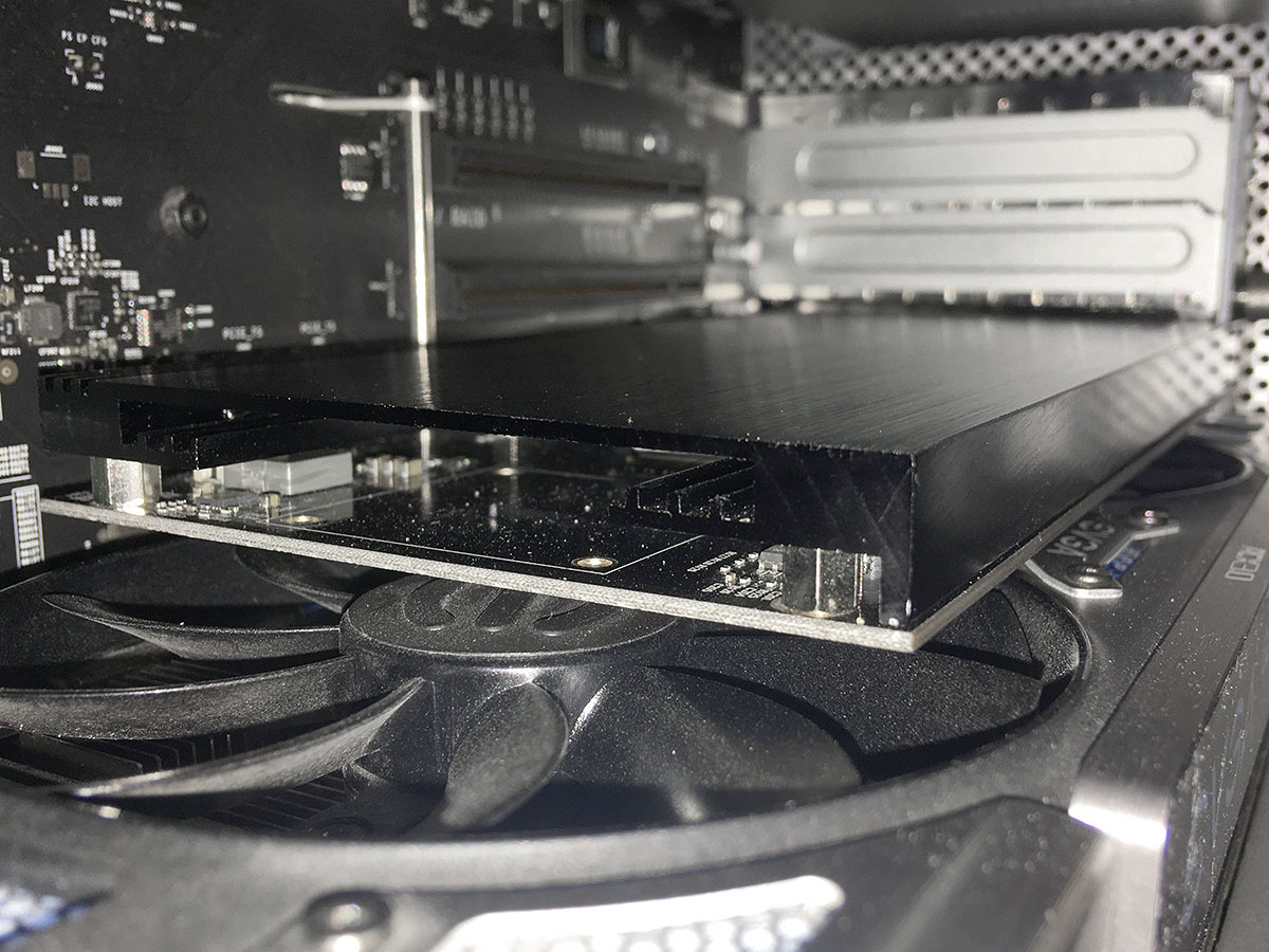

...but, looking at the price point, just couldn't resist. They have been on Aliexpress for a very short time for 167 € (equals $) with free shipping. But at least in this case the investment was of exeptional real everyday productive value.
It is basically some kind of clone of the HighPoint 7101a. Same chipset and very similar PCB-layout. I use it in the second x16 slot of my main working machine, a 5,1, where it shows some still serious numbers.
For a single 970EVO plus (which boots fine)...
...and for two of them in Raid 0.
Reactions: Amethyst1
I wonder how noisy that tiny fan is. 😉
I wonder too! ...but cannot report, as i just removed it! 😁
The 5,1's expansion card fan blows right into the back of this thing...
...so i decided that this screaming 3$ part should not be neccessary. And it seems to work fine. I got temps around 55ºC for all of the SSDs even on hot summerdays. At the moment they are all far below 50. Shouldn't be any problem.
