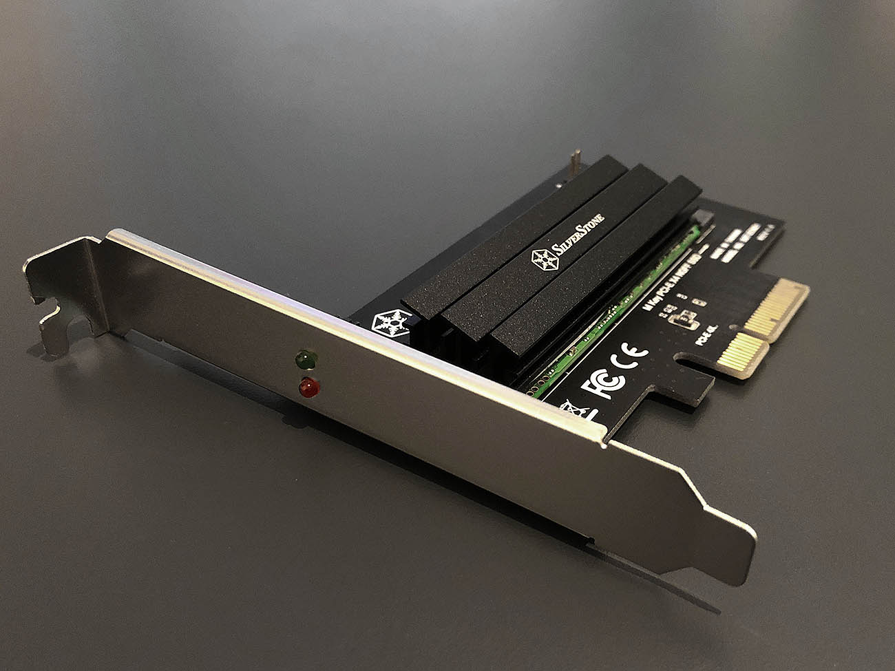

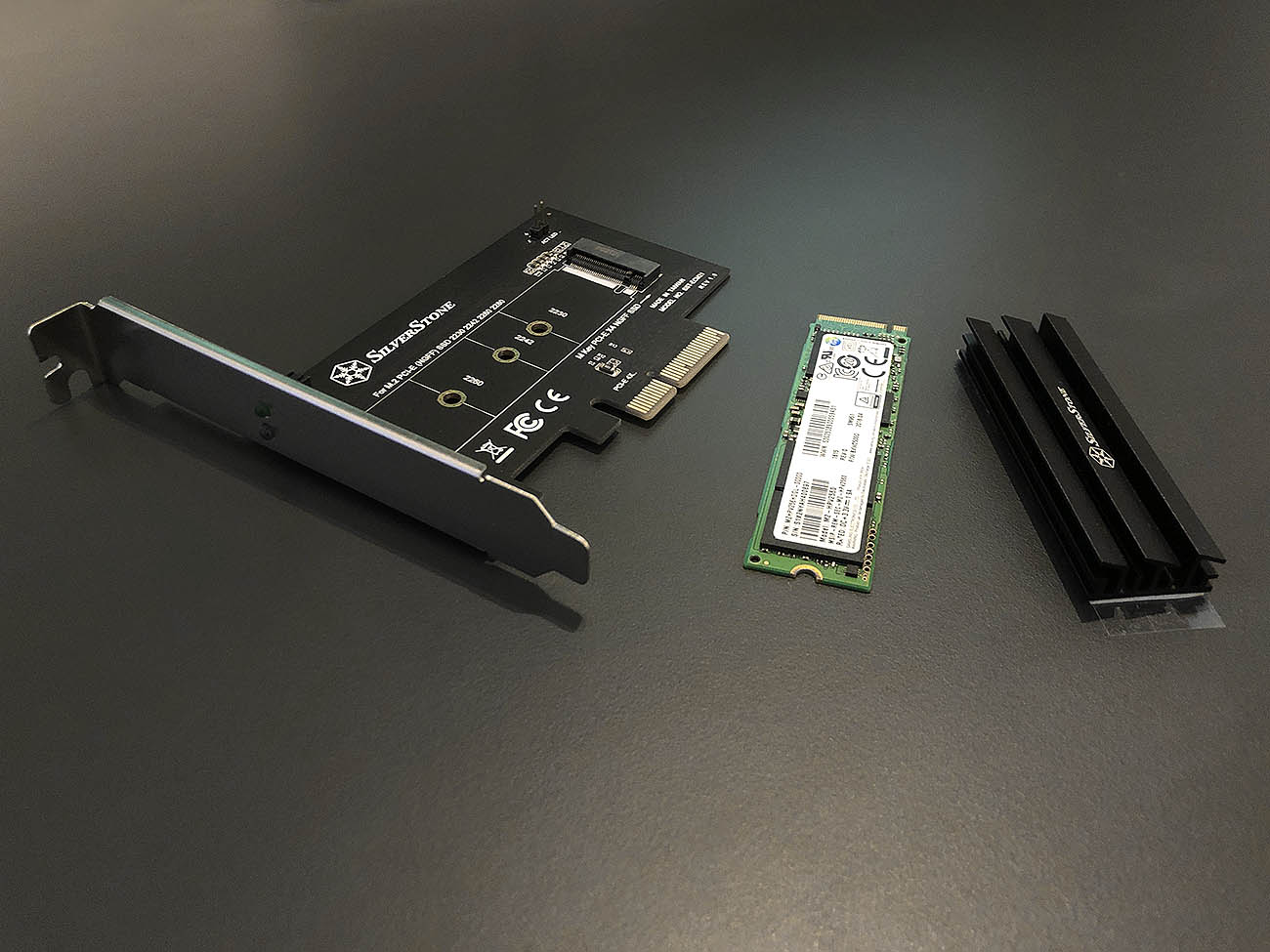

So here they are...
...united and ready for business to torture PCIe 1.0 on four lanes...
...and business has been done! Just forget about the Tempo Pro!

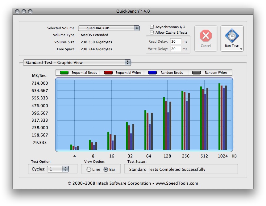

QuickBench 4, Standard Test

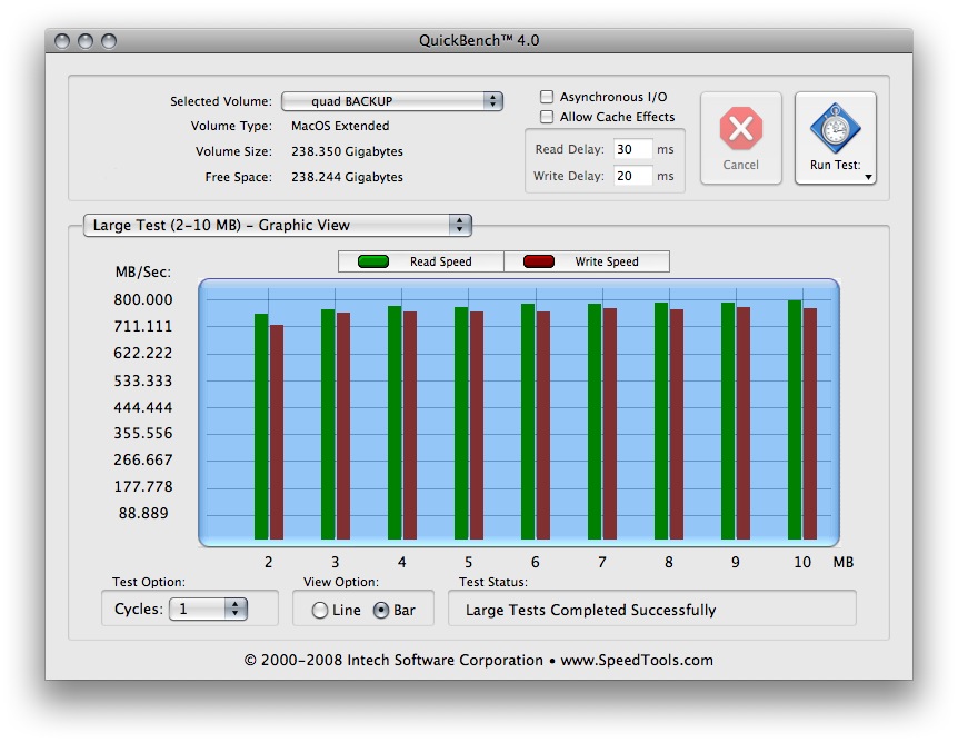

QuickBench 4, Large Test

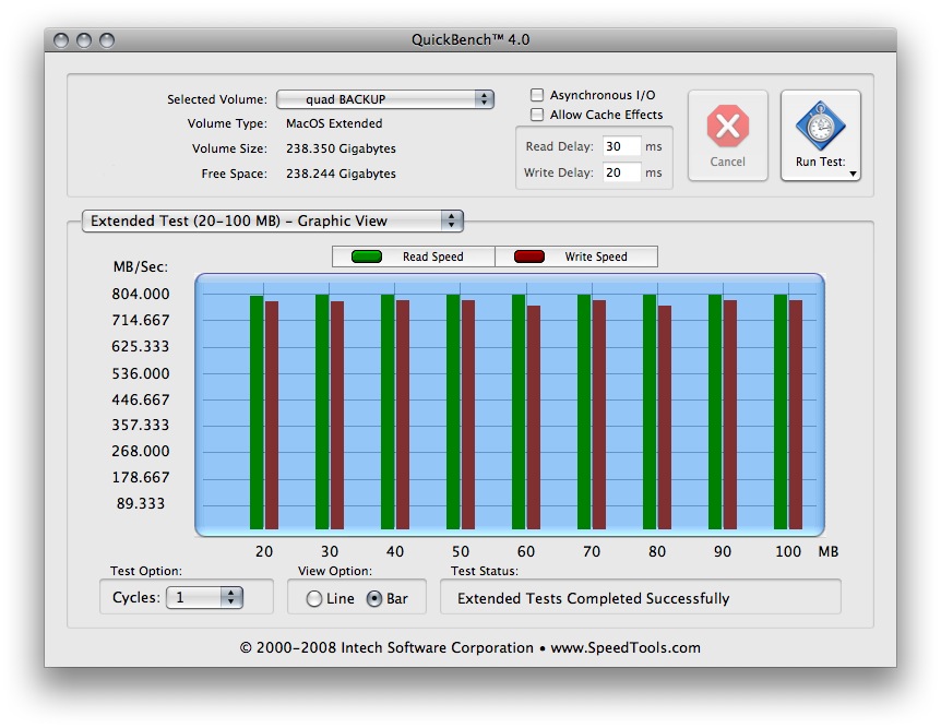

QuickBench 4, Extended Test

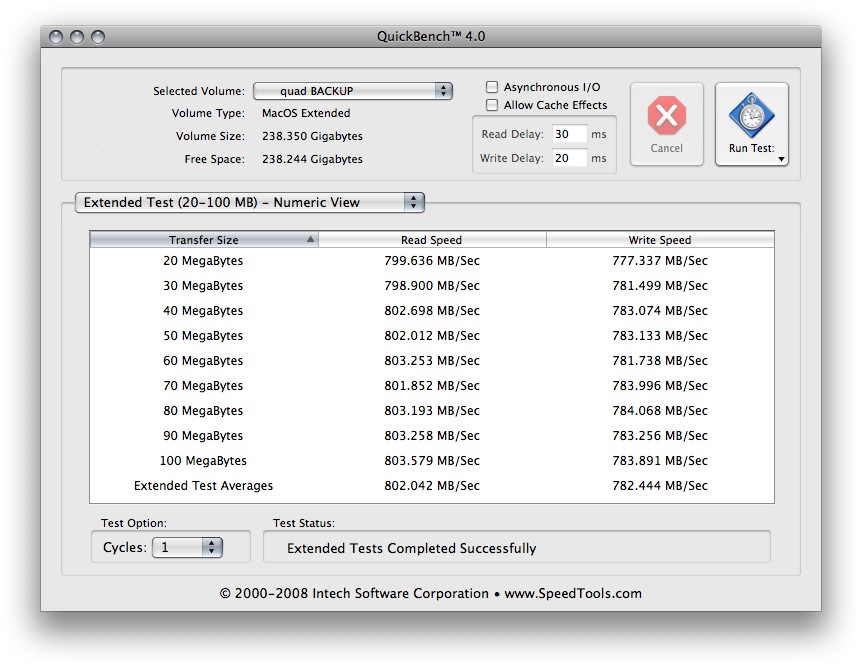

QuickBench 4, Extended Test, the numbers
