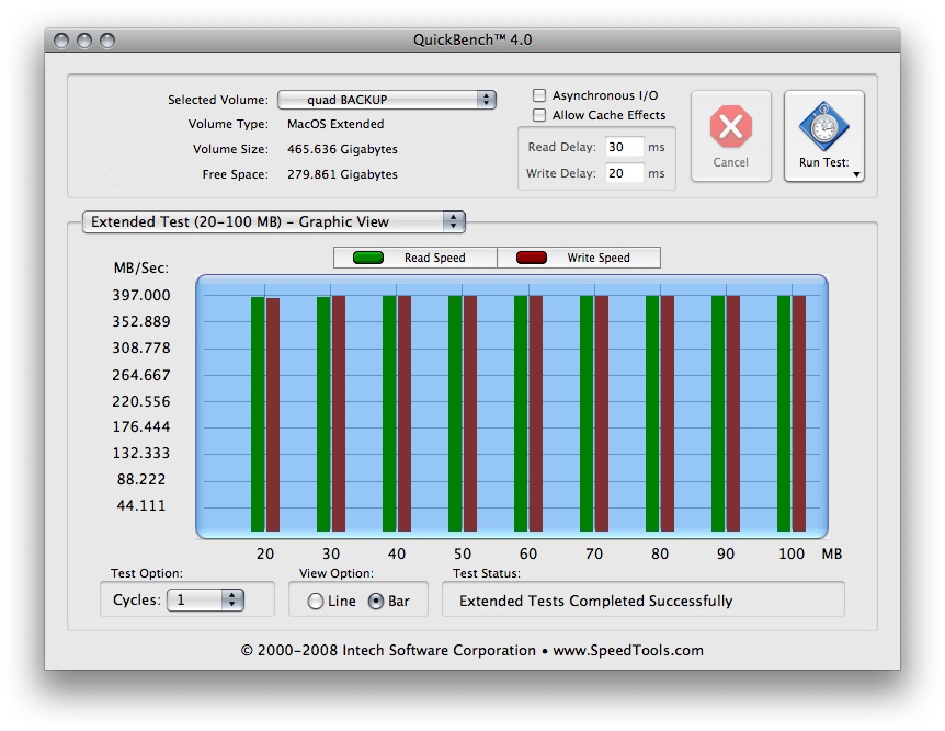

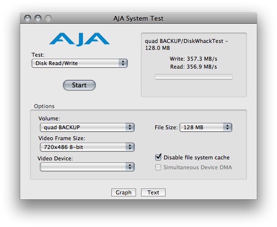

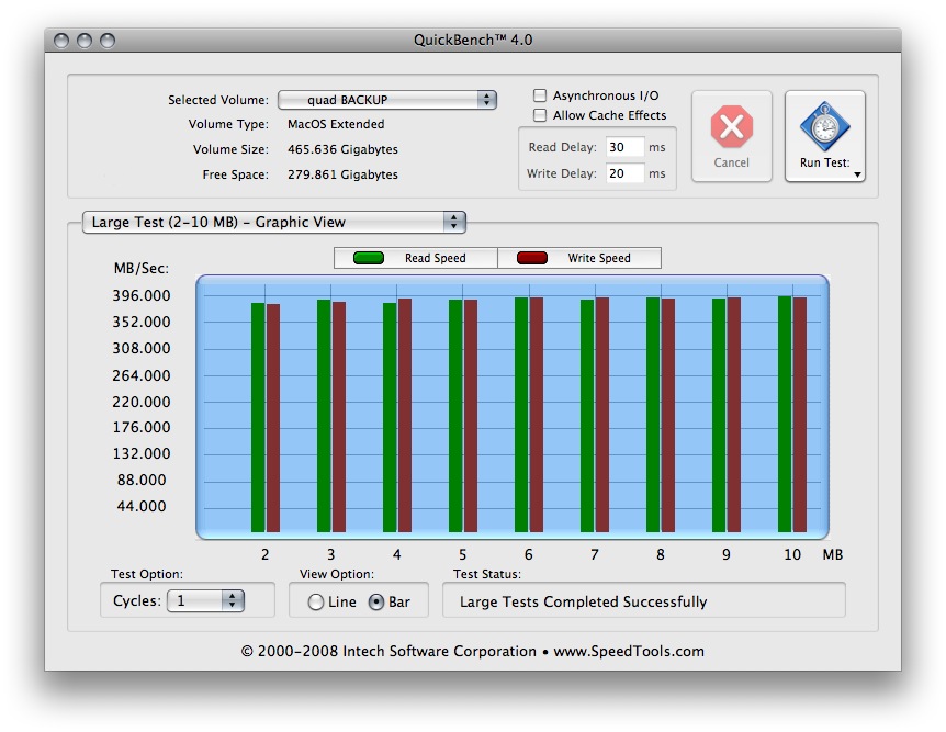

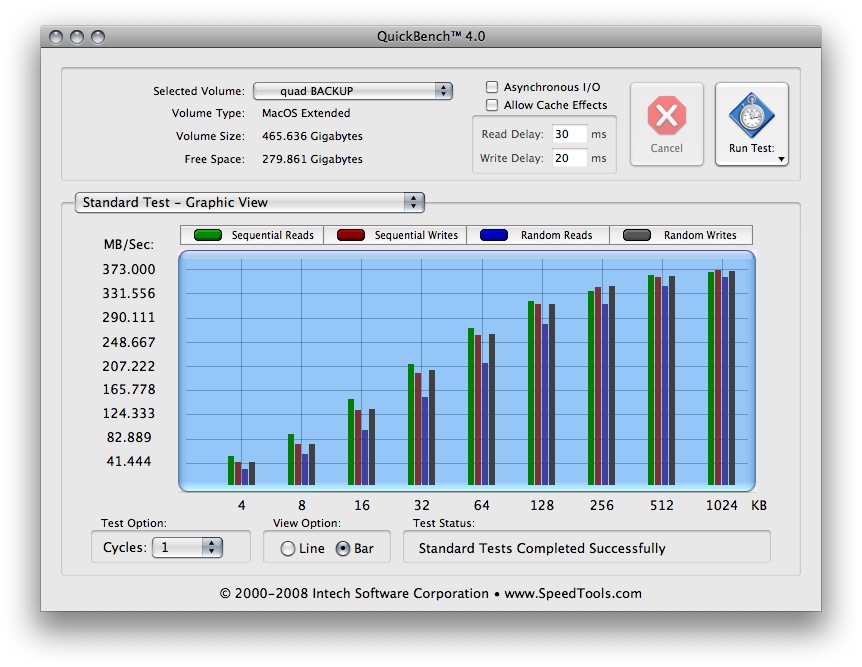

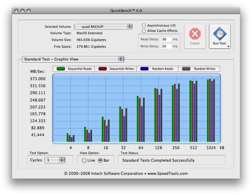

The card arrived today. Put a 500 Gig SAMSUNG 850 evo on it and swapped it into the Quad. Fired the machine up and minutes later was left a bit speechless. By numbers i had not seen on a Powermac before:
Thats what it came up with: Nearly hitting 400 MB/s with a single disk! Just what a Two-Lane-Card on a PCIe 1.0 can offer. And so far the Accelsior, at least for a G5, is the far better choice over the Sonnet Tempo SSD, which at the moment of writing costs four times it's price...while using the exact same Asmedia 1062 chip. Sure the Sonnet has Dual SATA Sockets. But, as it also only has a two-lane-interface, it is limited to the same speed as the Accelsior. Means: Even with two SSDs running in Raid 0 it will not be any faster than the numbers above! And to the G5 it is also nothing more than an "Unknown AHCI Standard Controller". Meaning, it will also not boot!
So for G5 users, looking for fast storage, the Accelsior S might be by far the best bang for the buck. Costing around 30 $/€ at the moment. For a card which, if not PPC-bootable, at least kicks the a... of even a 5,1's HD-trays! I'm very happy with my purchase...

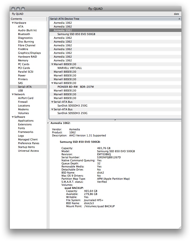

...and allready edited the AHCI kext to show things right:

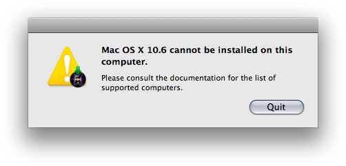

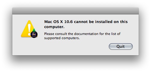

Wanted to give it a try with the Quad today. But not too much luck again. The prebuild DMG restored to an empty SSD panicks when booting. And with the regular installation i get this...
...even with the OSInstall package replaced and permissions adjusted. 😟
I’ve not personally worked with the pre-built install image. The three times I’ve installed Build 10A96 on a system has come from the steps needed for installing onto a drive/partition from a working Leopard boot. It’s a little more work than a one-and-done image of a pre-built image, but it’s also more likely to work without the kinds of issues you’re seeing here.
Another note, which may or may not be relevant to your situation here: if I recall correctly, that pre-installed image was an installation onto a G4 setup (either a Power Mac G4 or PowerBook G4, though off-hand I don’t remember), not a G5. Running the installer from a Build 10A96 or 10A190 source, not the pre-installed image, would let the installer scripts assemble what needs to be installed onto your particular hardware. As others have been running both builds on Power Mac G5s (including quad G5s), we know it’s doable.
In short: first, boot from 10.5.8 (i.e., from an external FW drive or maybe a spinner drive on the OEM SATA bus which you don’t plan to use). Run through the steps needed to get the SL-PPC installer prepped for installation onto a destination location on your G5. Run the installer via that route. If you’re still having trouble, post onto the Snow Leopard for Unsupported PPC Machines (aka, the Clouded Leopard) thread, and I’ll do what I can there to assist. Hopefully, other folks who run SL-PPC on G5s (something I have yet to do personally) will be able to help walk you through the steps.

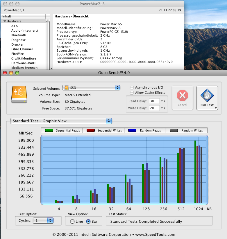

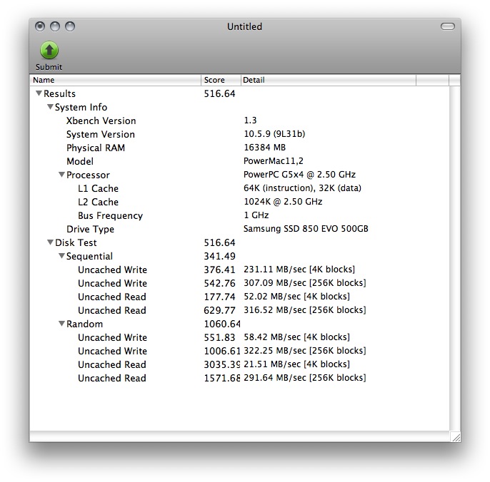

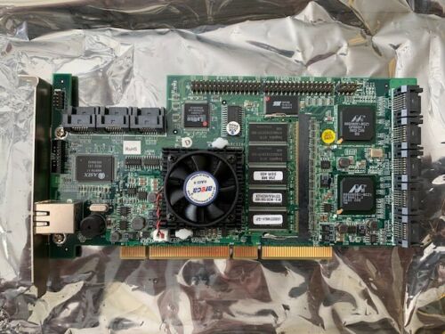

Winner: G5 7,3 😉
More info please 😉 What SSD and SAS controller is this?
Reactions: B S Magnet

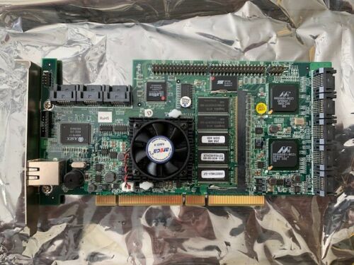

Samsung 850 and this one:
This looks like an Areca ARC-1160. Your results look like they're coming from the Areca's on-board DDR cache rather than the SSD itself, since the card is SATA II. "Stimmt's oder hab' ich Recht?" 😀

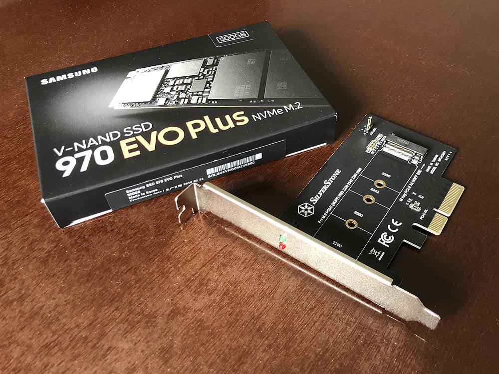

I am a bit confused now. NVMe- and AHCI-versions seem to have the same connector. Do they use the same adaptors too? Meaning, can a NVMe-PCIe adaptor be used for an AHCI blade too? This would be nice, as i have two of them which i have no real use for anymore.
Reactions: Amethyst1
Which blades are these, just out of interest?
Not SSDs, adaptors. And no notebook formfactor. The ones i used in the 5,1 before i got this RAID-card.
