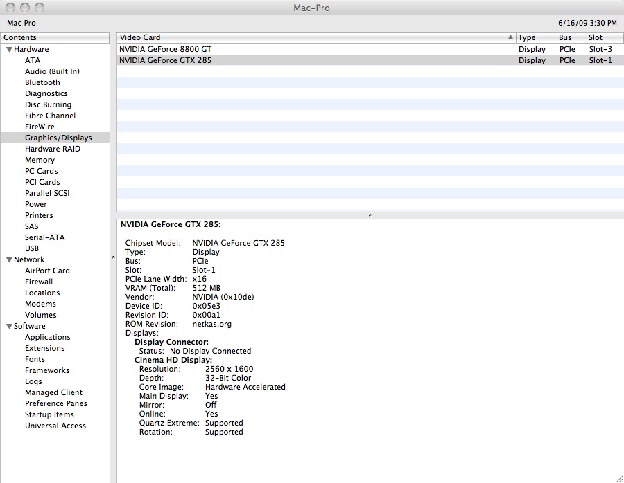

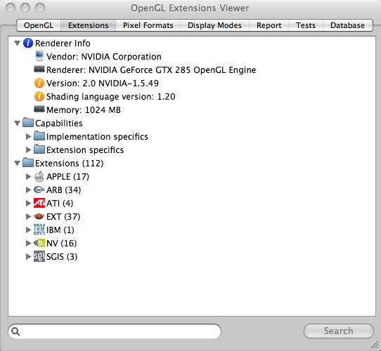

285 GTX working in 1st Gen Mac Pro !!!
Slapped an EFI32 8800GT in and a power splitter and BINGO !!! THE GTX285 IS WORKING !So far I have tried both outputs with Dual Link, both work.
So it seems the 8800GT is needed for something??? Will do whatever tests anyone thinks might help. I have a 7800GTX 256 running a Quadro EFI ROM I could also try with, I think it uses similar EFI to the 7300GT as it is G70.

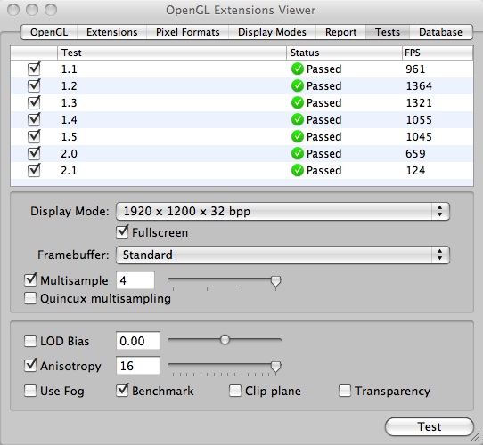

The OGL test seems to show the throttling up issue. I ran it multiple times, score for 1st section always artificially low, card "kicking in".
Good work, Netkas !!!
