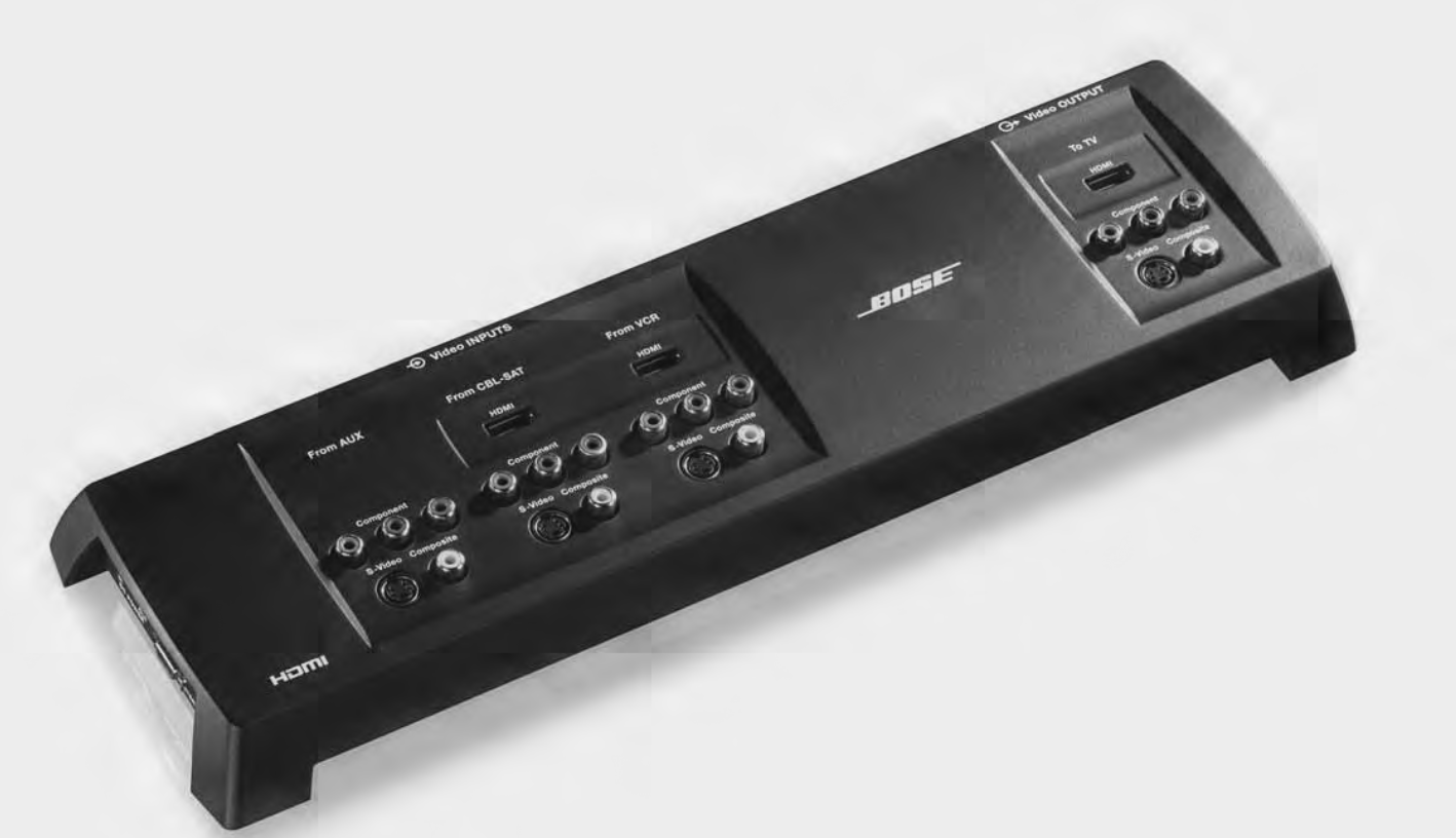

The equipment we have is a Bose Lifestyle 28 home entertainment system for audio. http://worldwide.bose.com/productsu...ting_an_audio_video_device_with_vs2/page.html
It looks a bit like the attached file. You can choose the source on the Bose system as AUX or VCR (?). We bought an HDMI splitter but it did not work as it caused the music to stop playing when the TV source was switched from the HDMI input to which the Apple TV was connected.
We want Apple Music to play sound on the Apple TV but not to interfere with whatever source is on the TV (i.e. the antenna/traditional TV view). So in other words, have the news channel playing on the TV while Music plays through the Bose surround system.
Apologies if this doesn't make sense as it barely makes any sense to me myself!
Thanks in advance.
From an overview of the Bose Lifestyle system you have, it seems to me it doesn't have the flexibility to do what you want. It basically wants to output audio to its Lifestyle speakers from whatever input source is selected - TV tuner, AUX, VCR, or CBL-SAT input ports. It's a fairly complicated system and I can't tell how Bose designed the internal source switching. Maybe contact Bose or the retail shop to see if selecting TV tuner as a source will allow listening to ATV audio separately, but seems not likely to me.
As mentioned by others above, a solution might be an audio extractor or additional older ATV (not sure these would work with existing ATV 4 in this system, though). It's also pretty sure this system doesn't support DLNA as it's not network capable, so not that option either. Maybe others here who know Bose Lifestyle can provide more information.
