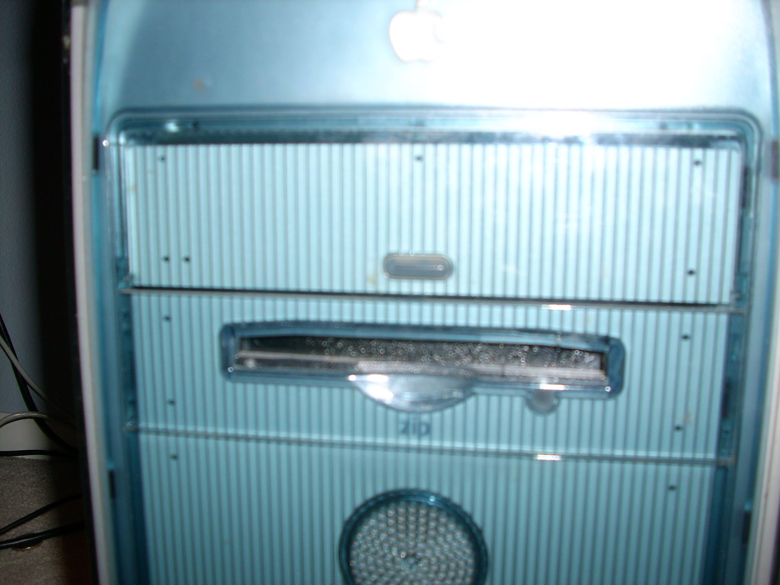

I'd trade you for yours, I don't want a hole in my awesome machine lol. BTW the bezel for the ZIP drive is hot glued to the back of the panel, but there isn't actually a ZIP drive, I just didn't like the obvious open space. Anyways, it's up to you and I would like to see a pic of yours first before a trade.
Sure! I'll take a pic of mine after I get home! Also, the fan is not 120mm its 155mm so yeah. And also, what did you do with the speakers? Did you strip the wires and solder it to my foot?
Also, does the zip drive bezel work with floppy drives?
Hmmm, maybe we have slightly different models as far as the fan goes. And I pulled the speaker out and dumped it, it wasn't worth my time to try and get a 10 year old front speaker hooked up.
The only reason I don't think a floppy drive would fit is because of the lack of a button hole. The pic below should show you what I mean. And remember the bezel of the zip drive is hot glued to the other side, so you will have to pull it apart lol. When you take a pic of your panel, please detach it from the powermac so I can tell if we have compatible panels
Wait wait wait... if it dosent work with a floppy drive.. Screw it. all i wanted it for was a floppy drive. can you test it first?
peel away? if you screw it in without a hole that's big enough, you wont be able to open it because the plastic cant move
Right. You have to kind of melt/peel away the plastic with the drill right after you make the hole. Git rid of about a quarter size area around the screw so it can still open and close.
