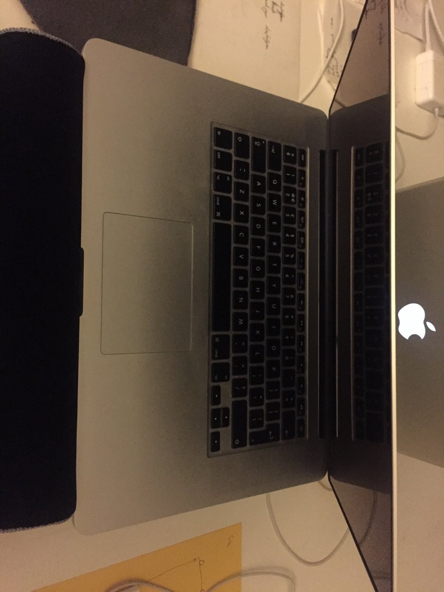

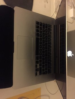

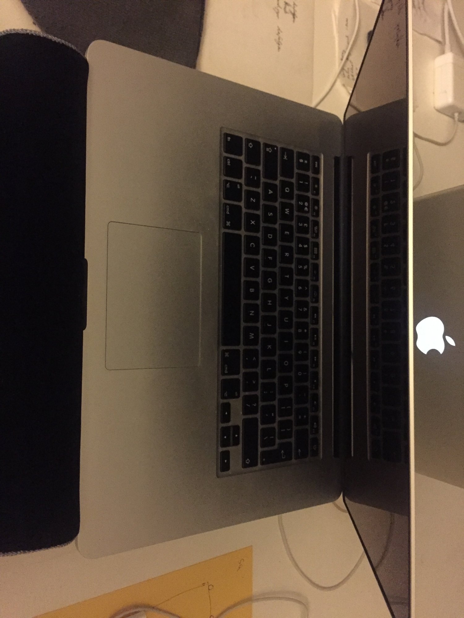

So destiny struck, yesterday my Retina 2012 15" MBp had to get a PRAM reset and a Single User boot to clean up files since fsck couldn't repair due to the disk being full (18 Gb free).
After removing some more files (60 Gb free) today it decided not to boot , OS X loads and then at the end hangs and shuts down. Single User fsck keeps repairing,finding issues,repairing , Internet Recovery cannot repair the disk.

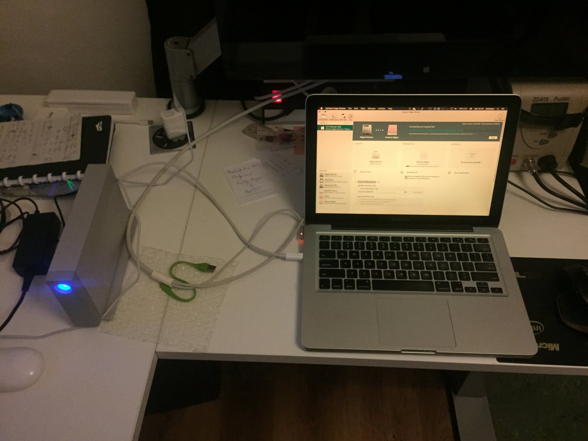

Thus my 13" 2010 MBP that I use as a work laptop has backup duties now .

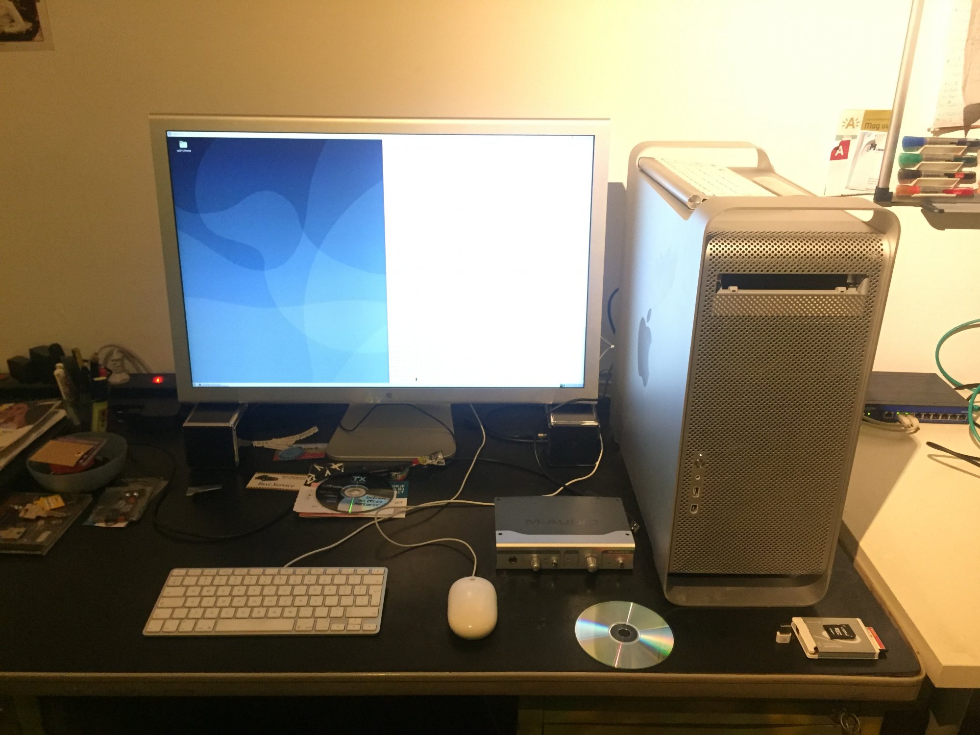

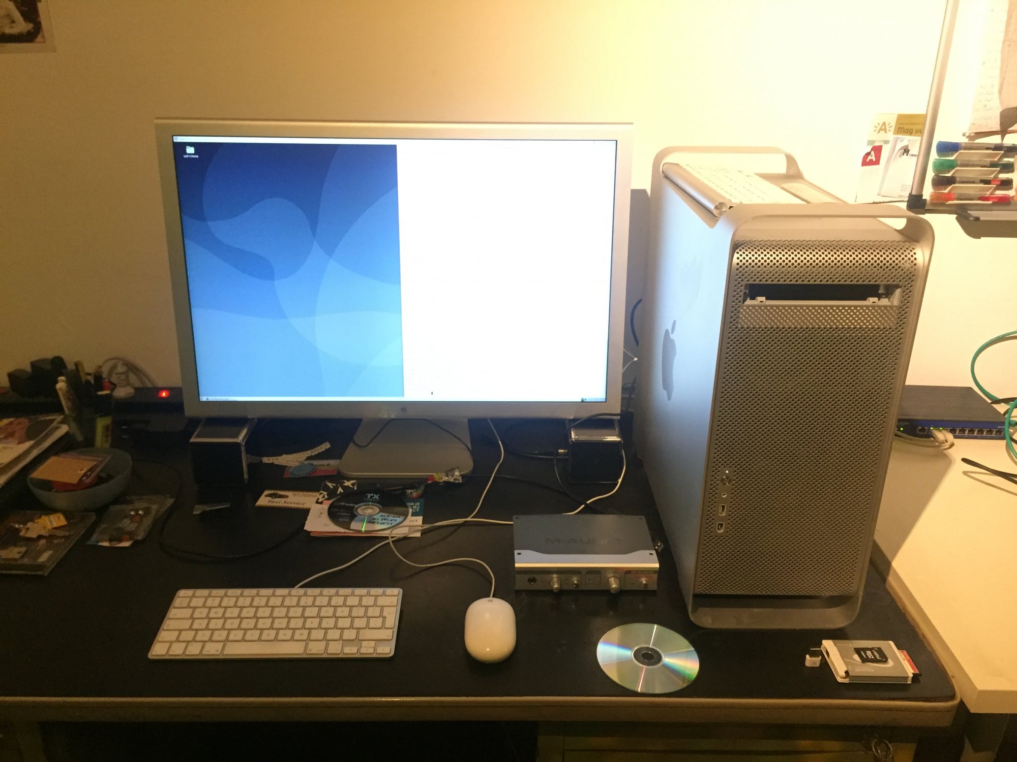

That did the trick, got booted on the G5, installed lightdm, installed Mate, rebooted an now I don't get a graphical display just flashes , guess that's due to the Nvidia Geforce 6600 I got installed ?

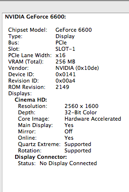

EDIT in the meanwhile I tried this trick to copy the firmware rom and have it loaded but to no avail.
@wicknix @z970mp thanks for all your time in helping me , should I just stop with Debian 10 and try Debian Sid or Debian Sid remix ?

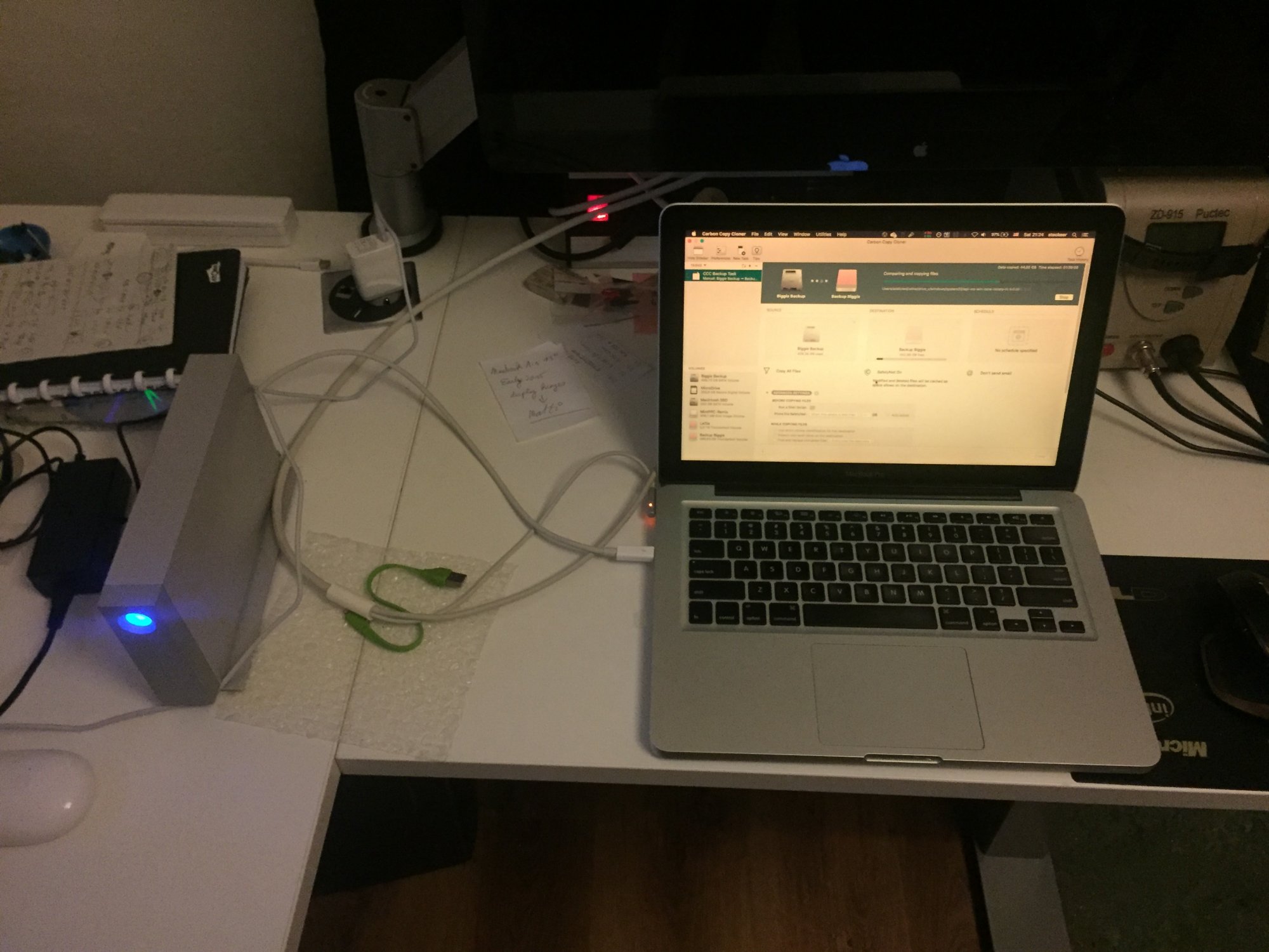

My work MBp is currently cloning the non-booting MBp's data to an external disk so the only usable

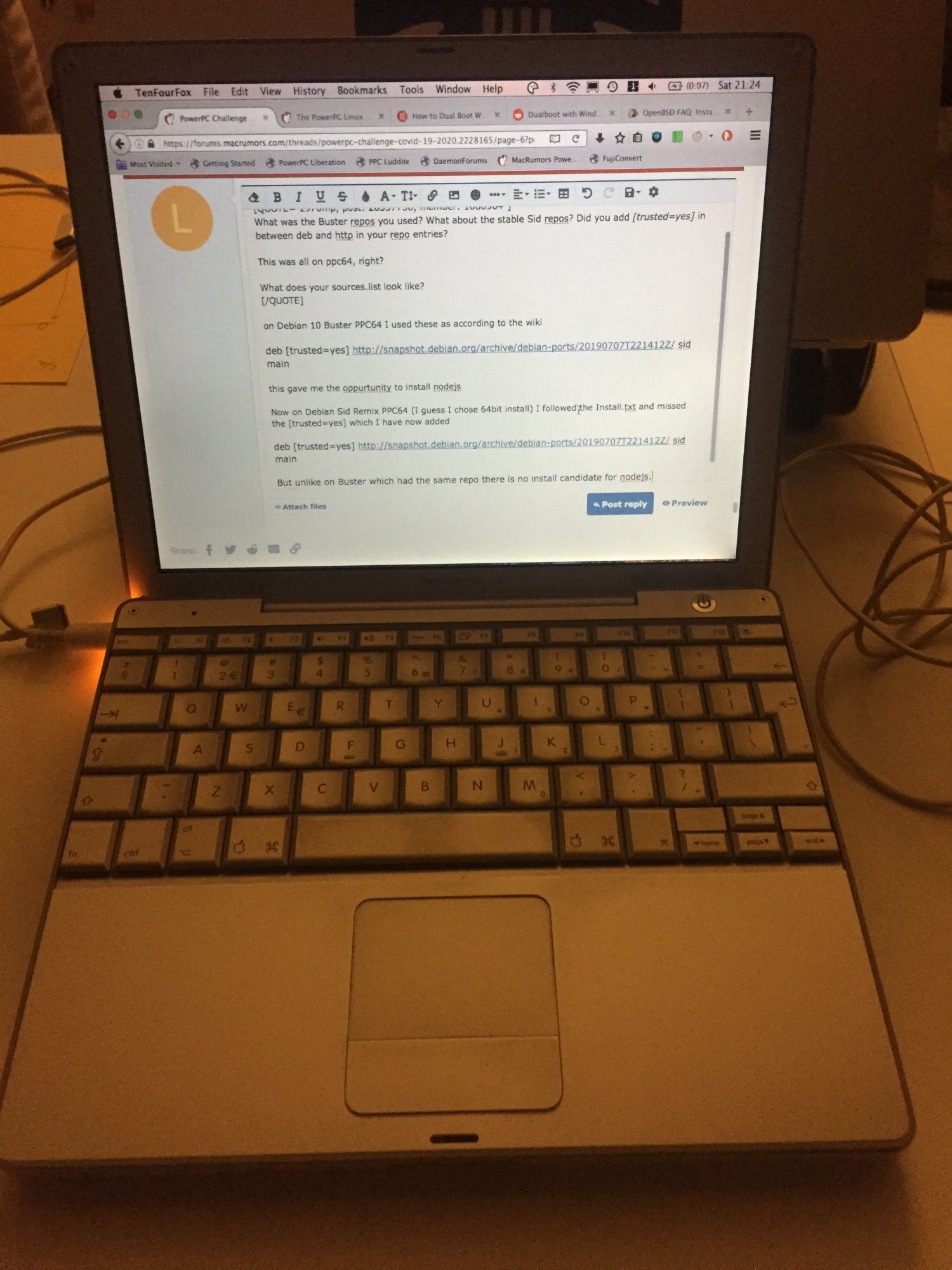

Powerbook G4 used for replying to this thread .
MBp 13" non-retina 2012 re-cloning the 15"s backup from it's internal (now full) drive to external drive to put back onto the MBp 15" afterwards.

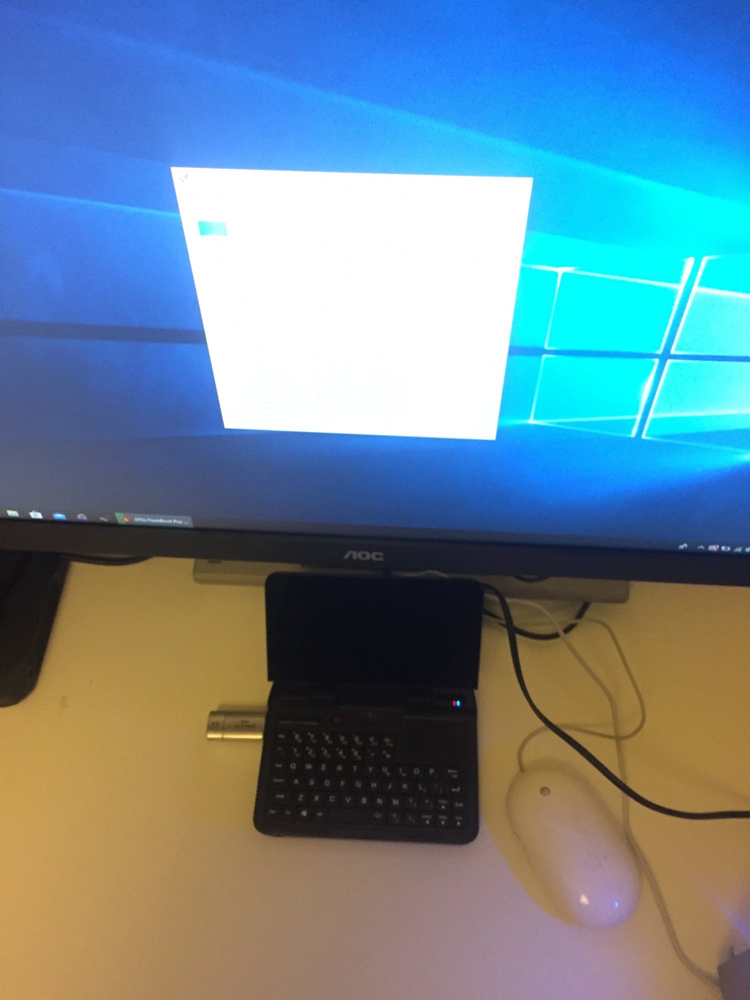

GPD MicroPC with the failed factory-battery but due to my screwdriver not having arrived yet , can't replace the battery thus cloning it's Win10 partition to USB stick.

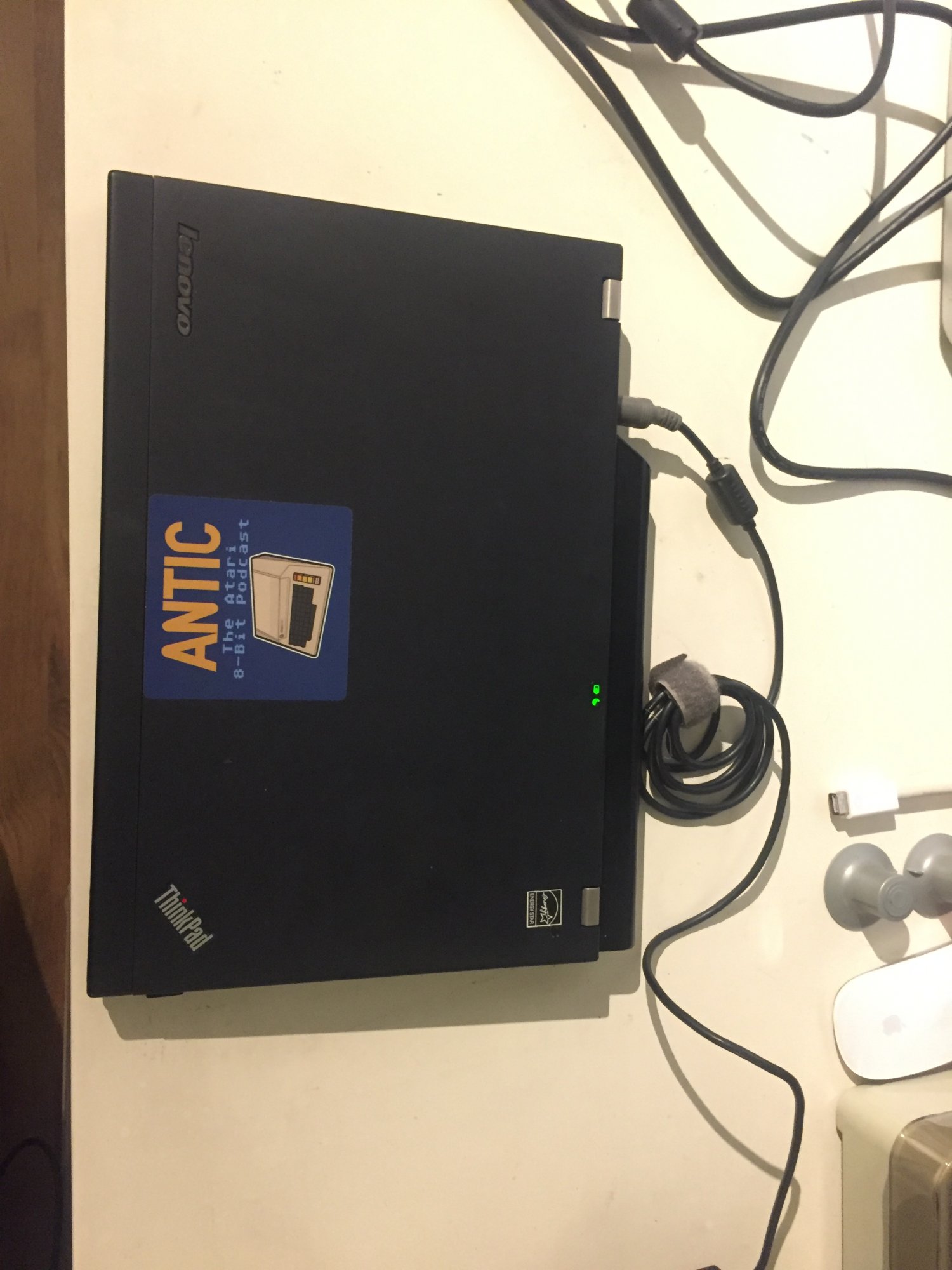

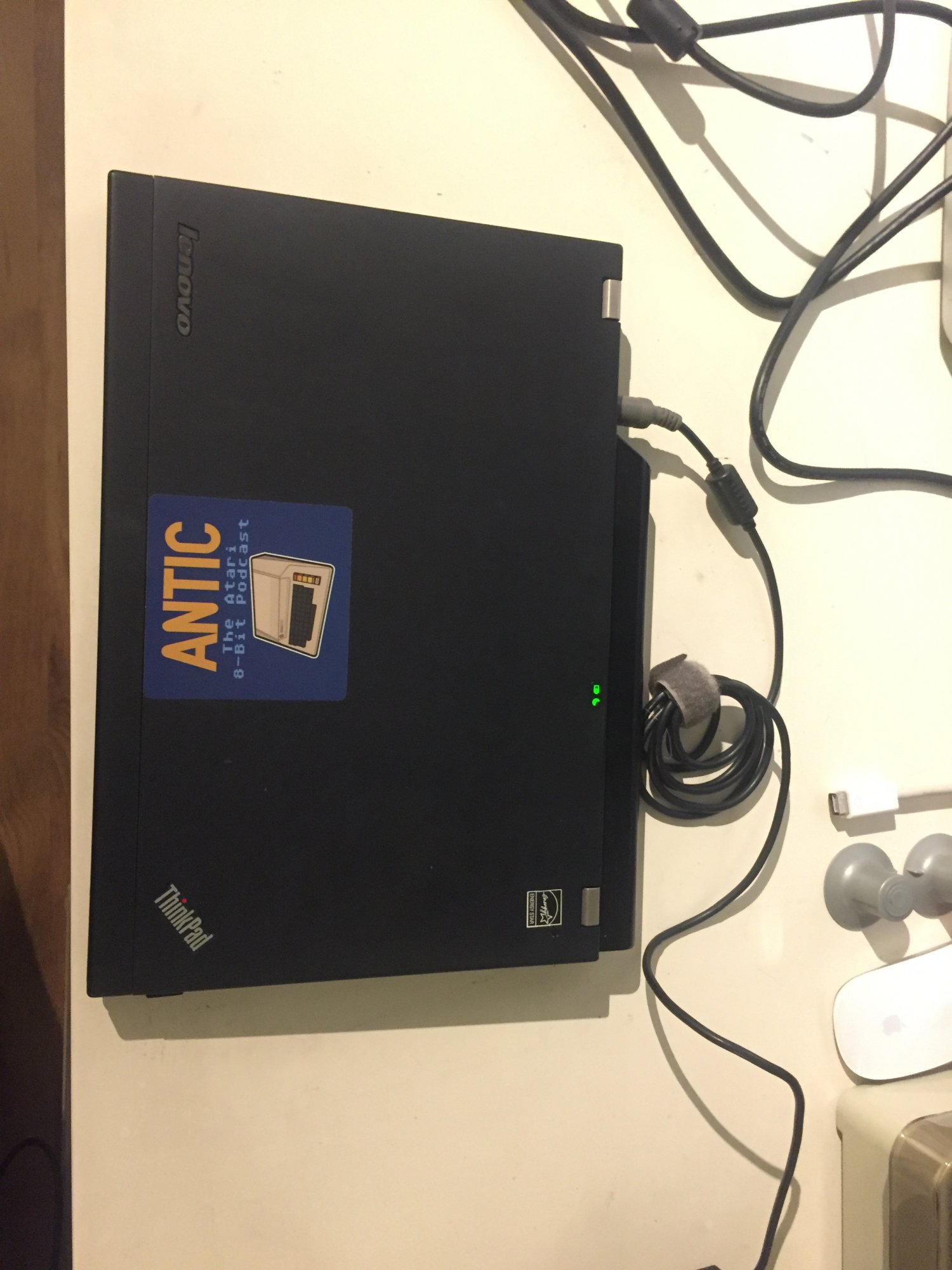

Lenovo Thinkpad Win10 with a broken .NET install , charging ,awaiting to receive the Win10 GPD clone for Atari 8bit development + new to be installed Fedora for the DevOps Course.
PowerMac G5 booted in Debian Sid Remix being troubleshooted
but since I can't open any working browser have to run back to the Powerbook G4 .
