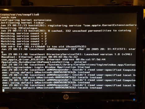

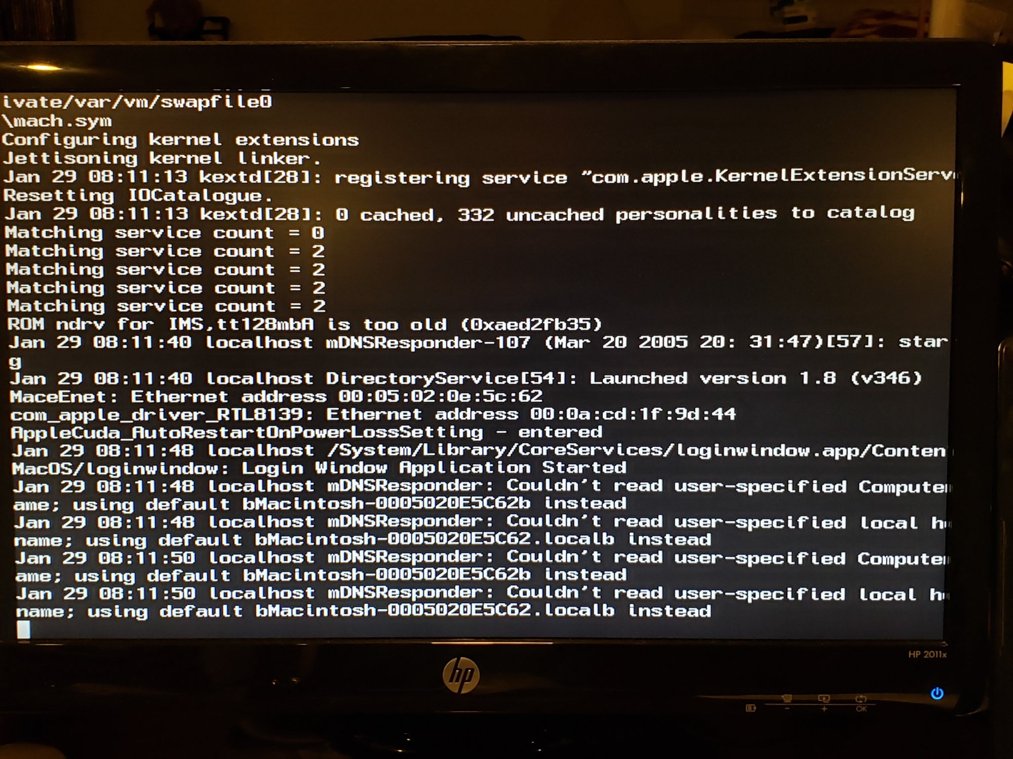

New here...I saw a post from LightBulbFun on how he 'fudged' his TT 128 video card to work with 10.4.11 on his 9600. I'm in the process of installing 10.4 to my 9650 workgroup server and it has the same video card. After going through the Xpostfacto installation, I can actually hear the 10.4 'song' when it's finally done booting but can't see the 10.4 screen. Somewhere along the install I lost the video and I took a snapshot of what I see. This comes up every time when I boot so I'm thinking if I can just get over the video issue, I'll be able to see OS X on my screen. I see a statement on the attached photo where it says ROM ndrv for tt 128mbA is too old so that must be the problem. This screen shot is all the video I see as video stops here but 9650 continues to boot up into 10.4.
Just looking for any help or guidance to get through this as I'm so close now.
Hello! welcome to the Forum 🙂
in Xpostfacto's settings will be an option/tick-box to force OS X to use ROM based NDRV's it normally rejects
(it adds the boot-argument romndrv=1 if you need to manually add it yourself outside of xpostfacto)
this should get your 9600's video card to give an output in OS X 🙂
Hey LightB,
I tried that already and it didn't work. I was curious if you had to do some mod to a kext or something along those lines. I suppose I could try again but I have tried this setting twice with same result (see picture). I've also moved the 128 to a different slot and that had no effect.
I guess more importantly, from the attached picture, is that my real prob or could it be something else?
Well I did get it to work! Don't know how stable it will be but at least I can see it and use it. So if I want to upgrade from 10.4 to 10.4.2, do you just find the update and go through xpf again?
pretty much yeah, although the latest version of tiger is 10.4.11 so i recommend upgrading to that (which it will find via software update if your connected to the internet)
