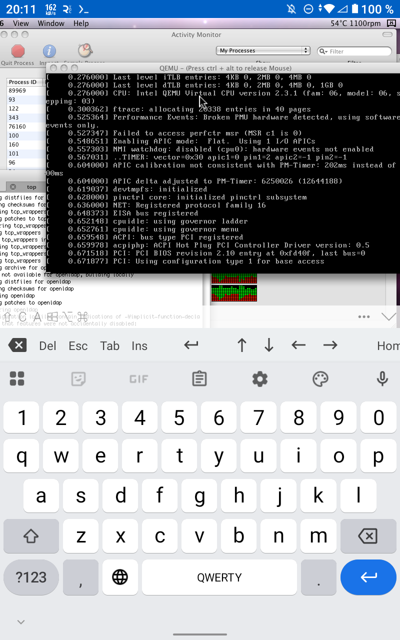

and qemu can't boot finnix-111 x86 iso (nor kernel nor memtest)

picture of qemu 2.3.1 Linux x86 kernel hang
iso image form
ppc version also sadly hang, seemingly.
Also, I tried /dev/rdisk1 (optical drive with my Bonslack installer iso inserted) and qemu complained that it can't open image. May be permission error, or qemu really lacked support for raw disk access under Leopard at least in this version.
You could try this version: https://github.com/macos-powerpc/powerpc-ports/commit/ed1dccc2e0f328208e77908307ebc9af7c93b687
Please let me know if it works.
@Matias_ Could you comment on this? I do not use qemu, so if the update to 2.3.1 has broken it, we could revert back to 2.2.0.
That is not my port (i.e. the bug should be reported to MacPorts):
Code:
% port file libhsts
/opt/local/var/macports/sources/rsync.macports.org/macports/release/tarballs/ports/www/libhsts/Portfile
But I can see what goes wrong with it.
P. S. It is better to discuss specific failures in GitHub (or Codeberg) issues: https://github.com/macos-powerpc/powerpc-ports/issues
yeah, but I think I'll do this from modern Chrome on Android for speed reasons.
