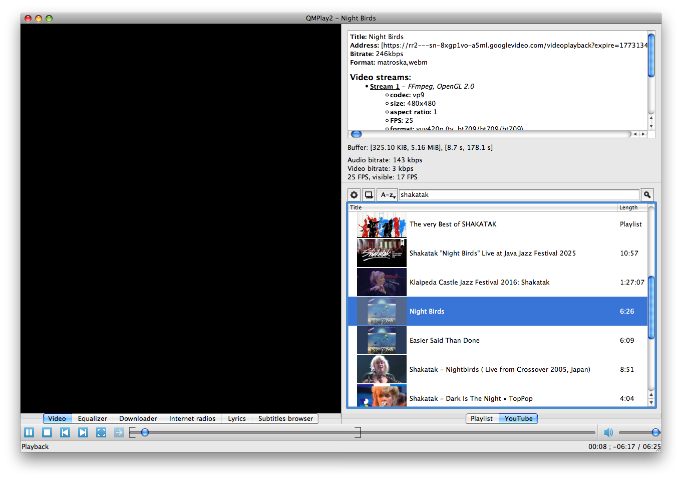

I just managed to test it today and was able to successfully install QMPlay2 on my Powerbook G4 with your changes. Thank you!
The only thing that I'm running into now is that the video doesn't show up when I try to play it from a Youtube search result but at least I can hear the audio though. Also, the same issue happens when I try to download a video from the Youtube search results to try to play it back. What I have done so far is change the video quality to 480p and left the codec as VP9 but even that did not work during playback.
I cannot remember if there was a way to fix it and I maybe wrong but I think someone else brought this up but I cannot recall.
What happens if you download and play the same video locally? If that works, there is no issue with ffmpeg and GL, and likely the problem is with too-weak hardware. (On my G5s everything works, AFAICT.)
You may try setting default format to something less CPU-intensive. Turning off video to audio sync in playback settings also helps to make it easier.
When I download and play the video locally, it works but it depends on the video itself. Because I used VLC to test it out, sometimes it'll play fine while other times it will fail to load it since it does not know the codec (usually the logs will mention 'undef' during playback).
For now, I will use your suggestions to see if it will improve the playback.
What I am interested to know if the same video which fails to stream plays normally in QMPlay2 on the same machine. Comparing to VLC is a different question. If QMPlay does not play local videos (reasonable ones given hardware; it won’t play 4k AV1 on a G4, and no player will), we got a bug to address. If hardware is just too slow to handle streaming and decoding of certain formats, there is nothing to fix about it, it is an expected behavior.

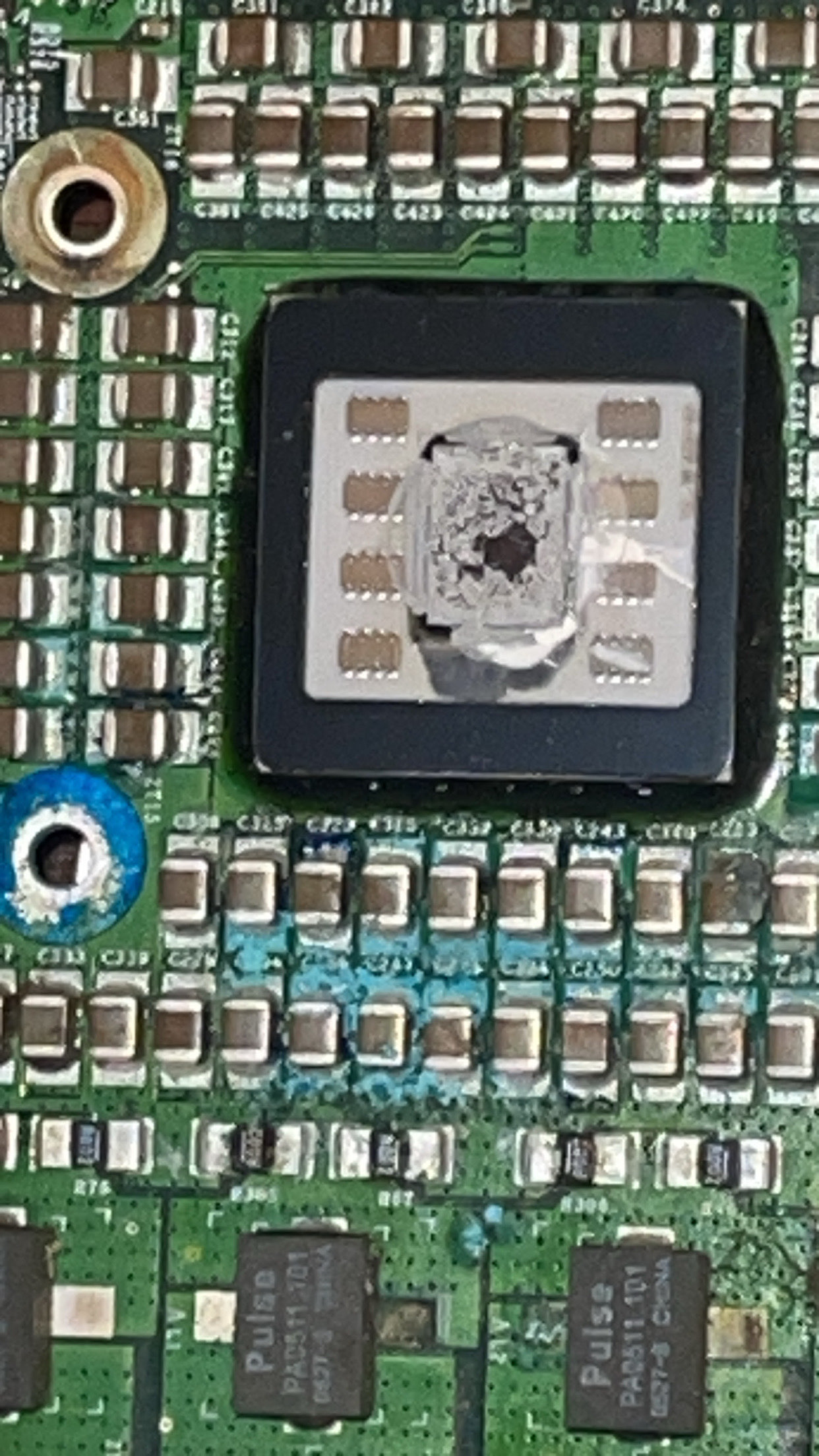

Another LCS failure to save:
Picked up this Dual 2.7 that boots but doesn't get past the Apple logo. LCS o-rings failed, didn't spread very far so this should be salvageable. I pulled the rebuilt LCS out of my Dual 2.5 and it booted right up - passes every test in ASD and works like a charm. Will use it with the current "Frankenstein" configuration until I can get the 2.7 CPUs cleaned and the LCS rebuilt.
Glad to have an extra machine for sending long builds to. This has also helped me confirm that my Dual 2.5 no-boot condition is the logic board, not CPUs (since they work in the 2.7), and that my first LCS rebuild works as intended. These are excellent thermals!
