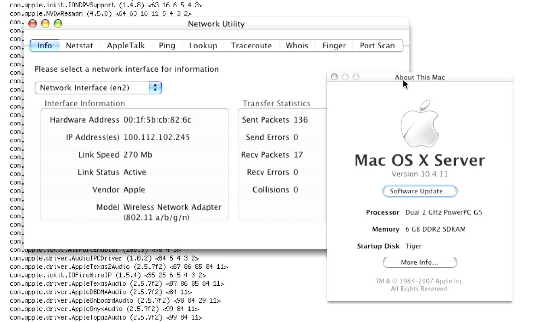

They gave Intel 10.4.11 OpenGL 2 support and a slightly newer kernel version: https://web.archive.org/web/2009122...ng/opengl/capabilities/GLInfo_10411Intel.html
PowerPC client never got that.
I assume Tiger has a software renderer for OpenGL2 in 10.4.11 server, even for PPC, though I could be wrong. I'd be really curious if someone with a G5 and a Radeon x1900 could get OpenGL 2 hardware acceleration on Tiger Server

There's a newer kernel version, drivers for a PCMCIA card that provides 802.11n wifi for PowerBook G4s, possibly newer OpenGL than Tiger Client.
It does still support G3 according to Macintosh Garden if you don't use the 10.4.7 installer, I don't know if you can upgrade to 10.4.11 or if jktwice is correct that it can't do 10.4.7 or higher at all: https://macintoshgarden.org/apps/mac-os-server-104
It does in fact have OGL2 HW acceleration and it has 802.11n support. So using, say, PowerFox on a G5 in Tiger is gonna be a lot more usable (but not that much more so. I use PF Intel and while it's awesome you still need to adjust your expectations).
@Jazzzny was curious about this initially and did spin up a quick 10.4.11 Server install and confirmed that 802.11n just needs an enabler like on Intel when the draft-n stuff rolled out.
As for the other system components it's really hard to say if the kernel is that much newer if at all and worth specifically supporting. But at the moment for G5 users and some G4 users with the 7800 GS installing this is something to consider.

The kernel is definitely newer on Tiger Server than Tiger Client - the respective build numbers are reported as 8S165 for PowerPC and 8S2167 for Intel (or Tiger Server) (https://apple.fandom.com/wiki/Mac_OS_X_10.4.11). The question is if any of the fixes for the newer kernel are relevant for building ports, which no one has tested.
