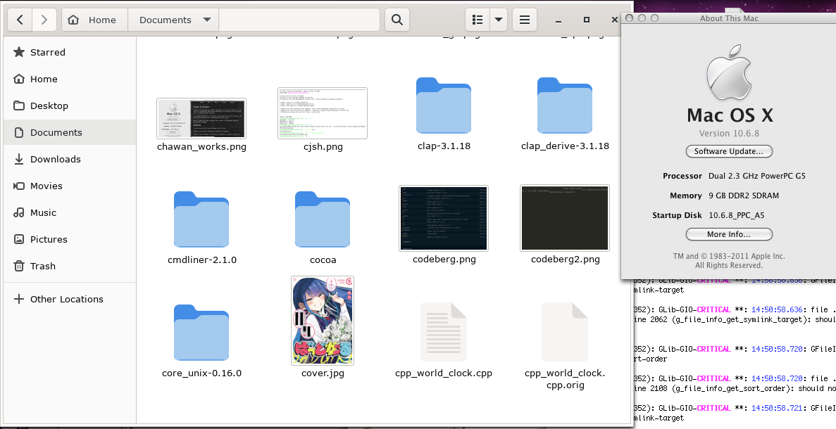

nautilus didn't start in past. I forgot the error. maybe it is fixable, I hope so. thx.
Okay, it is another dumb thing in gnome: turns out, nautilus requires an extra dependency at runtime but does not check if it is available.

I looked into building GOA without webkit, but I recall the conclusion was that it is either too painful or makes no practical sense. Though, admittedly, Gnome in general receives little attention (whether by upstream MacPorts or by me). Largely everything Gnome is out-of-date to a varying extent.
Upd. @saxfun I have fixed nautilus, I guess. Launches on Catalina now, I just need to ensure everything builds on ppc as well.
Reactions: saxfun
nautilus compiled successfully! on 10.6.8 on my A1138 I cannot see any network share on my servers. if I type smb://192.168.178.xxx the font becomes red and nothing happens. is nautilus compiled with gvfs or it the missing network capabilities of 10.6.8 PPC?
