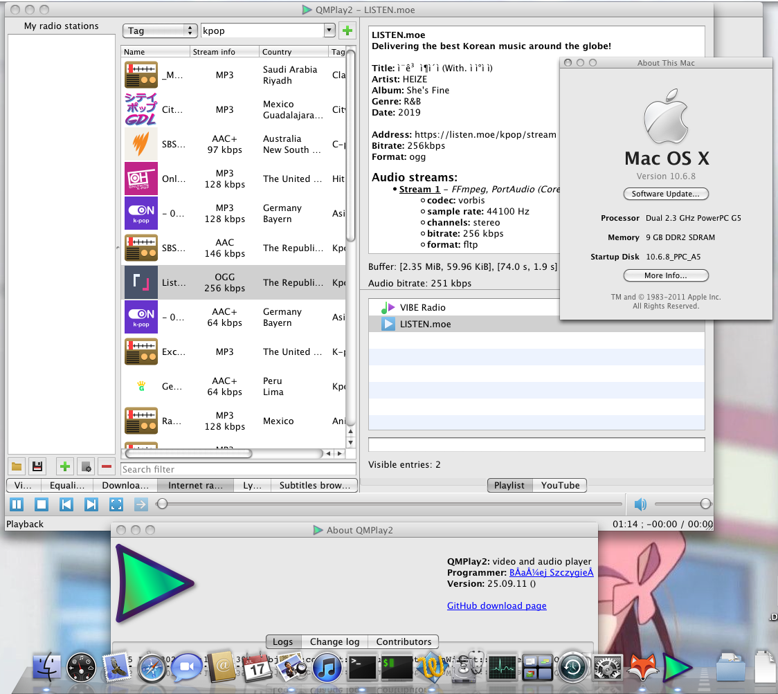

QMPlay2 25.09.11 (yes, the latest), with online radios working now:

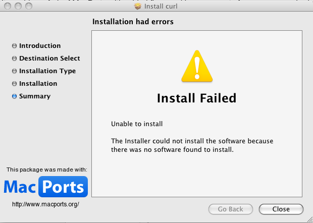

I'm trying to get Curl installed from the .mpkg file from the macos-powerpc website, but I get an 'Install failed' error. It says "the installer could not install the software because there was no software found to install".
Could you specify what system you try to install it on and which exactly pkg (i.e. link to the file, since there were more than one)?

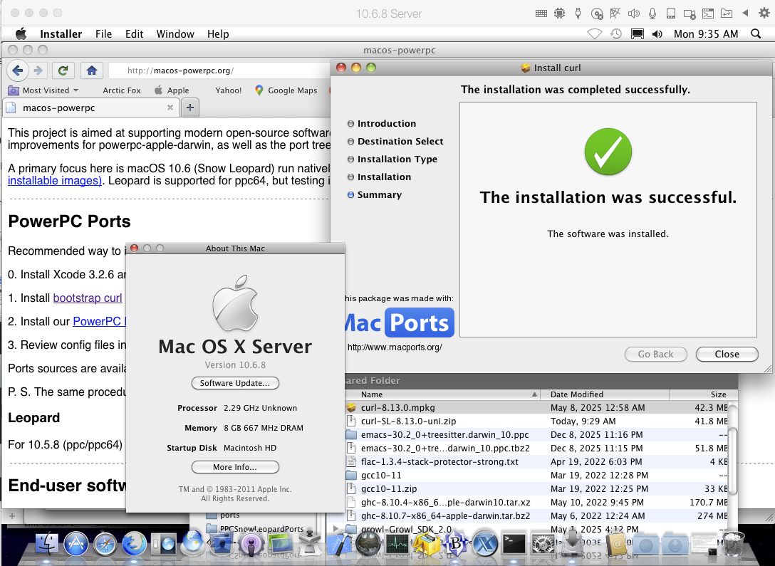

I just tried to re-install it on 10.6.8 in a VM, and it works as expected:
P. S. Since curl packages did not change for a long time, it will be surprising if they are broken, and nobody complains.
I'm an idiot. I was trying to install the 10.6 PPC package. Sorry!

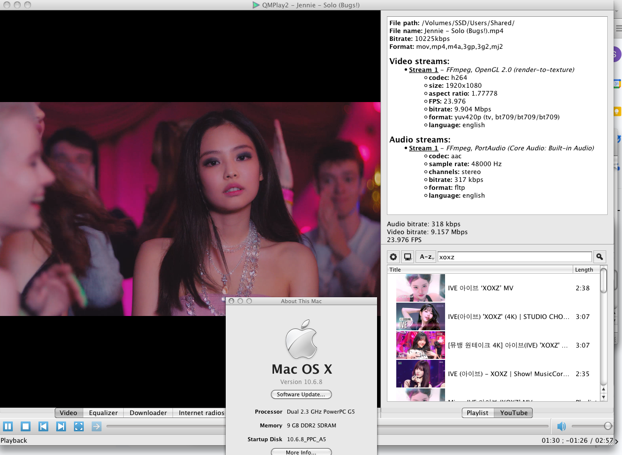

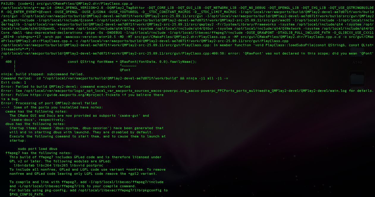

Hello everyone! This is my first time posting here but I was trying to get QMPlay2 to compile on my Powerbook G4 with Leopard v10.5.8 and I ended up getting the following error:
Before this error, I did sudo port sync, sudo port deactivate activate and sudo port -v -N install qt4-mac-devel ffmpeg7 qmplay2-devel yt-dlp and left it alone to compile for the 2-3 days before it failed. Is there anything that can be done to get this to compile?
I attached the logs that I got when the compilation failed.
Reactions: barracuda156
Discussed in https://github.com/macos-powerpc/powerpc-ports/issues/85
I will deal with this today. Fixing is trivial, I’m just not sure why it works in some cases but not other.
