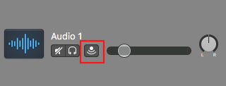

    GarageBand> Preferences: is that set to the mic you have plugged in rather than "System Setting" for Input Device?
    If yes, have you tried toggling Input Monitoring on & off on your audio track (highlighted in red below)?

    Yes, I have chosen the mic and not System Setting.
    Yes I have tried the monitoring, unfortunately that does not work.
