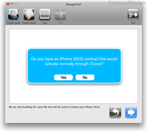

ive got a 3gs on 4.0.1, BB 5.13 and im using ultrasn0w. My phone is locked to AT&T.
I want to update to 4.1 with pwnagetool but i do not want it to activate the phone, cause i have the AT&T sim card that is needed for the actiavtion. (I do not want youtube & push problems later).
So if i choose "simple mode" and when it asks me if i want pwnagetool to activate the phone i click NO, would that still keep my old (5.13) BB ??
TNX
Yeap, that correct.
This has always been the number 1 problem with pwnagetool over the years: Incorrectly deciding whether to activate or not.
Agreed!!! I predict people complaining about this problem in the forums!
If you use a 3G you will be prompted to answer the question has your phone been pwned before at the end of the ipsw creation stage.
This does not happen with a 3G S or a 4, it just automatically walks you through dfu mode.

i thought that if i click "YES" i do have a contract the BB would upgrade....
Like the old pwnagetool:
Clicking on “Yes” will update your baseband to the latest version which will make your device almost impossible to unlock. Click on “Yes” only if you are on an officially supported carrier like AT&T.
I clicked "Yes" and my BB stayed at 01.59.00, so I can verify that it's okay to click yes. If you click "No" and you're on ATT what's the worst case scenario? Wouldn't you just have to re-pwn, clicking "Yes" the second time around?
Edit: I use ATT but waited for pwnage to preserve my baseband in case I want to unlock and sell in the future.
Yes, there are a couple of problems with the way PwnageTool does it; first of all, it makes a default choice when it should just force everyone to make that decision. Second, it refers to "hacktivation" as "activation," which causes confusion.
Really, they need to ask a clear question like "Do you intend to activate this phone using an official carrier SIM?" and requiring a yes or no answer from everyone would make it much clearer.
Maybe I shouldn't have said problem, confusion might have been a better choice. I think the program is actually fine the way it is, the problem is people don't like to think/read.
