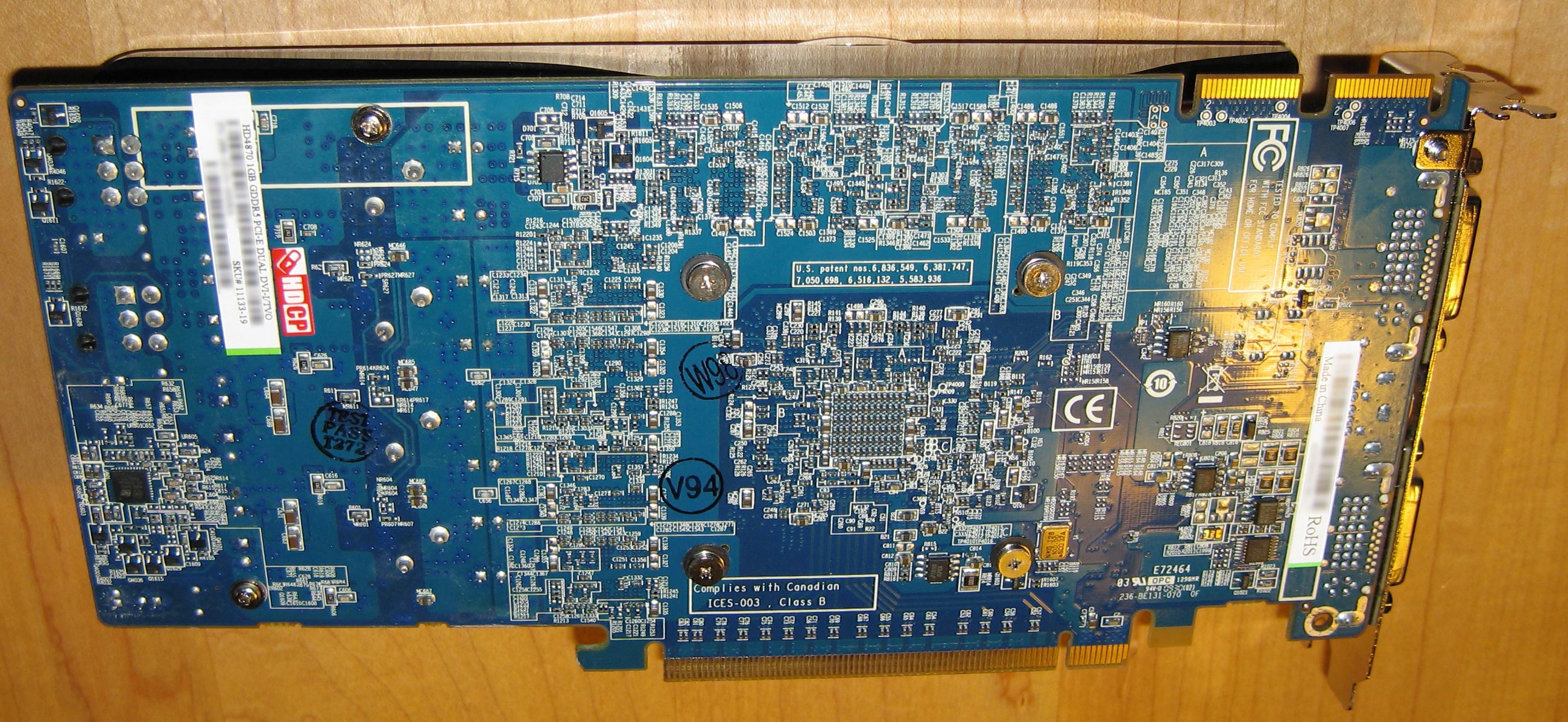

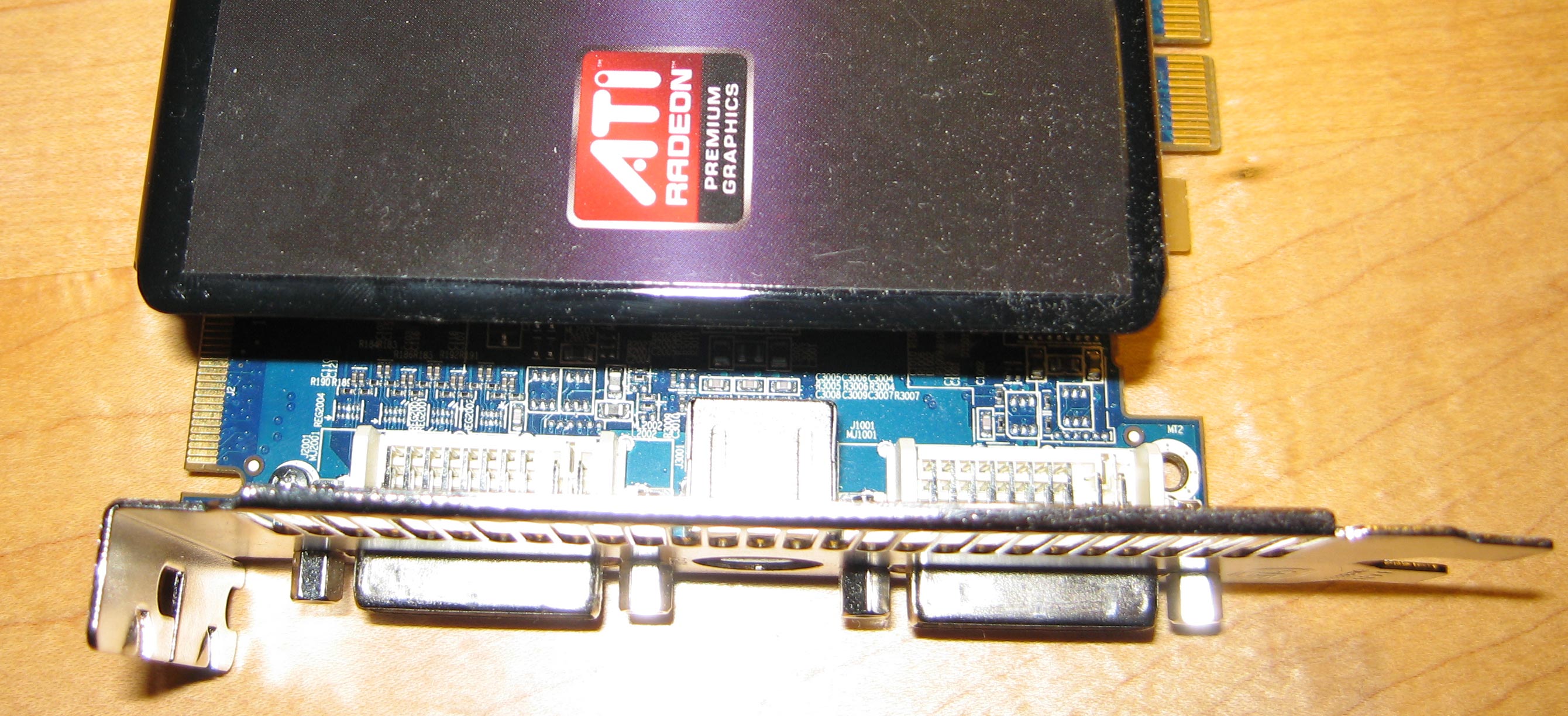

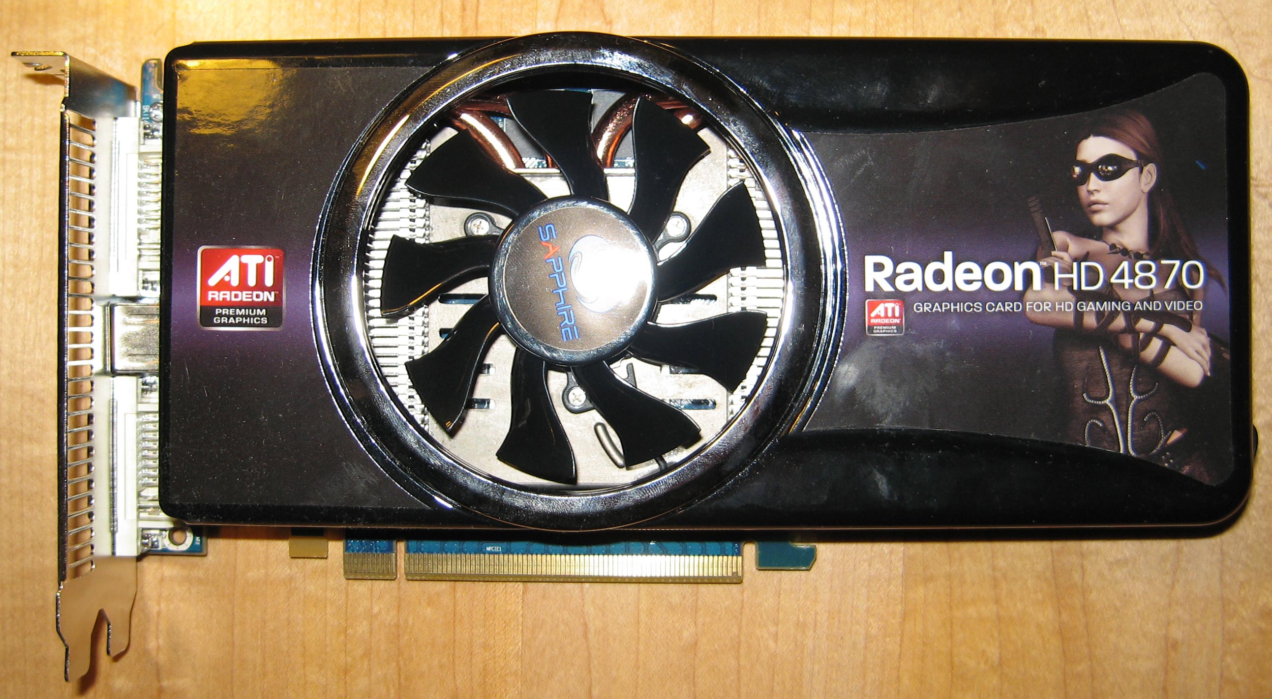

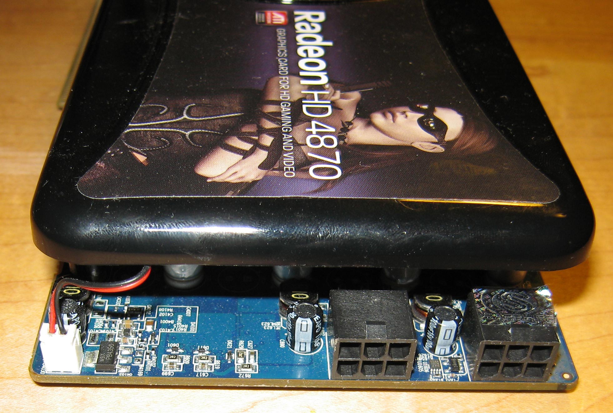

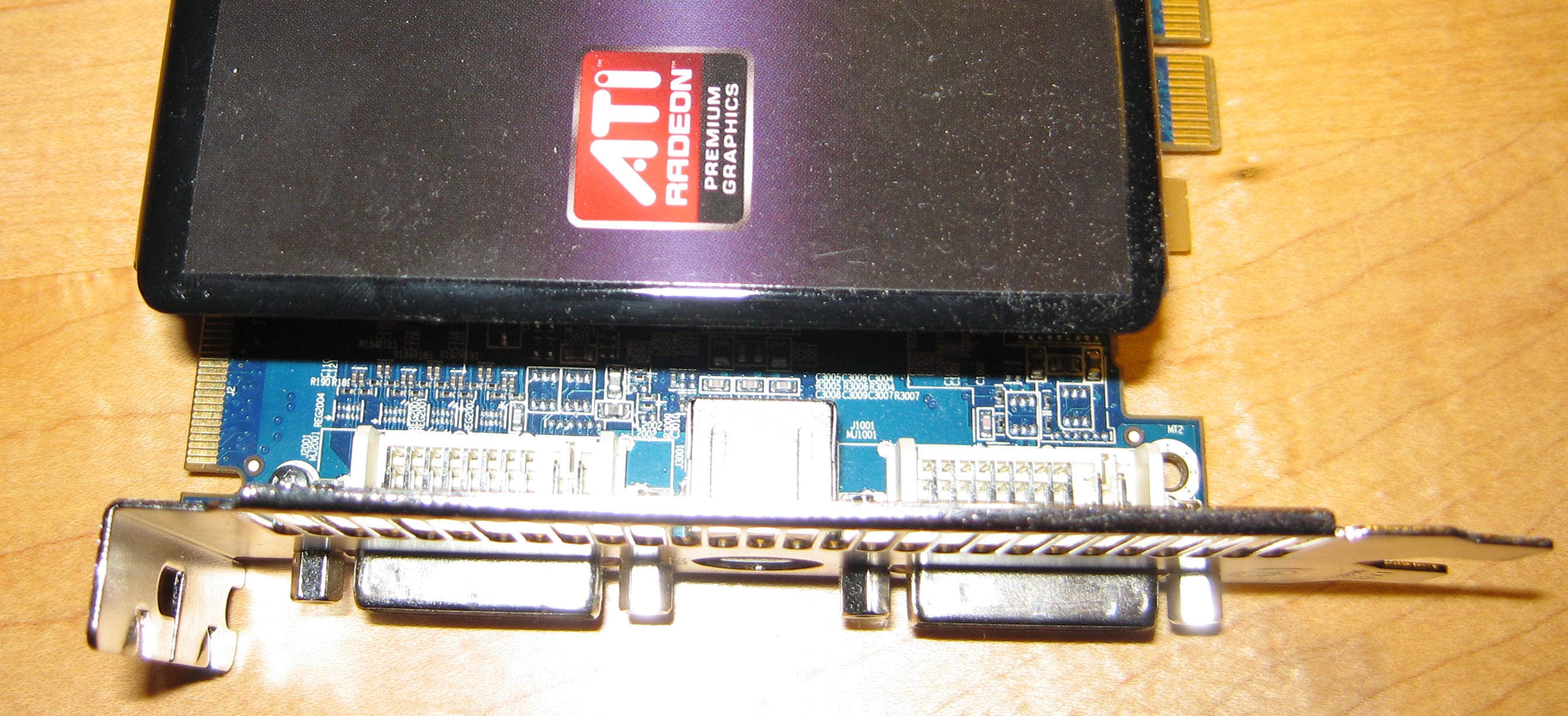

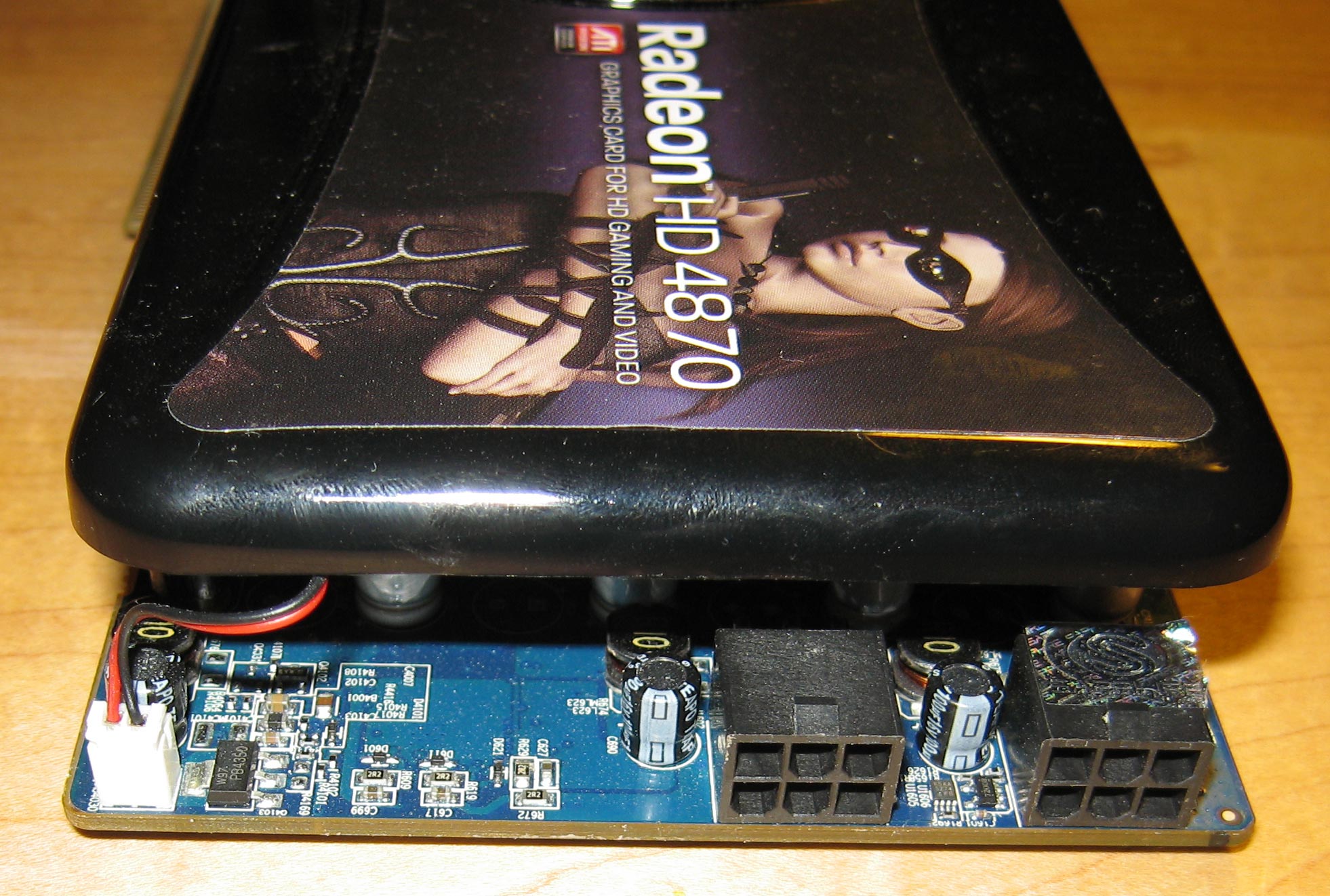

I pulled the card back out and took some shots of it. This is the Sapphire Radeon 4870 1 gb that I posted the original rom for a while back. This is the card that Rominator fixed up the rom for.
