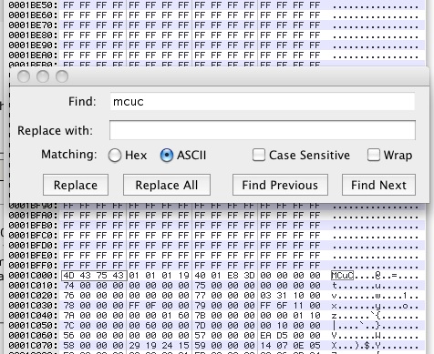

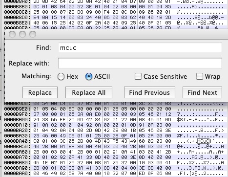

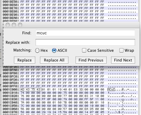

Oddly I could not find the mcuc entries the Rominator mentions in either the before or after ROM images.......
Yes, it is odd. 😕
In fact it is there twice, as it should be.
Note that the GDDR5 table opens with it...and look at the address.
Then see the other occurence buried deep in PC BIOS? Notice the address of the GDDR5 table at the begining of the line it appears in? In ROMs where the PC BIOS is too long, the GDDR5 table needs to be moved down or it gets squashed and overwritten. When you do this, you also need to change that little bit of addressing buried in PC BIOS.
ROM looks OK. Good luck !!!

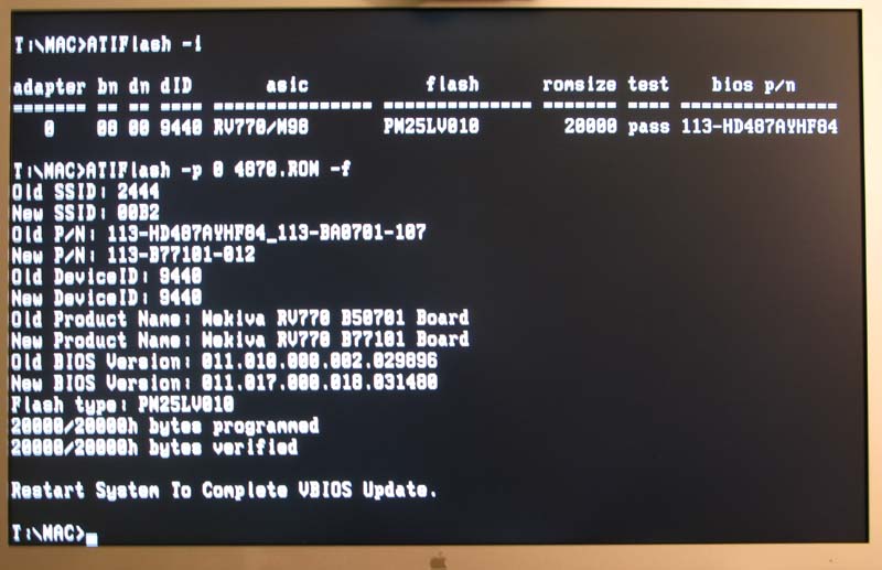

SUCCESS!!!!!!!!
After repeated frustration trying to build my own hybrid ROM, I decided to throw caution to the wind and flash my XFX Radeon 4870 512MB Dual-DVI (model HD487AYHFC) with the straight Apple 4870 ROM (4870.ROM). I used the BootDOS CD method described at Jacob Croft's site (except, of course, I substituted the 4870.ROM instead of using the rhildinger's ROM). Per Jacob's tutorial, I built the DOS CD within Boot Camp (Windows XP) while both my original Radeon x1900 (slot #2) and the XFX Radeon 4870 (slot #1) were in the computer (display attached to the x1900). I put several ROM images on the DOS CD: Apple 4870 ROM (4870.ROM), rhildinger's ROM (macxfx.rom), and the original ROM I dumped from the XFX card last night (just in case I had to flash back to it). After the DOS CD was burned, I quit Windows XP and powered down the Mac Pro (leaving the DOS CD in the drive). I then opened up the Mac Pro and removed the factory Radeon x1900 card and connected a single display (Cinema 23") to the right-most (as viewed from the back) DVI connector on the XFX 4870. (Since I was about to flash an ATI card, I didn't want to flash BOTH cards so the x1900 had to come out.) Then I powered up the Mac Pro again, holding down the "C" key immediately after the startup bong. It took awhile to load, but eventually I started seeing the DOS CD loading. Then I followed Jacob's tutorial very carefully, checking and double-checking each keystroke (again, substituting the Apple 4870.ROM). This is the final screen after the flash was complete (took a photo of the screen, sorry for the slight blur!):
I find it interesting that the New Product Name and New BIOS are higher numbers than the Old (original). That would seem to indicate this particular XFX card has been sitting around since before Apple's BIOS was released. But you ROM experts would know more about that then me.
Anyway, then it was time for the big test! Restart the Mac Pro in Mac OS X and see what happens! Happily, it booted completely normally! No error screens or warnings about power. No other weirdness of any kind. Frankly, it looked no different than had I been booting from the original x1900 that was installed in the Mac Pro when I bought it.

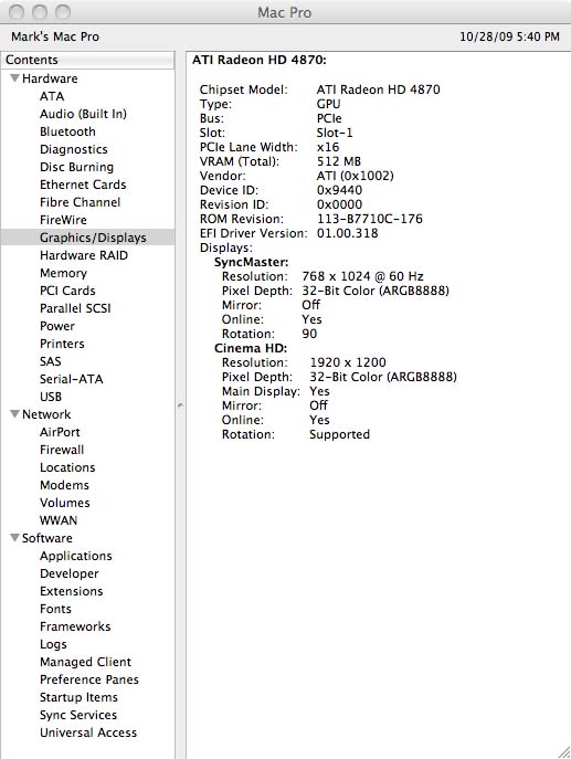

Anyway, here's a look at my System Profiler information:

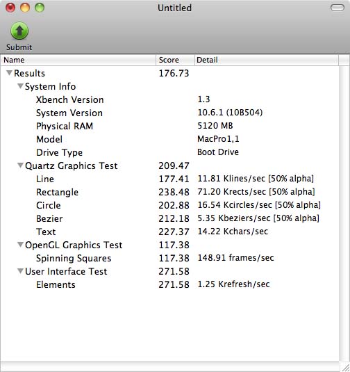

I ran some graphics tests. I was a little disappointed with the XBench 1.3 results because I think my x1900 was just about the same speed for these tests:
Here are the results using OpenGL Extensions Viewer:
Those OpenGL results are slightly slower than some results I've seen for the Apple 4870 but I think those other tests were in a faster Mac Pro (or one with more cores).
