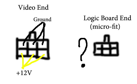

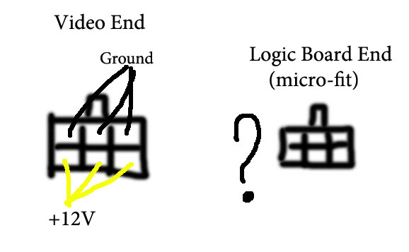

Can anybody confirm pinots of the power cable?
Is another end (mother board's) has same pinots (upper:ground, bottom:12V)?
post an image like this plz.
