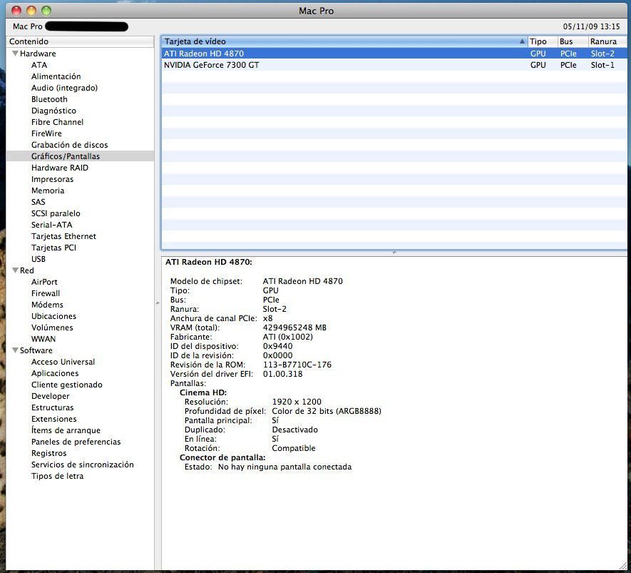

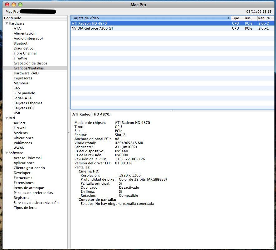

Well I paste here a photo from system, all work good but only I have much memory RAM I think hahahaha. I open the game wow and work really really good, with card 7300 I have 18fps - 22 fps... with 4870 2Gb I have 45fps - 47fps.
Now the graphic is working x8 and 7300 x8 but I think continue testing... (using) the card with your rom.
7300 is really sux (I think)... I have 8800GT upgrade for MacPro 2006-2007 but its broken.... I call Applecare but the """""support technic"""" tell me: Its false... Apple dont sell upgrade 8800GT for MacPro 2006-2007.... in Spain we have really noobs on support technic and dont know the products of apple..... I eat me 8800GT broken.. I think change chip bios... but on this moment I use 4870 2Gb with 400000000000 Mb RAM 😉
We can read no monitor connected but I have a DVI monitor apple
Im sorry... the words in Spanish.

I'm guessing you are having a RAM bug. Good for you, that it shows + 400000000, cause if it showed - (minus) you would not be able to start games.
Since games are working, the reported 40000000 ram is only cosmetic error, your card should not have any problems. Felicidades.

Hi Cindori thanks for your comentary 🙂
Just in the photo have 4294965248 MB RAM, Im playing 40 minutes in wow and I have 0 problems on this moment. I think continue all day (maybe I can)... The next Step is change heatsink of memory in the card for other more fine and later remove the card 7300 and try use 4870 in slot 1 x16 🙂
