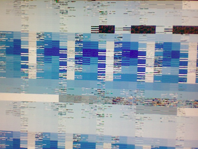

Ok, just threw in all of the kexts at once and rebooted with the GT120 still plugged in via DVI and the Vapor-X 5870 via HDMI. Both are connected to the same display via two different inputs.
Aaaaaaaaaaand same problem as you, Rominator. At least... I think so. Its detected, and outputs... but the mouse cursor is the only coherent thing on the screen. Same deal no matter what output I use (2x DVI, HDMI, Display Port - although I don't have the right stuff to test the display port). Same deal if I remove the GT120 completely.
System also hangs a LOT with the kexts loaded - I assume its trying to send certain tasks (image viewing / hardware acceleration / etc) to the 5870 and thats when it hangs.
yay !!! im not crazy or (especially) incompetent !!!
your desc & pic are EXACTLY what hapens with me
oddly enough, if a 2600xt or 3870 is in, it won't load x3000 and the 5870 displays images PERFECTLY, all res's available, just no qe/ci

Still a messy screen.
If I remove x3000 kext and reboot, screens clear up but just as frame buffer, no 3D.
Hopefully someone with better knowledge of differences between Hacks and Macs can figure out what is so different that Hacks can run 5870 trouble free and Macs can only run as a simple Frame Buffer with no 3D or OpenGl or CI or QE.
IOReg dump is while running Mini extensions and frameworks.
Currently, I have to say that 5870 on Mac Pro is still a dream for future.

I have an ATi Radeon 5650 Mobility and it's listed in the ati5000controller.kext (0x68C11002) and I was hoping there's a way I could help out with an ioreg dump but I'm unfamiliar with the procedure for ioreg dumps.. I'm running 10.6.4 on a Gateway NV5909H Laptop and used iBoot to get it setup.
Right now it loads fine if I just do the latest aty_init.kext but of course no info is injected into my system profiler. Loading with the ati5000controller.kext, atiframebuffer.kext and atisupport.kext it will load in but then no display or in verbose it just gets stuck on console. If I try with the x3000 kext plugin and bundles it will either kernel panic or give me a very corrupt screen like The Rominator posted.

It's disturbing. What could be the difference between Mac Pros and hacks at this point? I thought that once the card is initialized (it is, right? Otherwise it shouldn't provide any image), Macs and hacks should behave the same. 3D acceleration working on hackintoshes proves that the drivers don't need an EFI on the card.
Hopefully, new Macs with radeonHD 5 series will help to clear the issue.
Rominator, any way to change resolution on the messy display?

I can log in from a Macbook via Screen Sharing. Everything is glacially slow, but I was able to get to desktop. On the 30" it was unrecognizable mess, but via screen sharing desktop showed up, but with some minor artifacts. I was able to switch to a lower res which showed up on the 30" after a couple minutes.
The feeling is that the machine is fighting off an endless string of errors and is barely able to keep running. I was unable to get it to switch back to 2560 x 1600, mostly because I ran out of patience.
It is quite frustrating to be so close. I can have a cleanly drawn desktop via the 5870, it shows in Profiler corectly, but no real 3D.
Screen sharing is dog slow when GPU acceleration is absent. It may switch to software mode or something. I experienced the situation in my Mac Pro with an unflashed PC 4870.
It's interesting that some hackintoshes show the same symptoms as Mac Pros do, but not with the 5870 apparently.
It really looks like a driver issue, but it's not clear why acceleration works on hachintoshes with the same card. Has this ever occurred in the past, with another GPU?
