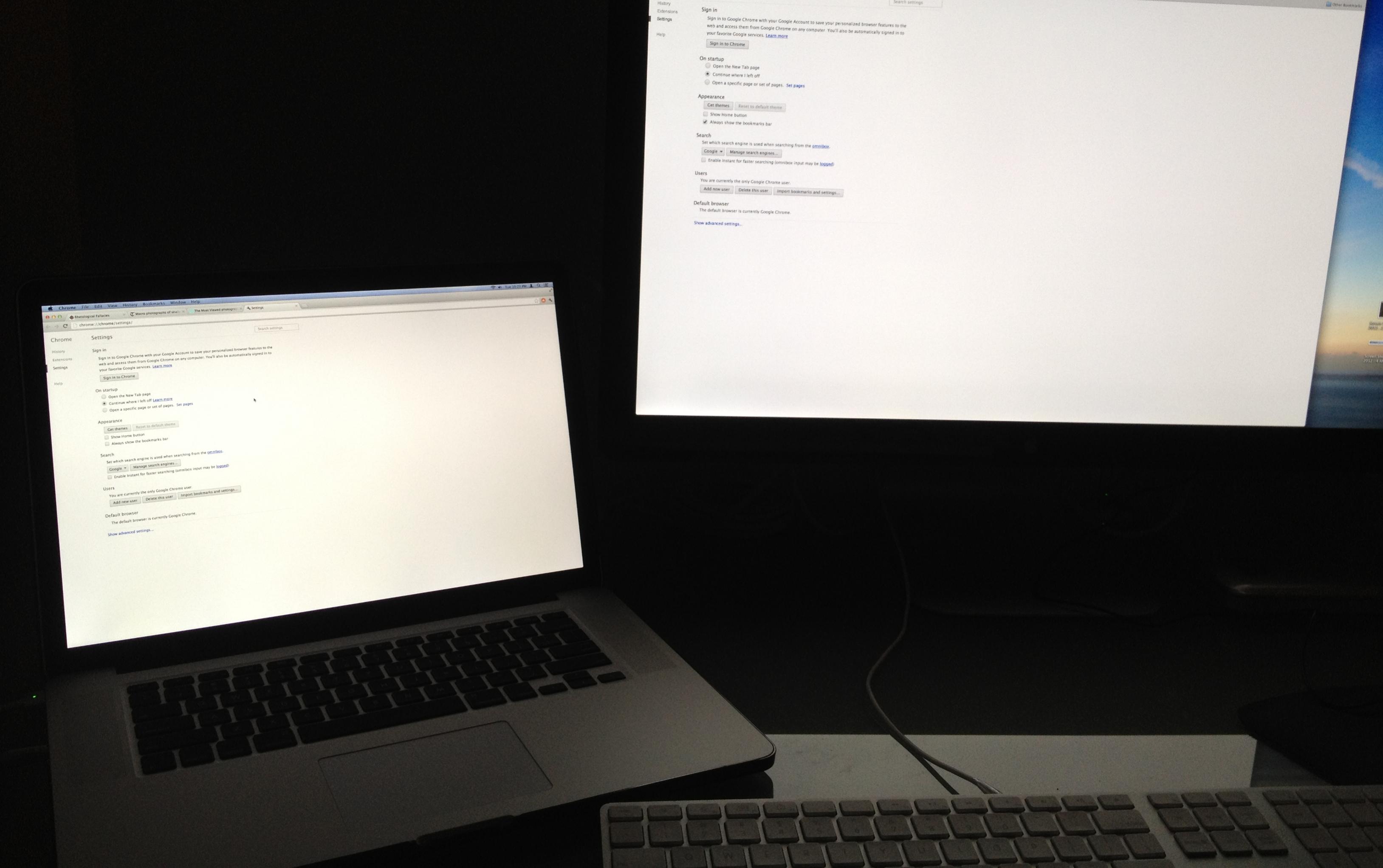

Attached an image of my rMBP next to my TB display, both using their default profiles.
Does that look out of whack to anyone?
That's about how my rMBP looks compared to my 27" iMac. But without a reference white to compare to, who knows which one is more "correct?"

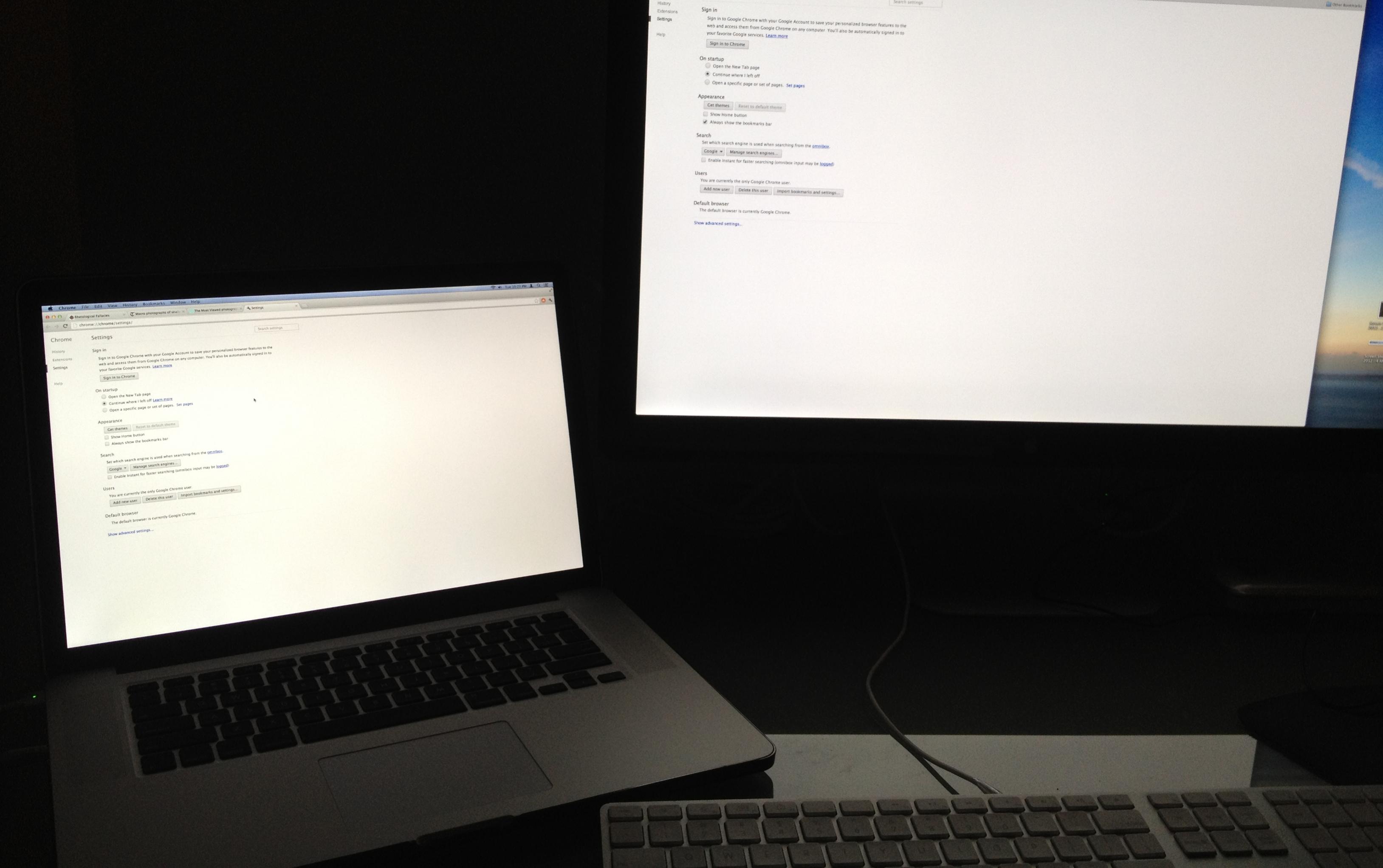

I had exactly the same scenario. I got apple to replace my rmbp. My new screen is a much better match - Replacement rmbp not yellow at all
