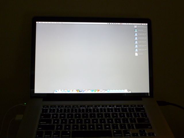

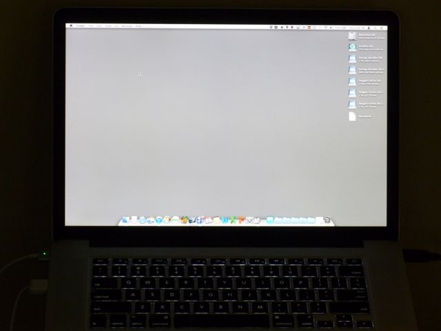

Here's mine up close:
Here it is again farther away:
The color/brightness gradient to me looks much more obvious in the first picture than the second...and honestly, I had to change the background color from light to medium gray to get it to show up even this much.
Since the difference in angles between the your eyes' line of sight and the edges of the screen is much greater when you're close to the screen compared to when you're farther away, I'm not surprised that color gradient/shifts are more pronounced up close since (at least with my display) I can detect a pretty significant color shift over the entire display as I move my head side to side.

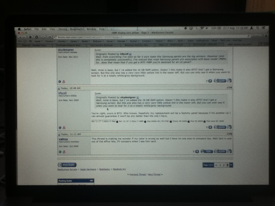

Well, mine is base, but I´ve added the 16 GB RAM option. Doesn´t this make it also BTO? And I got a Samsung screen. But this one also has a very very little yellow tint in the lower left. But you can only see it when you want to look for it at a totally white/grey background.
You're right; yours is BTO. Who knows. Hopefully my replacement will be a Sammy panel because if it's another LG I can almost guarantee it won't be any better than the one I have.
This thread is making me wonder if my color is wrong as well but I have no one else to compare too. Well he's in and out of the office lots, I'll compare when I see him next.
Edit: Only have my iTouch on me:
