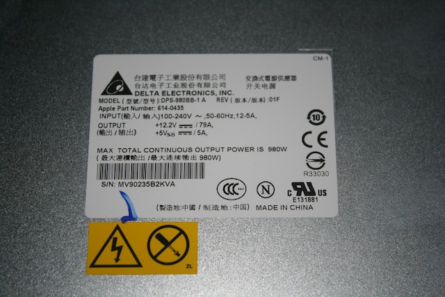

The maximum power output of the 2009 Mac pro's PSU is 980W, and according to this maximum power consumption of the standard 8-core Nehalem is 309W, and of the standard 8-core Harpertown is 318W. Deduct the power of the GT-120 about 60W, We have about 730 W to spare for graphic cards and add-on stuffs.
So extra power supply is not needed for crossfire. I don't know if the 2 PCI-e cables can handle two 4870s using Y split cable in a long run??
I am about to purchase another 4870 and I just want to know if the the Y split cable works, or I need to get juice from different source (e.g. SATA).

Y split cables work with my 4870s in my 2006 Mac Pro. People did report some stability problems with sucking power from the SATA cables to power graphics cards before although I ran one of my old 3870s from the SATA cables and didn't have any problems. That was back when I hadn't bought the right cables of course.
You're right that these power supplys can easily handle the wattage, the question is if the PCIe connectors can deal with all that power going through them. Its so far so good on my end and like I said, people have split them before to power things like GX2s for Boot Camp before and didn't have any problems.
