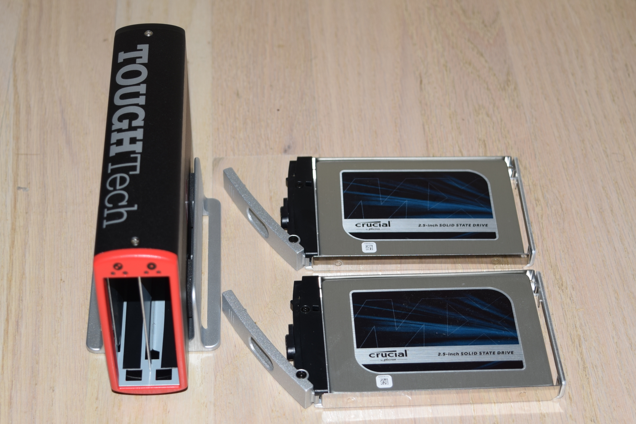

I wanted to get a rugged dual bay enclosure that runs over USB-C which also allows hot swap, for my need which mostly store RAWS externally and Lightroom catalogs internally. I’ve found the CRU ToughTech Duo C Storage Enclosure (2x 2.5" to USB 3.1 Gen 2 Type-C). I loaded two 2TB MX300 in there in JBOD (there’s RAID 0, RAID 1, JBOD, and SPAN). Works great, only thing I’d change is changing to Samsung drives, Crucial is not that fast. When connecting through USB-C, it’s bus powered flawlessly. This enclosure is literally built like a tank.
Since I don’t intend to intensively delete and rewrite data on the SSD, OS Trim isn’t necessary. If you use the external drive as a scratch drive, TRIM is highly recommended, which I’d point to Angelbird drive. I have no idea if the X5 supports TRIM.
