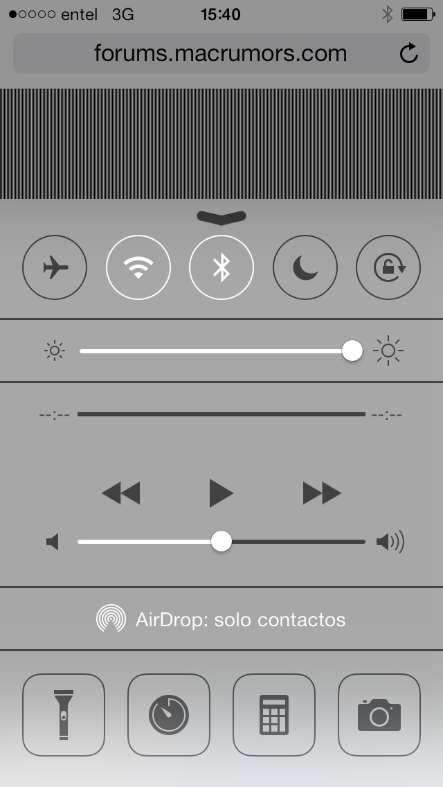

The wierd thing is that when i do press with the finger to make appear the save button the screen does a flicker very perceptible, BUT only on the section where the image is set, for example, the safari URL bar and the status bar, with the options bar below and the save option does not flicker... i have heard that if the screen flicker its done in movement doesnt count... and the blur effect while saving i believe obviously do some sort of movement on the screen that maybe produces the flicker

i dont have an ipad, But i did the experiment dimming the screen itself, the result is no flickering at all, but in maximun brightness the screen does a flickering in the section where the image is... idk how to explain it, let me think how i can show it
Ok, Well i have the picture, the screen only flickers where the test image is, when i turn off the brightness the flicker dissapears, but while its in maximun brightness the flicker is very perceptible. i did it with control center coz it do the same effect as holding the finger to make appear the Save options
