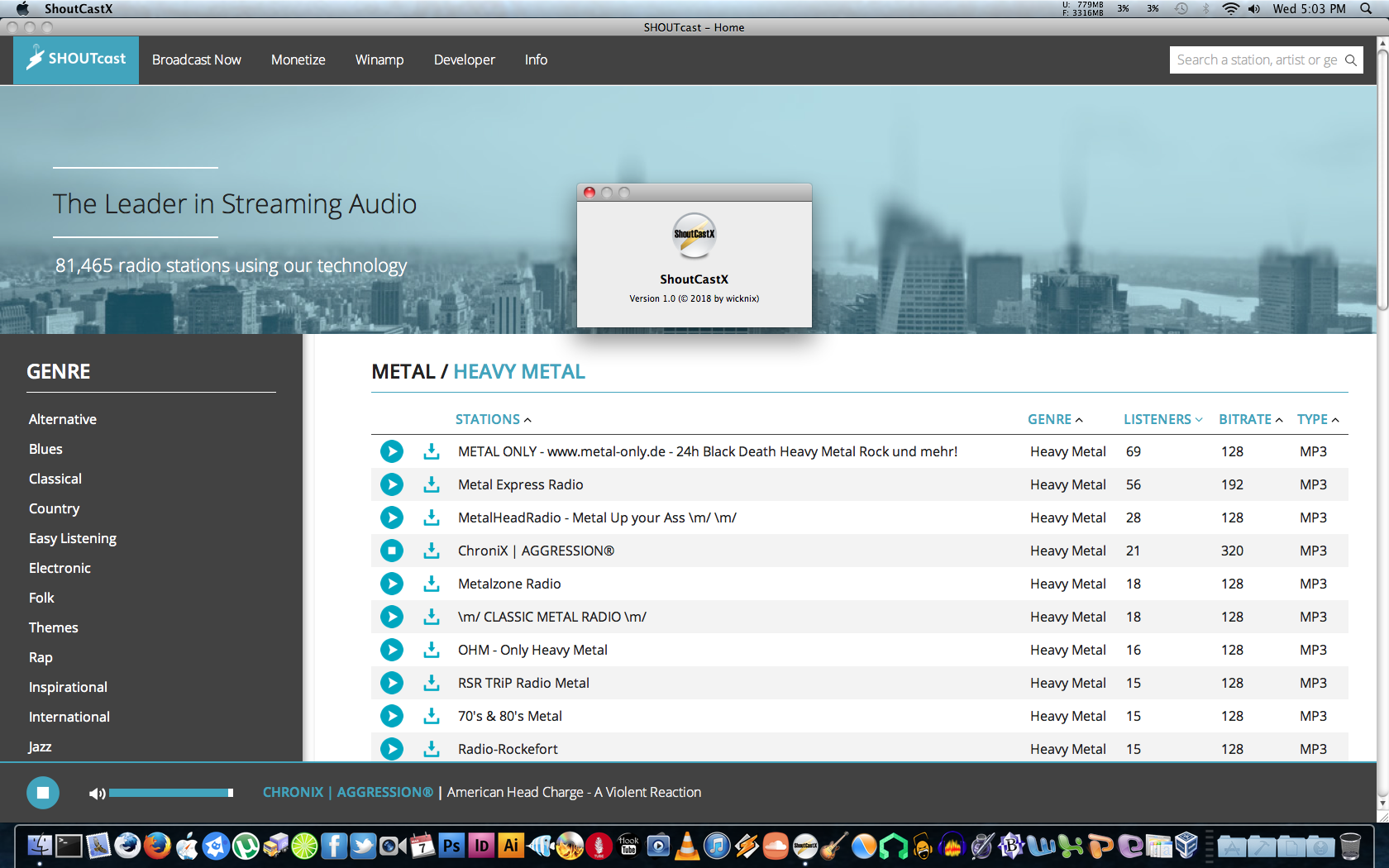

ShoutCastX - Internet radio via shoutcast
