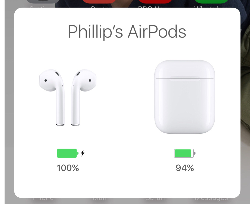

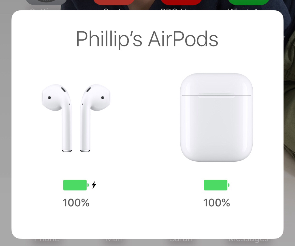

After some further testing I am now convinced the AirPods themselves are constantly draining the case. I charged mine so AirPods and case where 100% but at no stage, even after being left on charge, did the 'lightening bolt' charge icon disappear from the AirPod card as pictured below.
After removing them from charge I let the AirPods sit in the case unused and checked them again in an hour.
The AirPods were still at 100% but still indicated they where being charged. The case had reduced to 94%
The above post is exactly how mine behave. I believe this is a fault surely.. At the rate these drain while in the case we will need to charge the case every 2-3 days even if you don't use them. Hopefully Apple will acknowledge this and I'm hoping its a simple firmware upgrade which I hope can be done using the phone and OTA. (Lots of hoping I know!)
