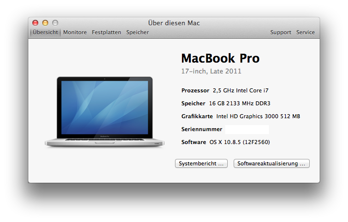

It was not El Capitan's fault by the way. A clean install of 10.8.5 can't login to iMessage too.
Going to Yosemite now 1Password 4 is too unconfortable, I need some of the newer features.
Edit: I had to create an app-specific password for iMessage and Facetime on Yosemite and it's working now.
