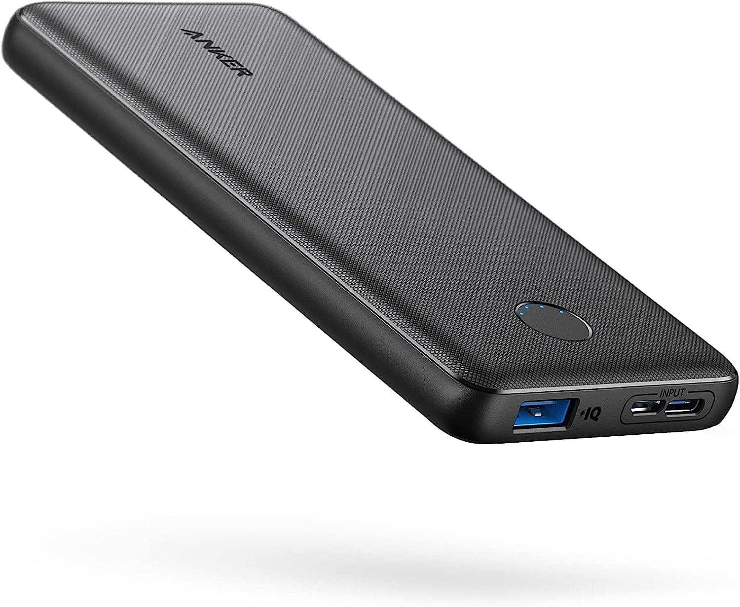

One way out could be that the devices (powerbank, AirPod case, phone etc) reports their maximum battery capacity in the communication between them. A wall plug would just report infinitely high. Charging directions should always go from highest capacity to lowest.
Edit: and if it’s to devices with identical capacity (like two phones) charge would go from highest charged to lowest. It’s not that difficult
Why does the phone need to ask? The device I connect it to needs to know what it wants to do. So, the port should be labeled "out" for output and "in" for input. And if you want a switch to deterime? Then place that switch on the powerbank. I don't want to have to answer what to do on my iPhone each time I connect it to something. It is something I absolutely hate about Android trash.
So you have on both sides one USB-C port which is an in AND output port. How should they know in which direction the current should flow? Percentage of battery capacity? But maybe you want to take a charge from your power bank even it’s already at 20%. I think you need such a switch.
Like I wrote the port should be clearly labelled, or there should be a switch on the powerbank. This can be a "firmware" switch, so that if it detects an iPhone (USB-C has an identification pin, so that isn't that hard to do) it should act as a host port. (which can be done with the CC1/CC2 pins of the port)
So you buy a power bank to charge your iPhone and you end up charging the power bank with your iPhone?
It is clearly a software issue and Apple is again showing us how many idiots are working in the software department nowadays.
No, Anker is at fault, not Apple… 🙄
