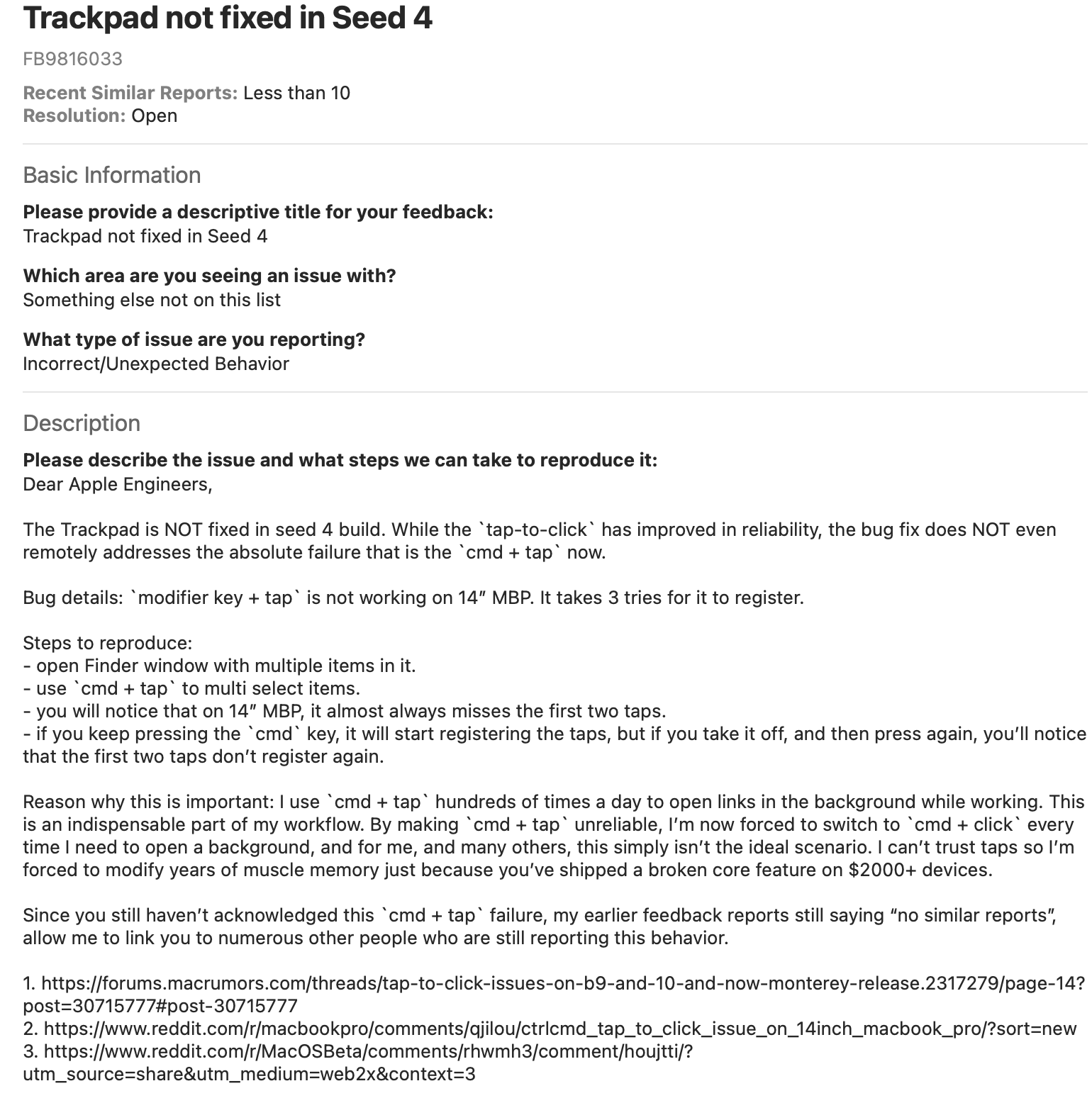

Just updated to 12.2 beta. Confirming that it does not fix the broken `cmd + tap` behavior. The feedback assistant does still say "potential fix identified for a future OS update" so let's see...

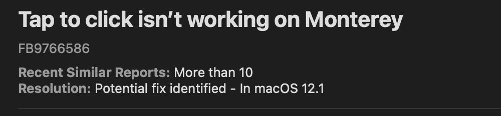

Update on this: the status changed to 'potential fix identified - in MacOS 12.1'. I'm already on 12.2 beta and the 'cmd + tap' is obviously nowhere near fixed. Not a good sign, and I think this likely means that they've called it a day after "fixing" tap to click in 12.1 (which only fixed the taps, not the modifier key + taps on 14")
Time to get rid of this device and revert to MacBook Air or something? Don't have much hope that they're working to fix this anymore. All the other reports I filed specifically about `cmd + tap` issue are still saying "no similar reports" :/
I have the same update. Potential fix identified. In macOS 12.1. Maybe we should open a new feedback with Cmd + Tap to click isn't working on Monterey 12.1 in the title ?

My new report, filed on Dec 20th, went from `recent similar reports: None` to `Less than 10`. Please keep reporting this issue folks, it might be working!
To respond to a few previous comments:
  • My first MBP 14" had the same Diagnostics report issue related to the trackpad. Since I was one of the first customers to take delivery of these new devices, there weren't any reports of the bug just yet. So, thinking that it was a hardware problem, I immediately returned and replaced my device with an identical 14" MBP. Guess what, it had exactly the same issues, but it didn't show up that trackpad reference code in the diagnostics.
  • Since then, hundreds of people started reporting trackpad bugs, which were actually affecting many of the older M1 and Intel devices too. In 12.1 seed 4, Apple did address the `tap to click` being unreliable, and it got better. Since then, at least it does not miss the taps themselves on my 14".
  • However, on many 14", including brand new ones sitting at Apple stores right now, you can go and press `cmd + tap` to, say multi-select, or open a YouTube video in the background, only to watch that tap fail 2 times and only registering on the 3rd attempt. Multiple people have tried going to the store and have confirmed this.
I filed the new feedback report with this title because Apple replied to most people's previous feedback when they released seed 4, and asked us to file new feedback with this given title if it wasn't fixed.
As Traffy suggested above, if you're facing the same issue, make sure to file a report with the title "`cmd + tap to click` is not working in seed 4." And feel free to copy my bug report if you find that easier.
