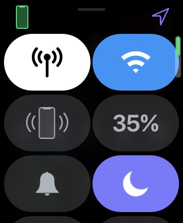

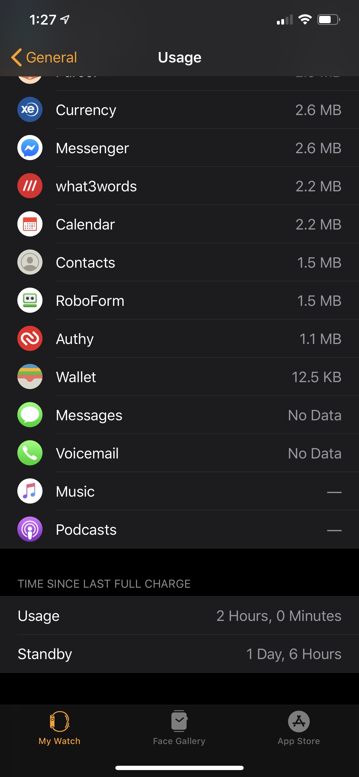

So far on my S5 44mm using 6.1 beta 3 battery life seems very good so far.
AOD on
Background app refresh on for everything
Noise app off
Raise to wake on
Brightness halfway on the iPhone app or 2 bars in the watch settings
So far 2hrs usage, 1 day 6hrs standby and I still have 35% left to go 🙂
Do not disturb is turned on in this shot but I only turned it on 1hr ago, have had quite a few notifications and texts through since taking it of the charger.

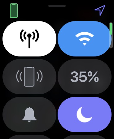

AOD on
Noise app off
Raise to wake on

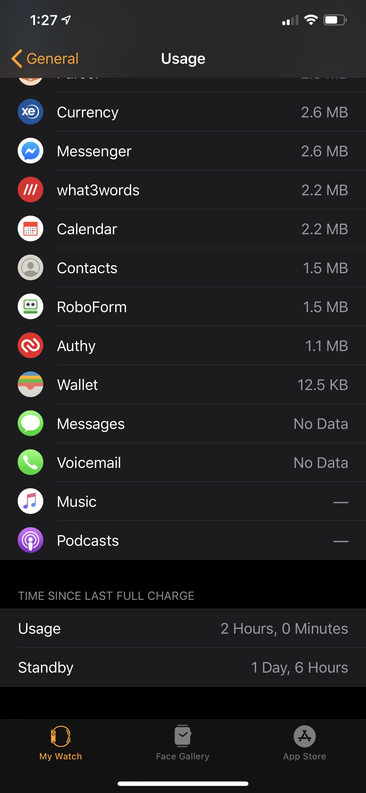

I wonder what is classified as “Usage”. That is a very low number for the total number of hours you used the watch. Mine reaches 2 hours in about 5 or 6 total hours and that is with barely using any apps (if any)...
AOD on
Noise app off
Raise to wake on

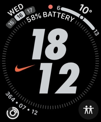

At the moment infograph modular with,
Carrot weather
Built in apps
Messages
Timer
Battery
Activity
Date
So far with 14% left I'm at 2hrs 39mins usage and 1 day 15hrs standby.
