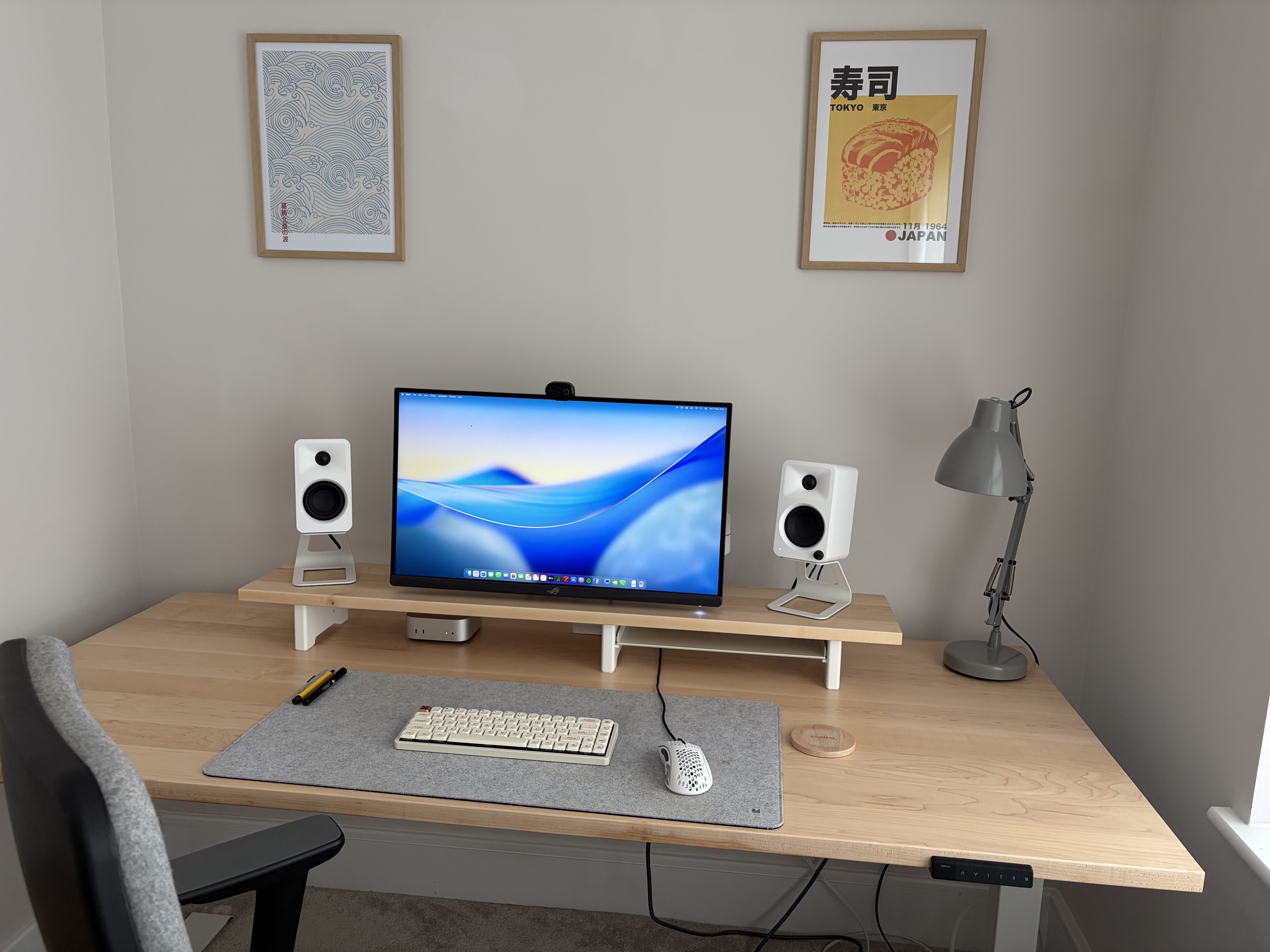

Got to say I've been enjoying the Asus XG27JCG I received earlier in the week. It replaces a 27" 4k 160hz monitor so I'm doing some comparisons between them. I can see the extra clarity of the 5k but with my eye sight and sitting back in my usual position I'm not sure if it's that noticeable or worth the £700. I'll swap back to the 4k monitor soon and make a decision if I'll keep it.
Well, with a matte finish, that’s certainly understandable.
Gloss isn’t possible for me, my office has 2 large south facing windows to the right.
How is the brightness on this monitor during the daytime? The official specs only mention 350 nits which is obviously lower than a 500 nit Macbook, or a 600 nit Studio Display.
