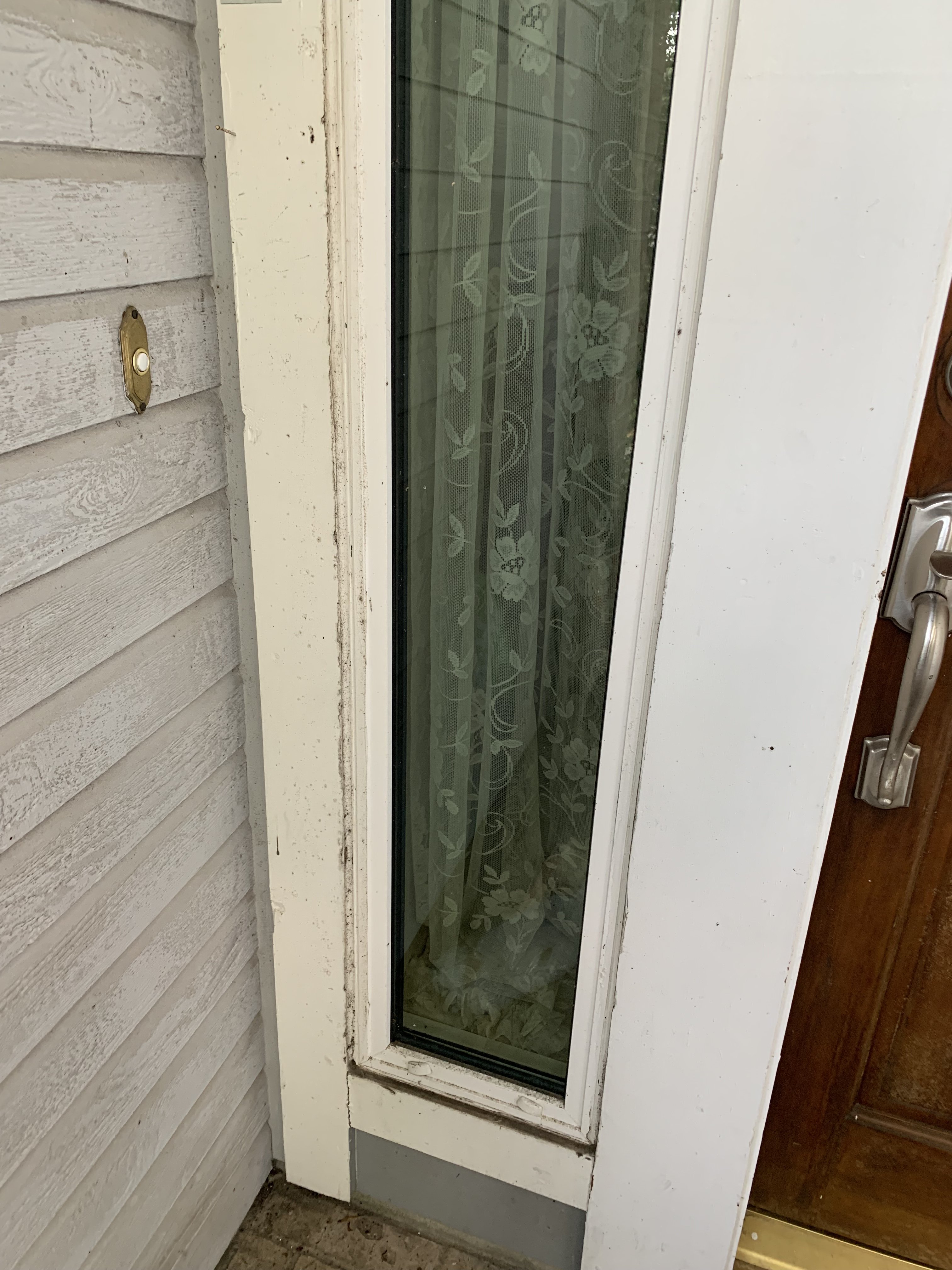

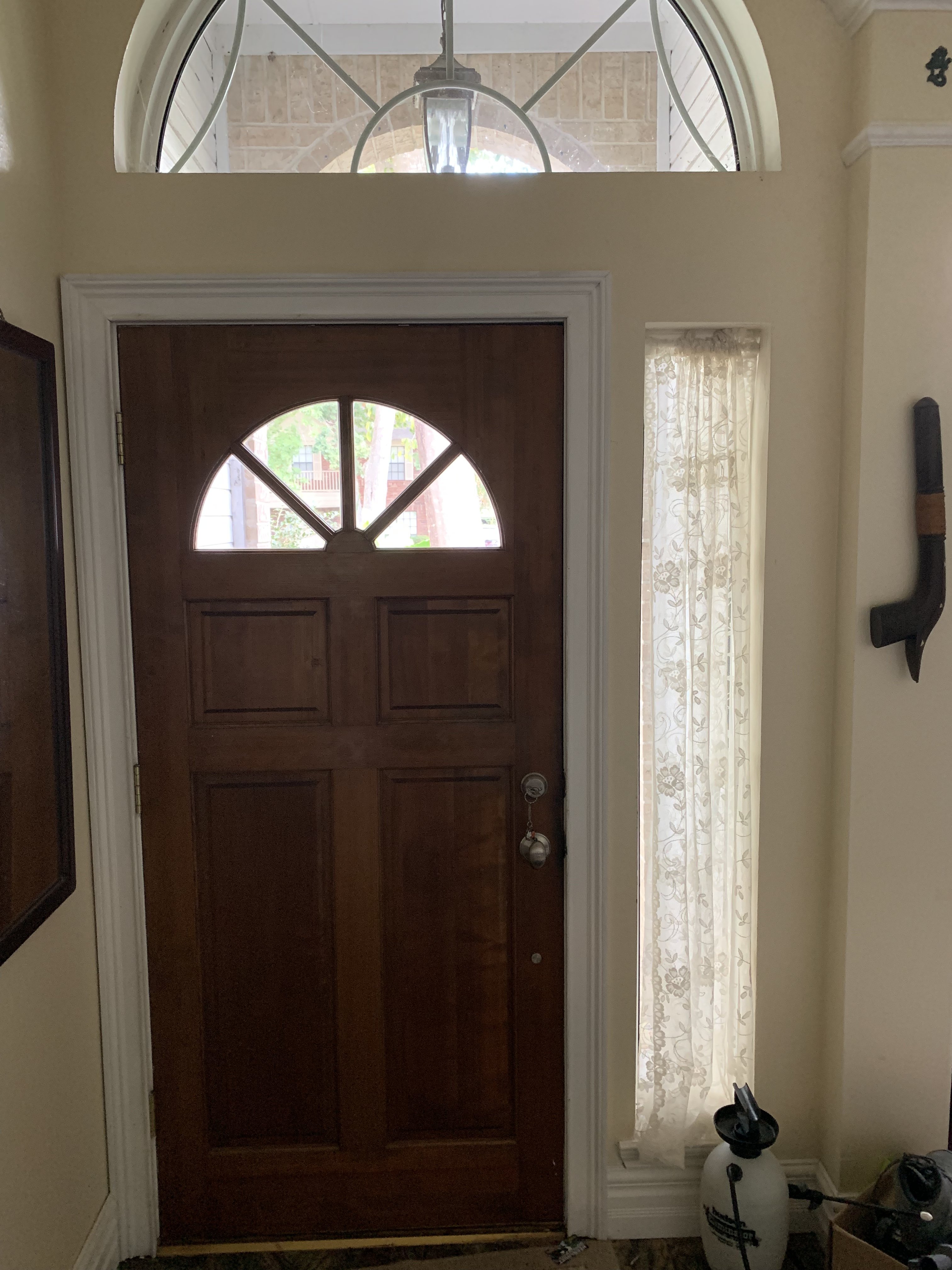

I want to install a video front door camera/doorbell with 2 way audio. I picked up a Ring 2, but when I got home I was faced with this:
The window by the door is an issue, because I’d like the camera doorbell by the White front door frame, between the door and the window. The challenge is to get the wire over there without running exposed wire. I’ve used a wire snake to run wire before, but there are obstacle in the way, namely the window. My wife wants no exposed wires.
Option 2 would be to gouge out a groove in the wood molding, to later to be filled and run the wire 3” to the corner, and then mount the Ring2 in the corner facing out, towards the street not on the side wall.
Anyone have a Ring 2? I’ll research it, but does it have a fish eye lense? If it’s in the corner, I want to be able to see people standing by the front door and don’t know if the corner would be a good enough position, with the camera facing the street. I plan on calling Ring tech support, if they have a number on Monday.

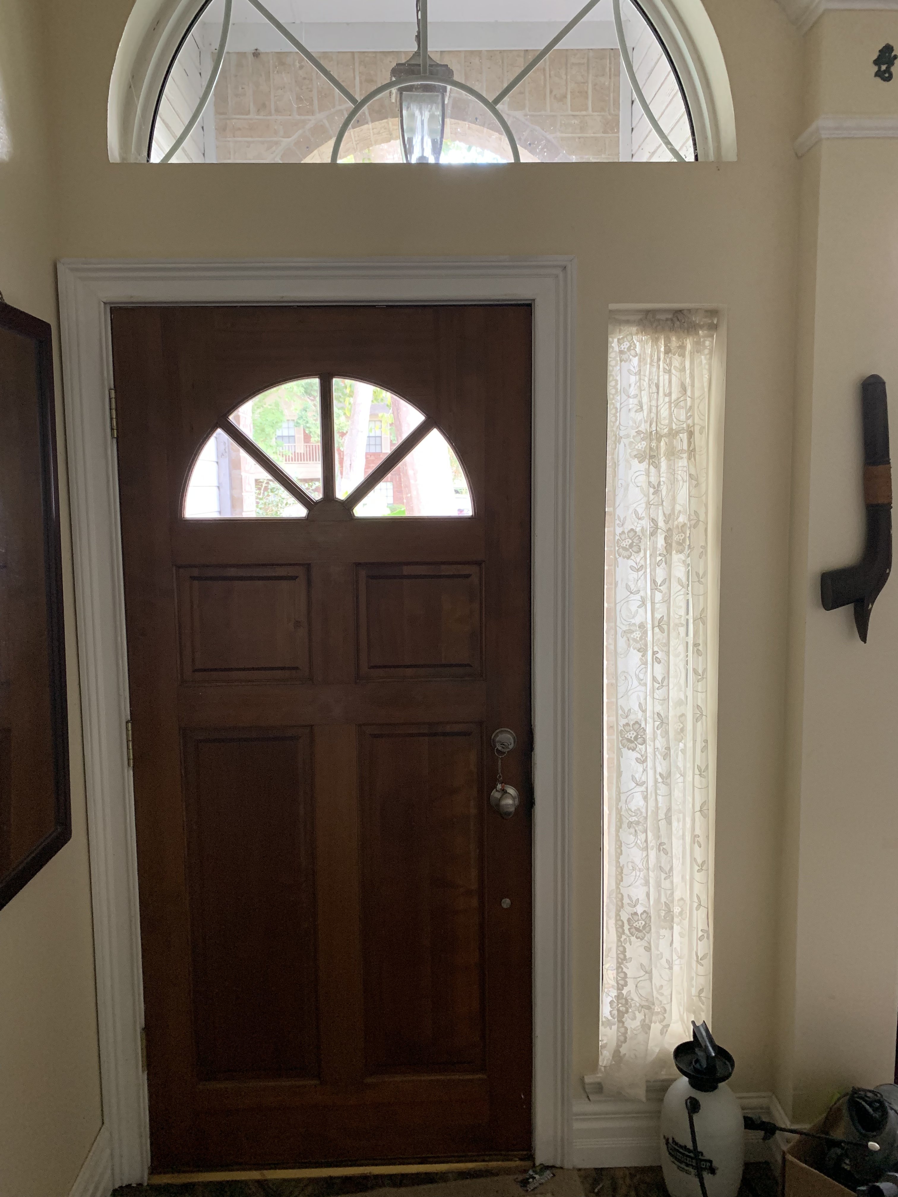

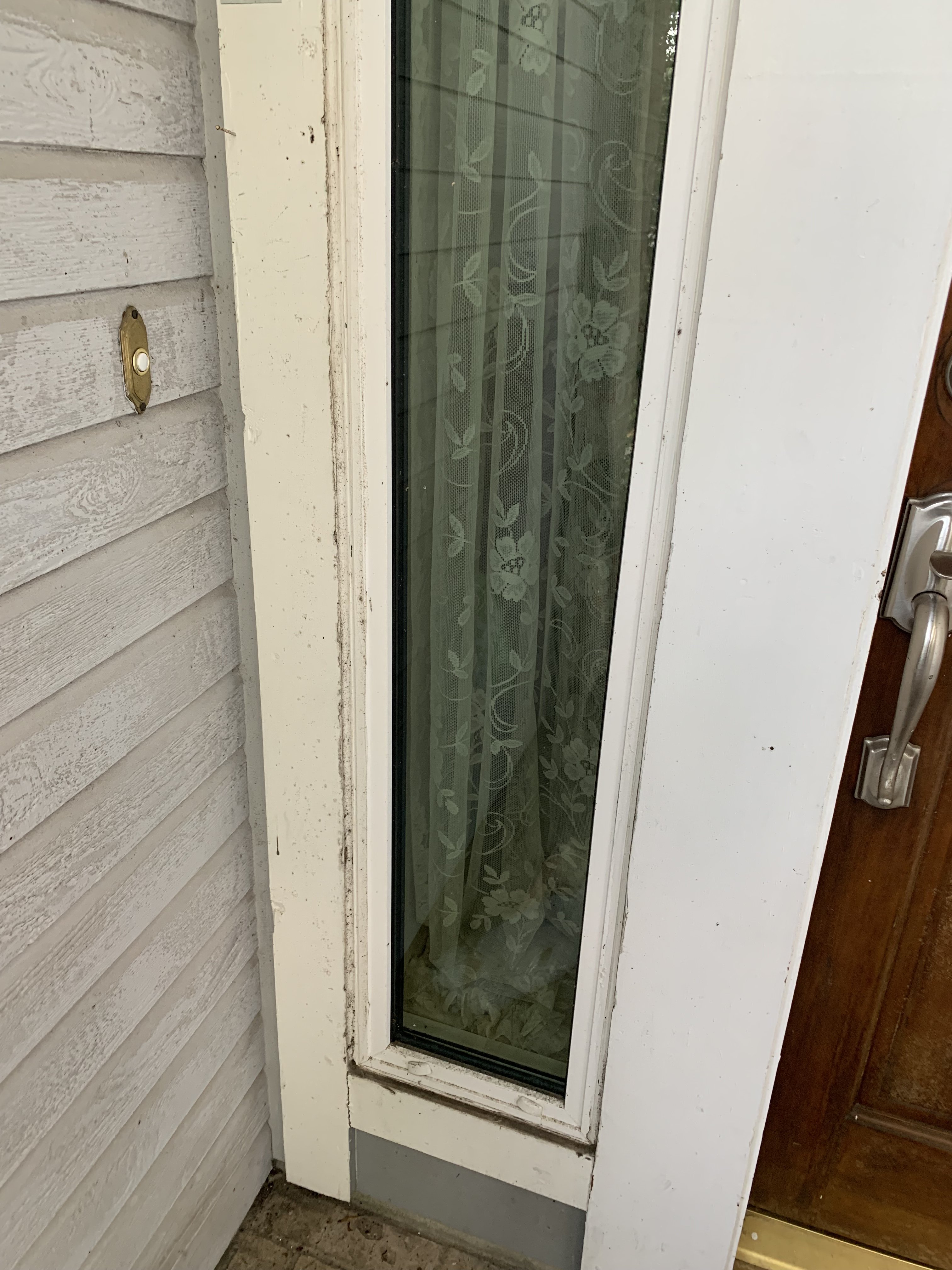

Thanks!
Why not attach a piece of wood behind it at maybe 45 degree angle? I’ve been thinking of getting one for awhile, but as I’m after a new house I guess it can wait!

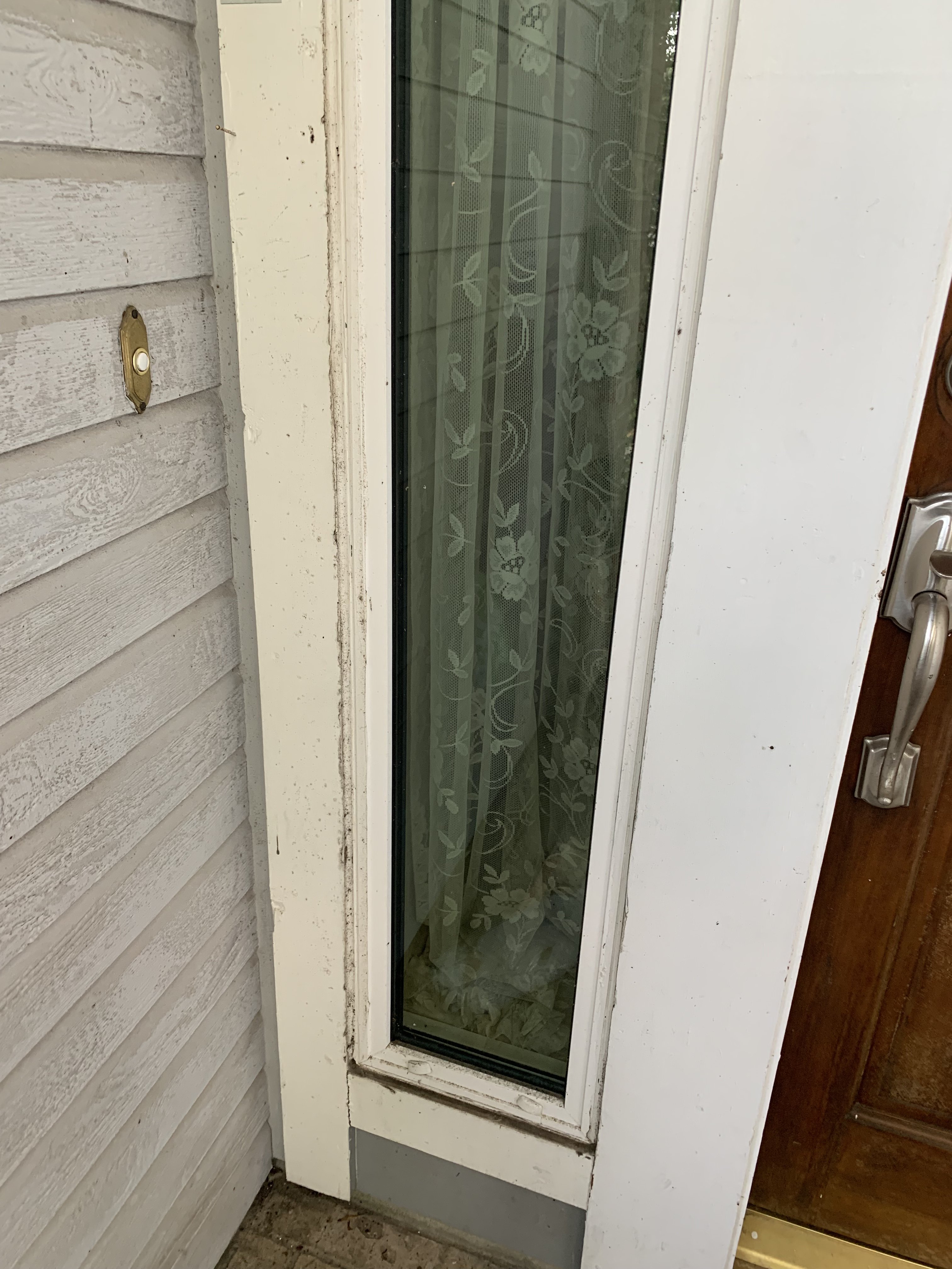

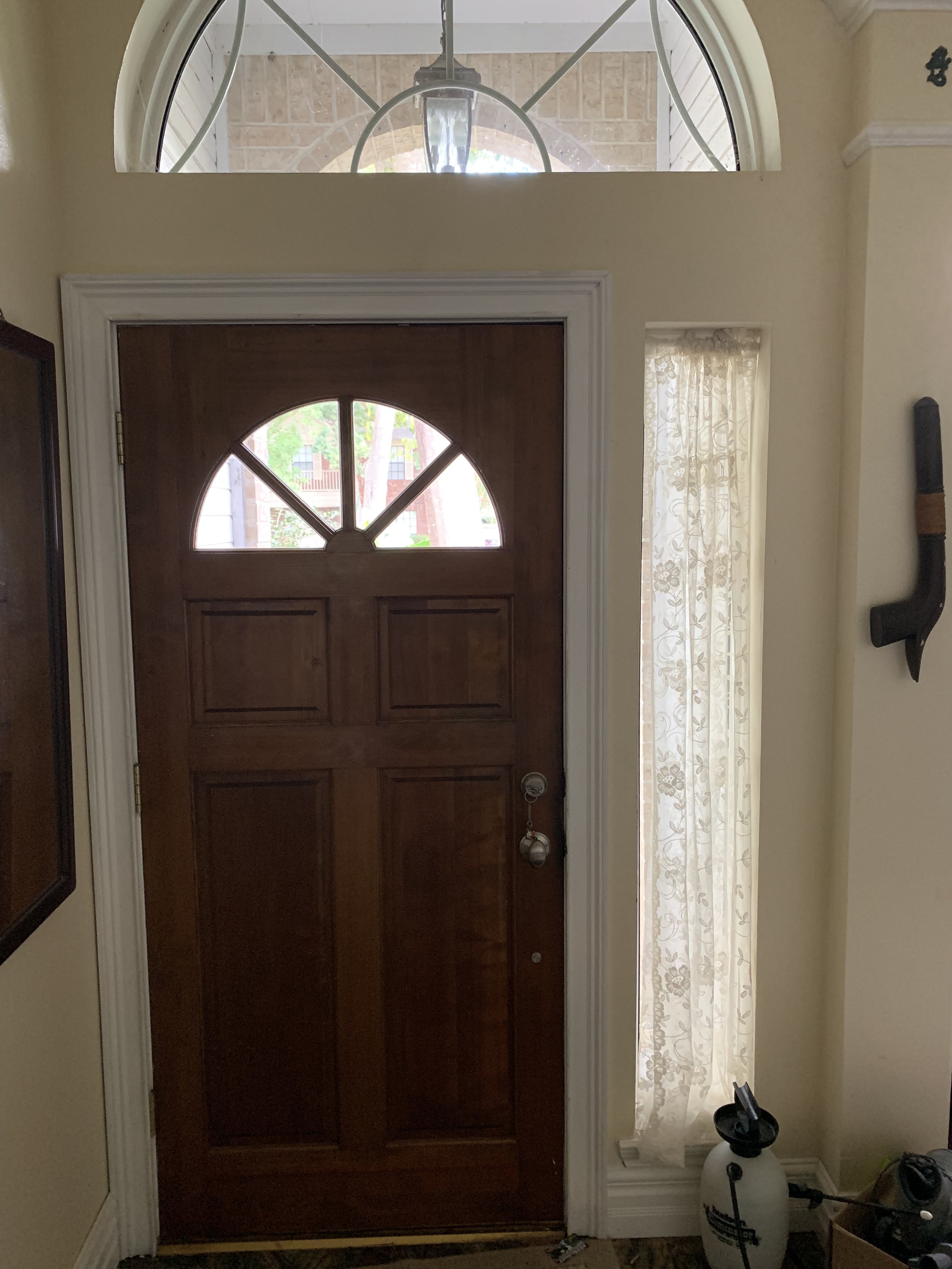

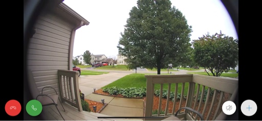

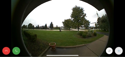

Mine is next to the door on the angle mount. You get almost a full 180 degrees on the camera.
On the 2nd image that’s my office running on battery. It’s been going for just over a month. I’m at 71%. You can do 3 months pretty easy on that one. It takes about 5 hours to charge the battery. You can also just get a 2nd battery and a charging dock and swap them when needed.

Getting these to work through a front door can be difficult. Really any exterior wireless camera can be difficult. Depending on building materials. I've found sometimes access points five to ten feet away can't get a sufficient signal through the exterior wall to Ring devices. Depending on building materials.
Your best bet for an interior access point. Going by the pictures you provided earlier would likely be the wall by the front door. So it is mostly just trying to get a signal through glass or a wood door.

To recap: New install, I could not pull up a live stream video on my Ring 2 Video doorbell.
Our house has an open floor plan and although there is an open straight shot hallway to the front door, there is a wall right there parallel to the hallway that separates the kitchen, and I believe because the router was in a cabinet right next to the wall, and the device is the corner of the porch in alignment with this interior wall, this is what causes interference in the signal to the device.
After figuring out I had a weak wifi signal at the device, I spoke with Ring Support and discovered there is a RSSI reading with in the Ring App for the device, which basically tells you how strong the wifi signal is at the unit. The tech showed me where to find it, and they already knew because they can get readings from the device. The RSSI on this device was -62. I was told anything less than -60 (greater - number) is bad. I was told I needed to order a Ring Chime Wifi Extender ($49) to boost the signal.
On my own, I moved my router from a small cabinet by the fireplace, (door is usually kept open), in close proximity to the TV mounted over our fireplace, and moved it to sit on top of the cabinet. Then I tested the live stream feature again and it was still a no go.
So I ordered the Ring Chime. But then as I was leaving the house I decided to push the doorbell and see what happened, and a video of me popped up of me standing on our front porch. Ok that was strange because I could not command a live stream from the app without getting an error message.
So I called Ring Tech Support back, and when I tried Live Stream while talking to them, it popped up and I discovered my RSSI reading had rose to -55! Most likely it's because I took it out of the cabinet. I guess it took a while for the unit to adjust or something. So it's working.🤩
Now I have to decide if I should keep the Ring Chime Wifi extender. I suppose it would be better to keep it if it raises the RSSI signal even more, it would be better not to be on the edge of reception.

I’ve got my Ring 2 installed and functional. Did you take these pictures? If so, from within the app or another phone?
I purchased a Ring because it was there. 😉 if I had not been impulsive, I would have checked out a Nest to compare before hand. As is, I have no regrets so far with my choice.
[automerge]1570062450[/automerge]
These are from within the app. I screenshot my phone while viewing the live feed.
