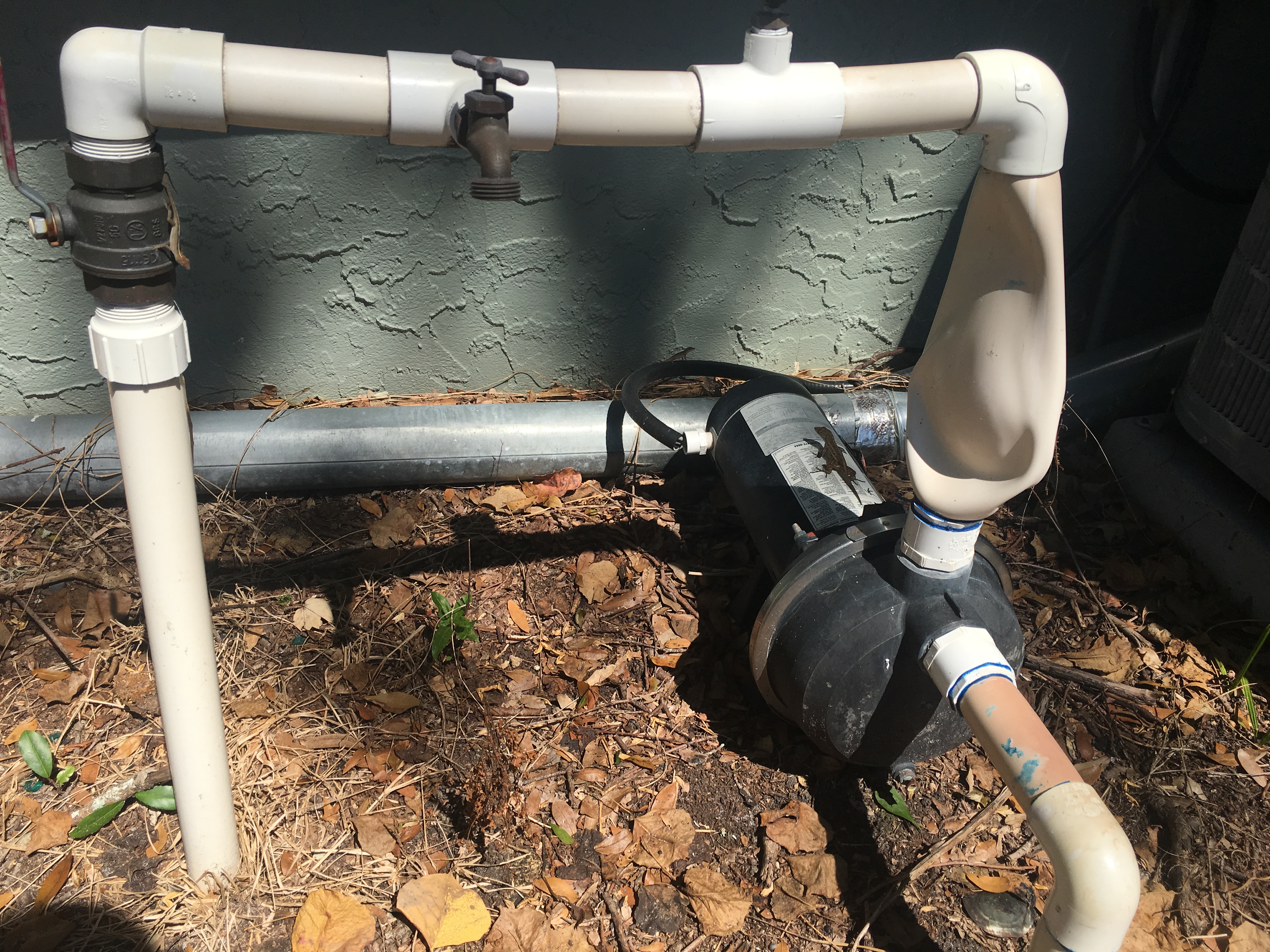

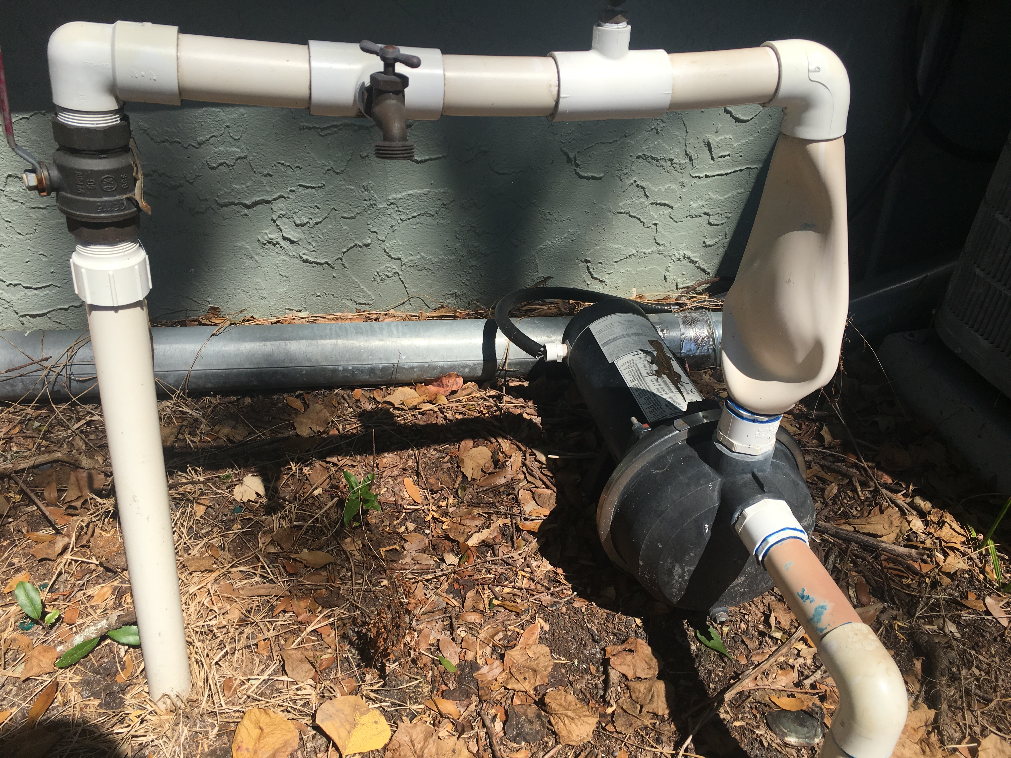

I got lucky and thankfully didn't need to replace the pump. While this is a shallow well pump for sprinklers...
-i would look into getting a filter (made for residential irrigation) if your using water from a shallow irrigation well.
-remember this type of well water is NOT portable for humans or animals.
-Have the pump intake down 2/3 into the expected water level so it will not in take big chunks of rock or mud.
major drought here so:
Most "shallow" irrigation wells around here are 30-40 feet and have a standard well pump down in the casing. Either way these wells are not dependable and go dry during the summer. Than the pump motor over heats. There is a "pump minder" unit you can get to monitor when the motor is running w/o water.
I got lucky and thankfully didn't need to replace the pump. While this is a shallow well pump for sprinklers, #4 zone valve quit working and the pump was dry pumping creating the heat that distorted the PVC as well as the burnt color on the intake. Problem was low volt electrical wires from controller/timer to valves and when installing the new AC unit workers cut the wire. I had patched it but after a year or so, it stopped working. Valves are in two boxes (3 and 3) and the impacted wire was not the one next to the pump where easy to dig to, but the other side of the house and buried in the original trenching. Ran new wires for zones 4, 5 and 6 but up the house, through the attic and back down.
The good news is, while I knew the pump ran, when I replace the damaged intake line and re-primed it, it pumped a geyser out the open outtake. Then just had to rebuild the outtake line.
FMI, does the zone valve come after the pump, or is it before pump where the pump handles the single zone?
After the pump. On a straight system (as opposed to a pressurized tank system with cutoff) components in order are Timer/Master Controller, 220v and low voltage line to pump which turns the pump when the other low voltage line(s) from the controller open the switch at the zone located past the pump. It could be a single switch, or in my case 2 groups of three switches on a manifold that starts the zones. One is located 3 feet from the pump with the oother placed on the other side of the house. Large supply line (1" or 1 1/4") that drops down to 3/4 at each zone, then half inch at destination. (Handles the fiction loss of pressure over distance). Unfortunately, unlike a pressured system, there is no feedback to the controller to stop it when a switch/zone valve doesn't open, so it still tells the pump to pump and the water can't go anywhere but heats up with the spinning pump turbine.
So because the valve did not open, water could not flow through the pump? I wonder if there could be an easy design, so that if the valve malfunctions again or the pump would just dump water back into the well or vent it out?
