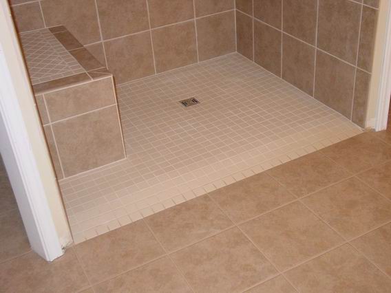

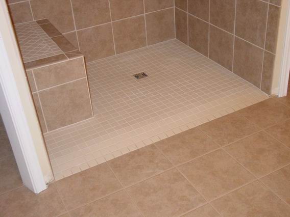

We are picturing a shower stall where the tile on the floor in the bathroom runs into the shower area with no discernible pan and wonder if that is practical for a remodel with a concrete floor?
We are picturing a shower stall where the tile on the floor in the bathroom runs into the shower ares with no discernible pan and wonder if that is practical for a remodel with a concrete floor?
Yes, that is called a handicapped shower. It involves gluing several pans together, and mudding (portland and sand) the whole bathroom floor. Very expensive.
The type of pan that I'm talking about, will not be seen after it is finished.
Thanks! I’ll be asking about this. I’m ok with a reduced pan as an alternative. 🙂
I don't know what you mean by a reduced pan, but the type of pan that I'm talking about, will not be seen after it is finished.
Is there a discernible edge between the bathroom floor and the base of the shower. Could you possibly locate and post an image link of what you are describing? Thanks!

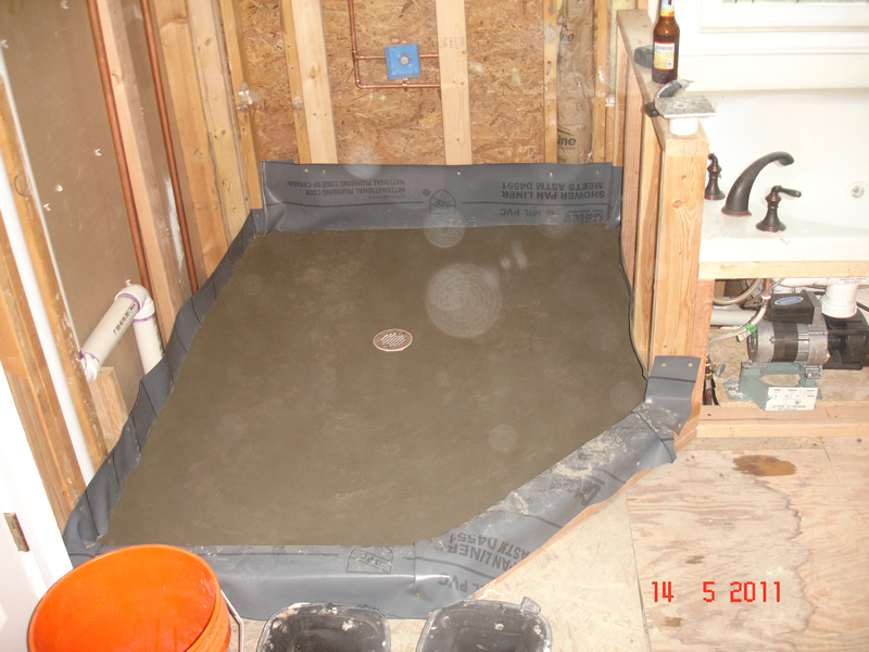

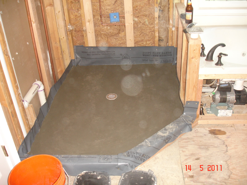

This isn't a handicapped shower, but this is what I'm talking about. Pan with the tapered mud floor.I always install the cement wall board before the mud floor, so It doesn't need nails at the bottom.

If done correctly, this has a pan under it too. This is some ugly tile.
We were at the tile store today and got my wife to move away from the no threshold shower after we talked to a store accociate who worked as a plumber. For the shower walls, we are considering both cultured marble and a porcelain slab. My wife did not like the colors of cultured marble. The porcelain slab is still a possibility but we were told it requires a certified technician to install. Because of this and the floor of the shower, I may sub out the shower to a contractor.
