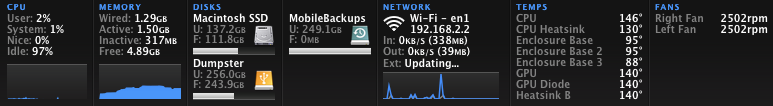

My CPU temps have gone up by at least 50 deg. F after installing the SSD.
It used to be in the high 90's and low 100's (Fahrenheit) and now it's anywhere from 140-170.
I made a thread about it since I couldn't really find any answers but it has not had a lot of traffic so I figured I'd ask here.
So, I'm wondering what other people's CPU temps are and why I am seeing a spike in heat.
The computer does not physically feel hotter than before and the fans do not appear to be working any harder either.
I am getting fan speed and temperature data from iStat Pro.
Also, it has been in for a few days and all major indexing is done it seems and nothing looks out of place in activity monitor.

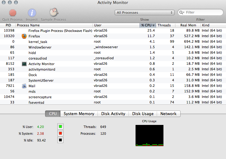

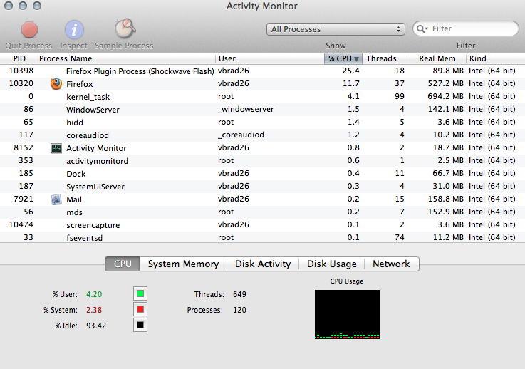

Putting in an SSD should not have any kind of temperature affect like what you describe.
When the temp is that hot, what is the load on the CPU like and using Activity Monitor, which process is using up a lot of CPU?

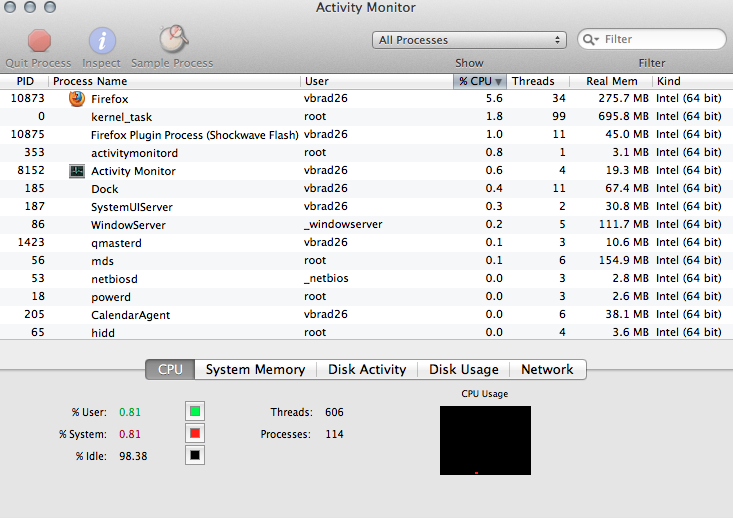

Of course those numbers are always changing but to me nothing seems out of place.
Currently at 160 deg. F and fan speed around 3500rpm
(took this a few min. after the first pic.)
Well the Flash pluigin for Firefox seems to be running at 25%. Have you tried updating or uninstalling the plugin to see if your temps go down as well as CPU cycles?
