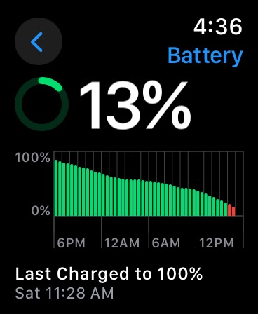

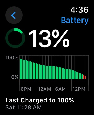

I don’t normally charge to 100% but it’s been a few weeks so I decided to give it a go to see if anything’s changed. After 48hrs my watch was down to 6%. 100% health, AOD on, all notifications mirror iPhone, workouts included a 60min outdoor cycle, 60min pickleball, and 30min functional training, two nights of sleep tracking. I honestly can’t remember exactly how long it lasted prior to os10. It’s def better since I unpaired/repaired. The only difference is I still didn’t add the weather temp complication back on. And In case someone doesn’t know….it will still track sleep if you’re below 30% and get the charge notification. I went to bed with 20%, woke up with 10% and it tracked my sleep.
I can confirm this did nothing. I reset privacy and location yesterday. Took my watch off the charger at 10:27 pm at 100% and went into sleep focus from 10:30 pm to 6 am. Woke up at 90%. I’m roughly 19 hours in now and am at 59%. Prior to OS10 I would have been around 75-ish.
