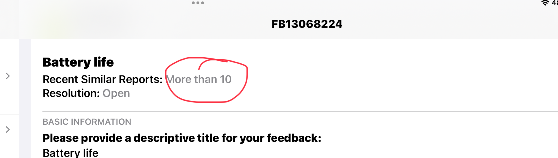

people should be reporting this as a bug and using feedback

As for not being aware of problems.
Per Apple:
Power​
Resolved Issues​
  • Fixed: Increased power consumption might occur when an Apple watch running watchOS10.1 is paired with an iPhone with iOS 17.0 (or watchOS10.0 is paired with iOS17.1). (116348186)
