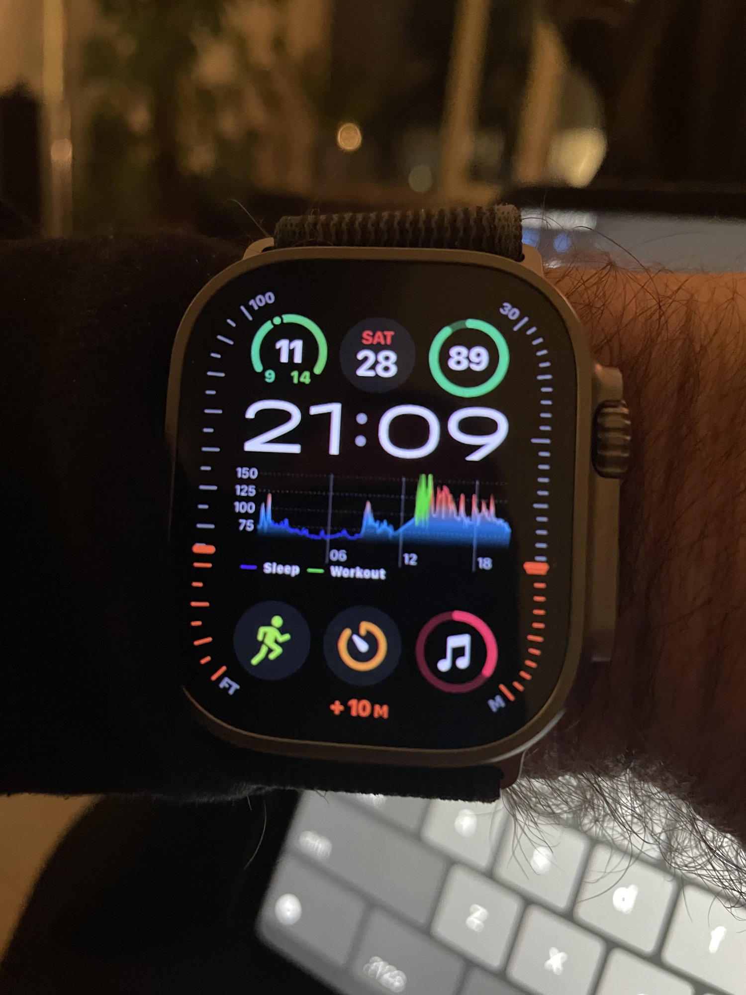

Modular Ultra, only things I have changed is that I turned off the daylight sensor - I’m outside all the time, I don’t need the watch to tell me that. And I disabled ‘show now playing’ on the watch. Have complications for temperture, calendar, battery, workout, timer and music. Middle complication is heart rate from Athlytic. Display brightness is set to middle. I put it on the charger after 62 hours, still had 24% battery left.

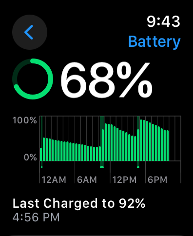

I unpaired and setup as a new Watch on Friday or Saturday running 10.1.
This seems a bit steep to drop from 92% to 68% in just under 5 hours, with no workouts or cellular-only time or any media or calls.
Do these energy curves seem unusually steep to anyone else?
That curves look like mine - and I am unhappy, too. That's the reason why I wait on 10.0.1 (AW5) and fear, that newer versions are worse.
