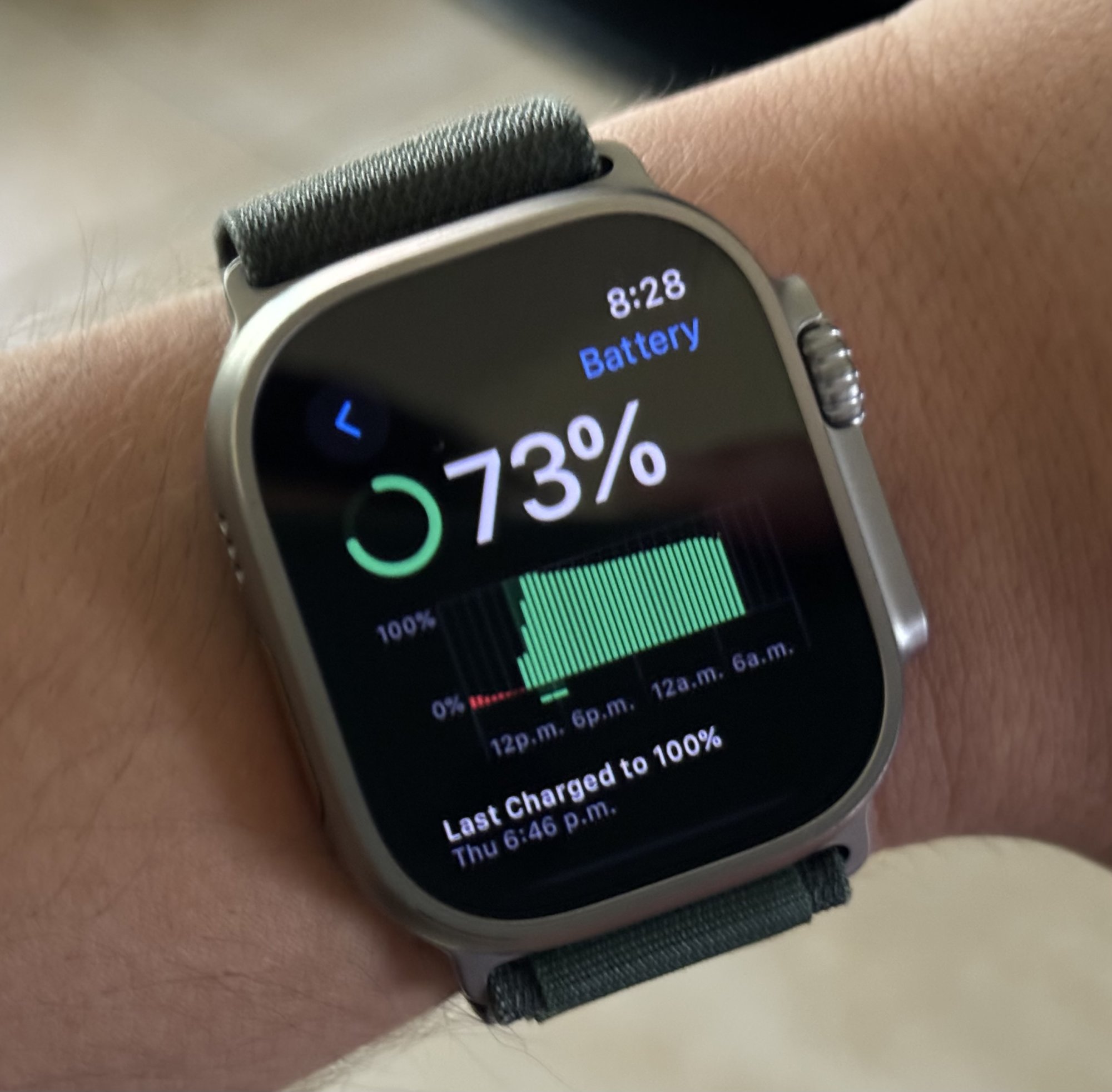

Mine is not extreme as what others are reporting here, but definitely not great. Down to 73% in a little less than 14 hours is not great, especially considering that I was asleep during 7 of those 14 hours with sleep focus on. Still guess I should not complain seeing how other are doing.
