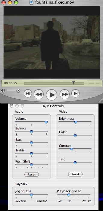

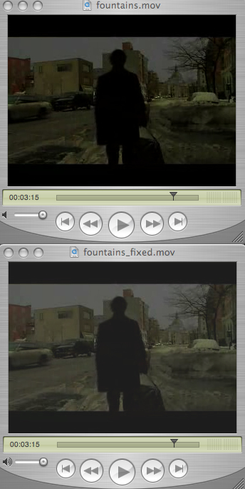

I did a little work just to test the theories:
This is the Fountains of Wayne Video from http://www.youtube.com/watch?v=LuBoAPFRlDA that someone mentioned from another thread. I remember reading that they said to look at the last 30 seconds or so to see if you have the negative blacks problem.
I encoded the video for the ipod here: http://www.the159.com/macrumors/fountains.mov
Then I applied these settings:
and re-encoded the video here:http://www.the159.com/macrumors/fountains_fixed.mov
Unfortunately I don't own an iPod Touch....so other people will have to validate this and tell me if I did the converting correctly

Although I was skeptical at first, it does seem that screen calibration might be the issue. The built-in contrast setting is so high that it renders deep blacks even deeper than they should display - the 'washed out' image on my Macbook appears more or less accurate on my touch.

No, on the touch they appear normal, even though they're washed out on your PC. The device's display calibration must be way, way off.
