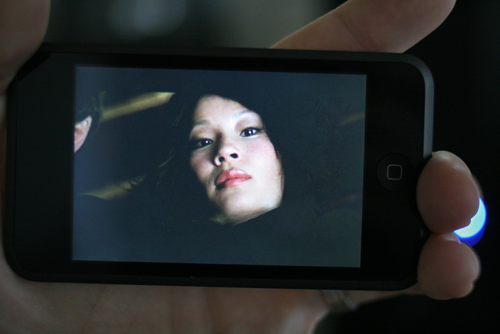

Registered quicktime and as indicated, lowered Gamma of one of my movies by 1/5 and saved it in Quicktime Pro.
Here's a picture (taken with Canon 20D and just resized) of the original;
And here's the 'fixed' one.
I can see negative black on both pics, sigh

My test shots would seem to disagree with you (and yes it was contrast slider I adjusted, sorry for wrong verbage earlier), but maybe you could actually post some of your own from the device demonstrating what I've done "wrong".
a gamma and contrast problem?
try to see if you can adjust your computer LCD's contrast and gamma setting to get negative black.

What did you do to get it to look right? Did you just shift the angle, or actually edit the image of JayZ?
I actually edited the original image and took the pic from the same dead-on viewing angle. It's not that difficult... as many others have stated, it's all about altering the "dark levels" of the image. The touch has a problem displaying absolute blacks. It really seems as though the manufactured display settings for this screen is just off and needs a software fix...
THANK YOU!!! That's what I was hoping someone with a touch would do...
Now- in the adjusted image, how dark are the blacks? Are they reasonably black to you, or are they grey? And there is absolutely no hint of wash out or negative blacks, when viewing directly straight on, right?
It sounds like you are happy with the results, but I just wanted to double-check to be sure.
