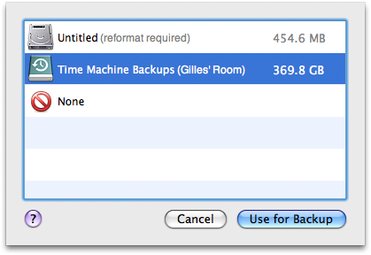

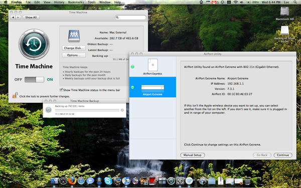

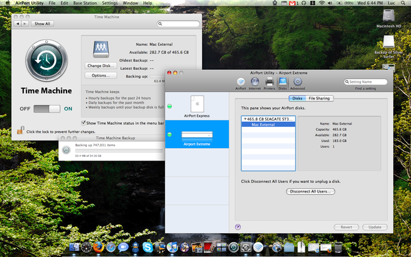

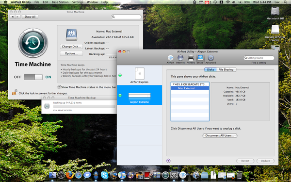

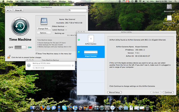

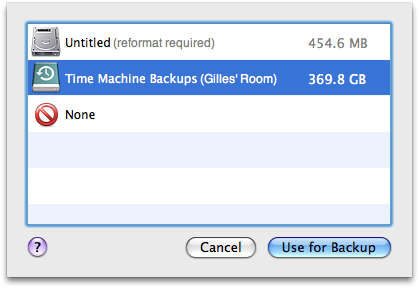

Ready, set, explain! People (not including myself as I don't have an AEBS) are drooling for this feature. Is it officially working? Can you post screenshots if it is? 😱
It's backing up at the moment. Here are some screenshots for proof. Sorry for the small size.

I did have it setup prior, yes. I have that same setup (Extreme-Lacie). As seen in my screenshot above though, that same drive shows up twice, one being supposedly Unformatted.
I just mounted the drive as an Airdisk, put in the password to do that, waited a minute and Time Machine found it and just started doing its thing.
